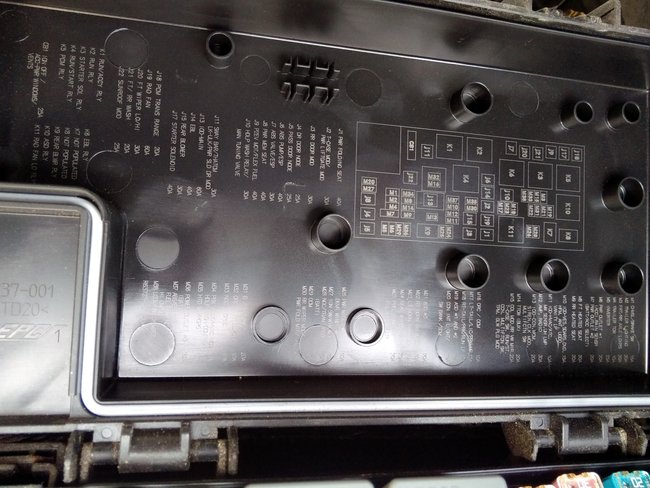

Hello, I am having a problem with my AC system. My compressor is not engaging. I think the refrigerant level is low. I wanted to see if I could turn the compressor on by bridiging a wire.on the fuse panel.
The owners manual is not clear. Would you tell me the location of the AC compressor relay in thr fuse block? And what ports to insert the wire to turn it on?

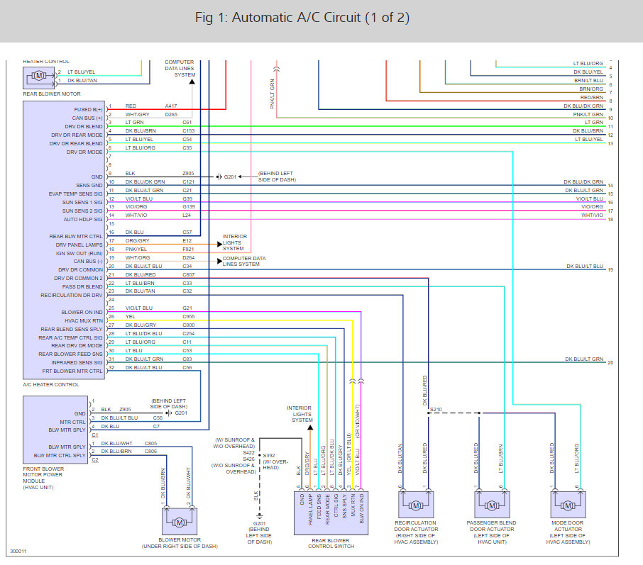

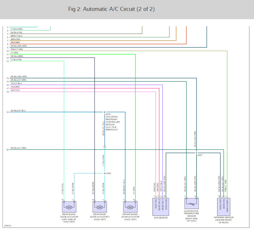

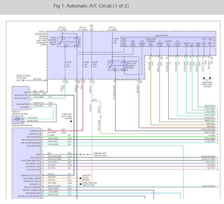

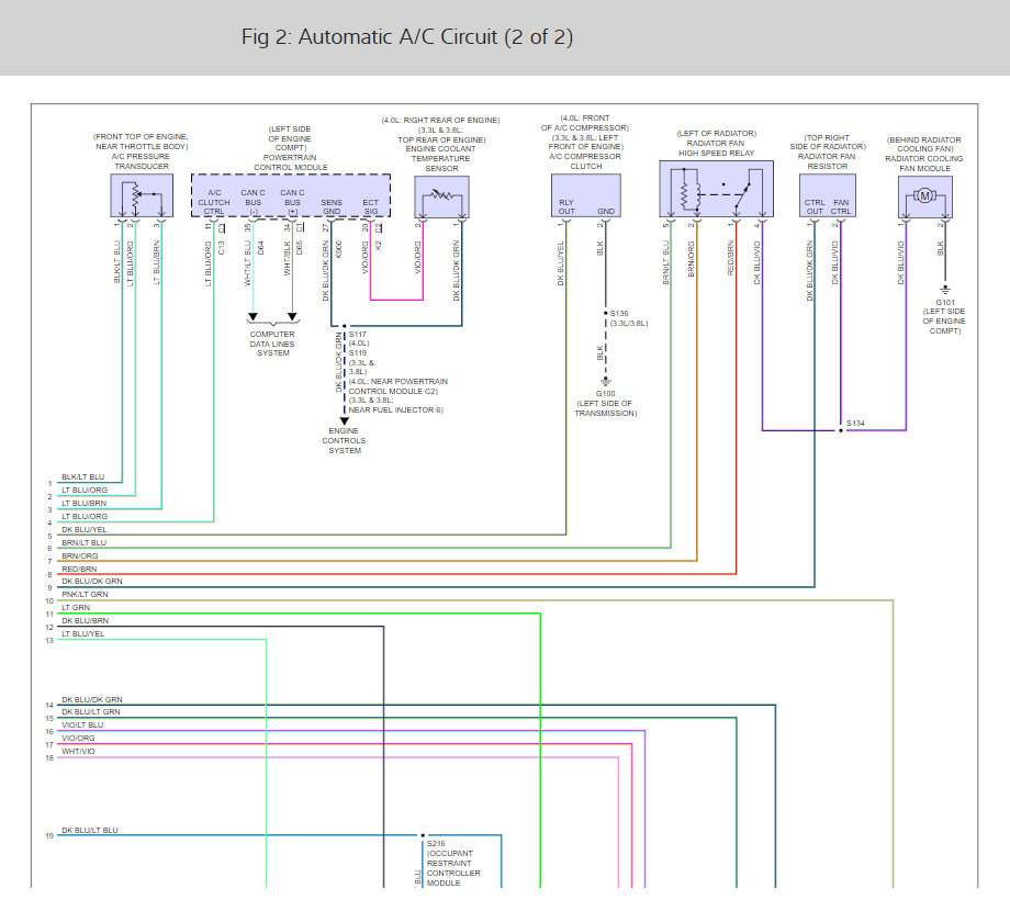

There is no compressor relay it is controlled by the TIPM here is a wiring diagram to help you see how the system works. Check out the diagrams (Below) so you can see how the system works. Please let us know what you find.

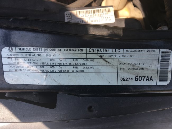

Yes it is a 2009 Dodge Grand Caravan 3.3L SE. I have attached a picture of the owners manual. The VIN number is 2D8HN44E29R650812 if this helps.

Okay, it is under Town and Country.
There is no relay, the PCM controls the operation of the clutch.
Chrysler 2008 to 2009 mini vans, the power-train control module controls the compressor clutch electrical circuit.

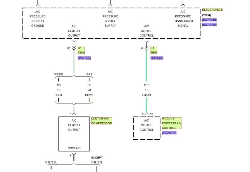

Hello Roy. My understanding is the PCM is sends a signal to TIPM to activate the AC compressor clutch. Which relay in the TIPM would control the clutch?
May 5, 2018 at 3:37 PM
Okay, there is no relay for the compressor clutch, it is solid state. The PCM sends a signal to the TIPM and then off to the compressor. It is based on the input from the pressure sensors and the TIPM look at the wiring diagrams above to see for yourself! The system has pressure switches to prevent the compressor from being damaged by running low on charge...
Diagram attached.

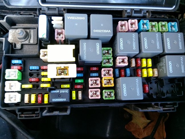

I even replaced the control switch inside and the entire fuse box under the hood, nothing.
