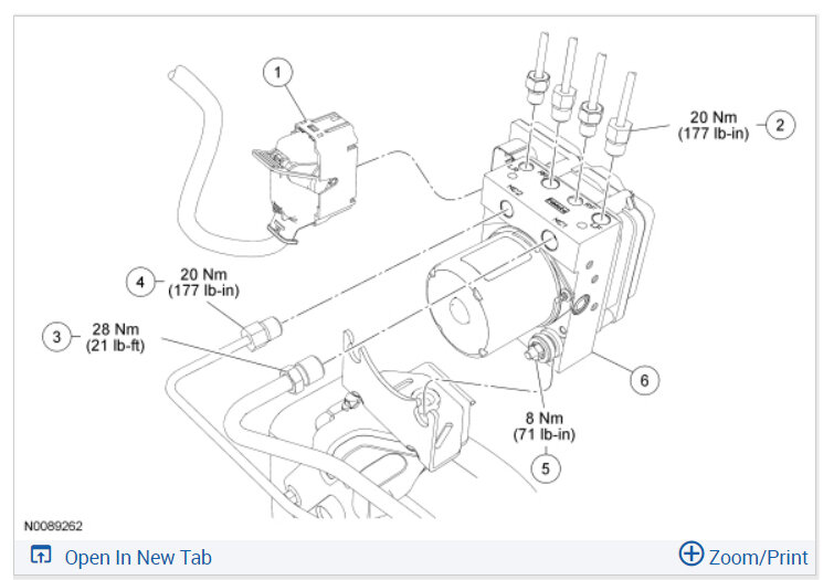

I picked up this truck listed above, and it came with the ABS module but no pump/actuator. I have an ABS pump from another 2009 F150, that I want to use but I do not know the size, thread, pitch, or type of flare that is used for the line connections on the pump. Nor do I know which brake connects to which port on the pump (there are 6 ports on the pump). I have tried to find the info online without success so I am hoping that you guys might be able to help out. If you can tell me which port connects to which brake and which port the master cylinder connects to as well as the thread and pitch size and flare type of each connection, I would be truly grateful. The OEM part number for the pump/control module is 9L34-2C405. I am also aware that I'll probably have to get the ECM re-coded for the new pump. Thanks.

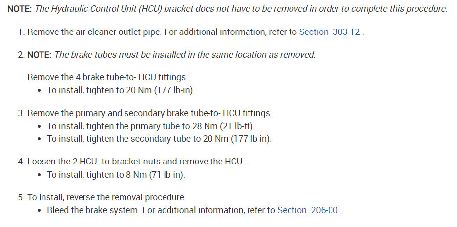

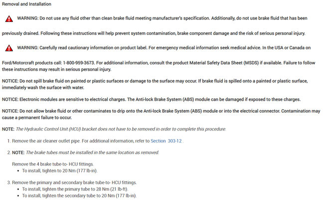

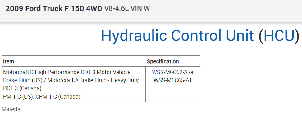

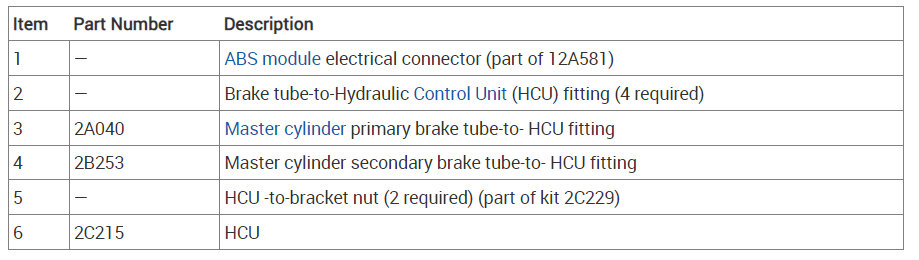

I am a little confused on what you need, we don't have the fitting sizes but here is a diagram to show you how the ABS valve is installed. Check out the images (below). Please upload pictures or videos in your response of any problems so we can see what to help you with.
