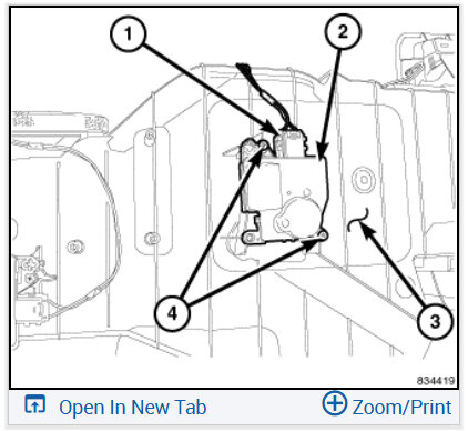

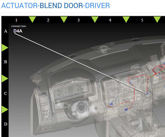

Yep, this happens when the driver side blend door actuator goes out, here is the location and how to replace it. Check out the images (below). Let us know if you need anything else.
