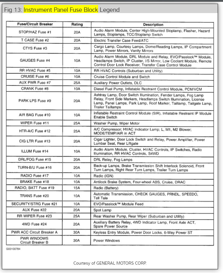

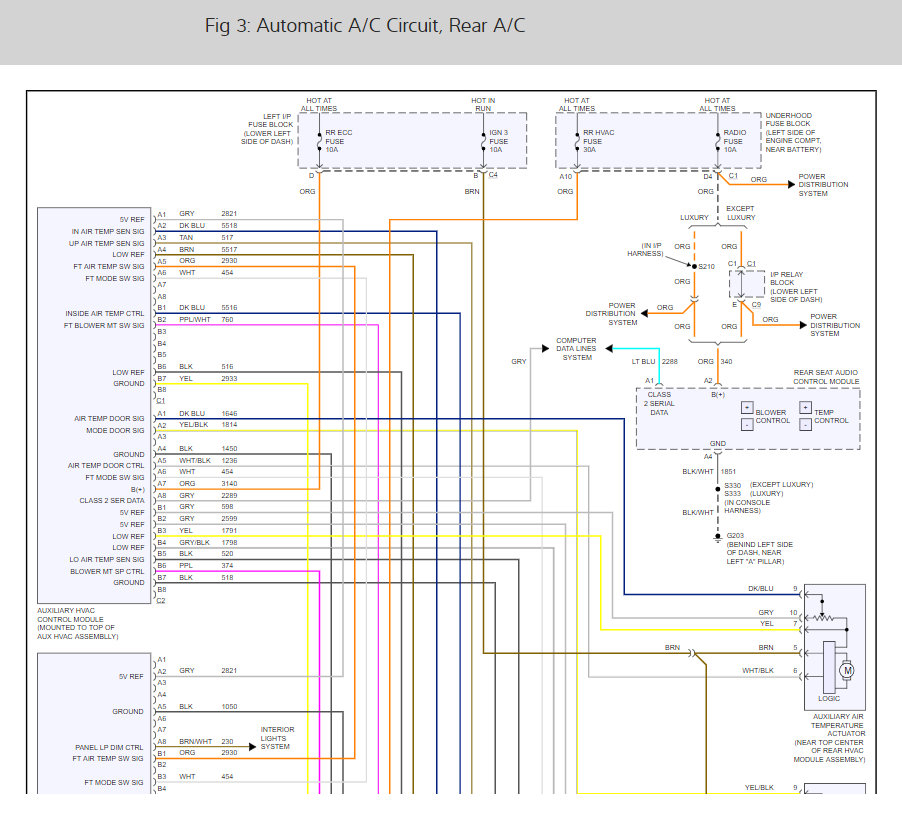

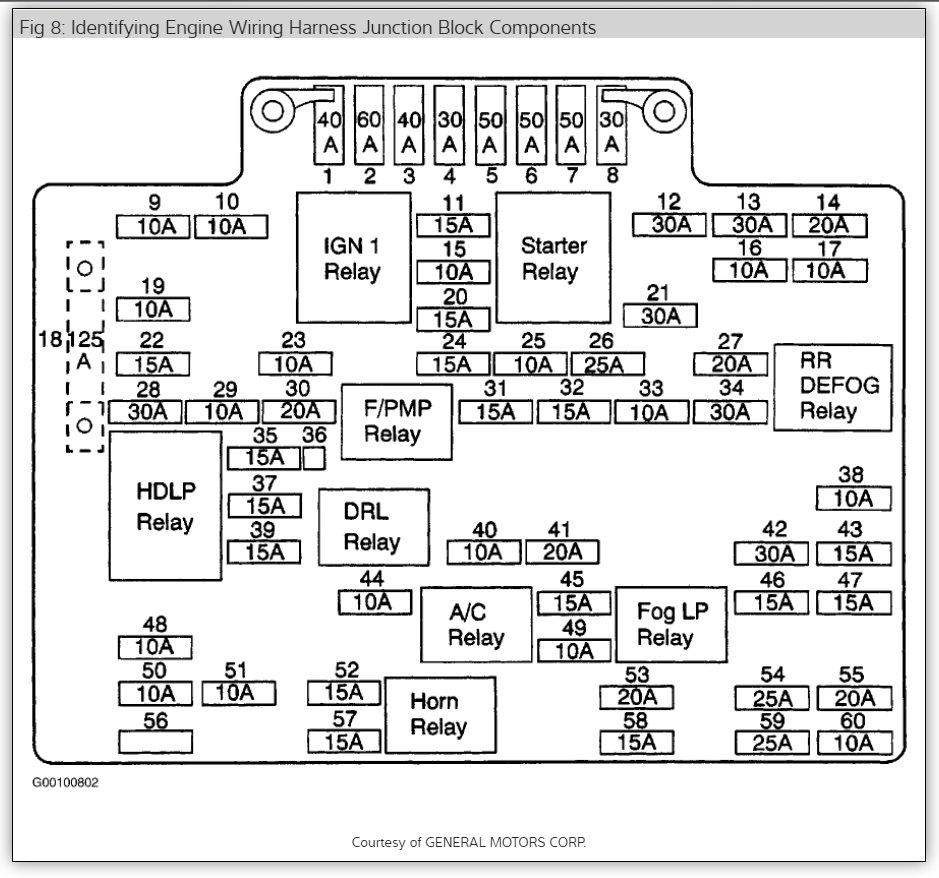

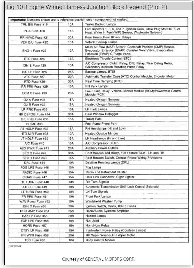

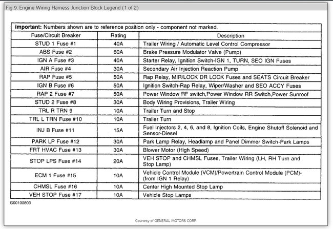

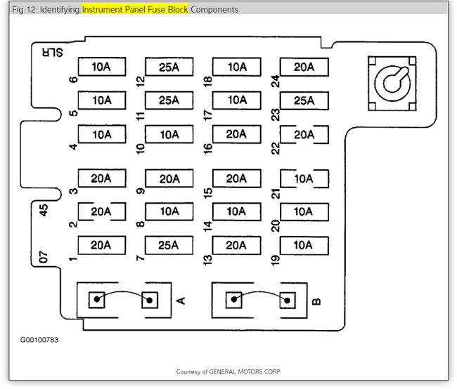

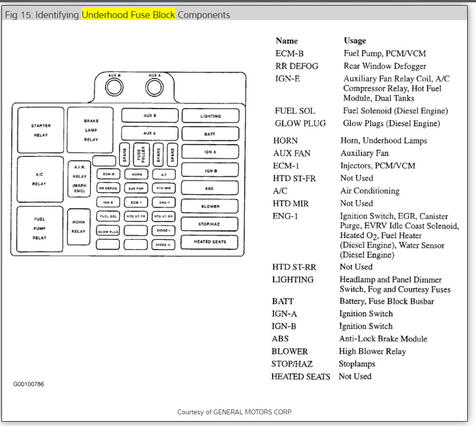

Does the fuse have power this guide will help and there are two other fuses that must be checked as well. Here are the blower motor wiring diagrams so you can see how the system works and which fuses to check also with a guide to help you check for power along with the fuse locations below.
Check out the diagrams (Below). Please let us know what you find. We are interested to see what it is.
Jul 22, 2019 at 3:28 PM
HOT IN PA
MEMBER
2 POSTS
Fixed. It was the 40 amp fuse. Must have blown when the AC went out. Thank you.
Jul 22, 2019 at 3:31 PM
CERTIFIED EXPERT
53,855 POSTS
Nice work, we are here to help, please use 2CarPros anytime.

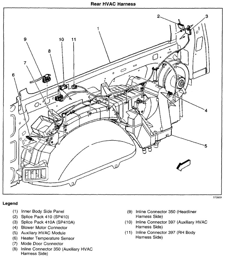

my 2001 tahoe Rear blower not working nothing coming out rear either hot or cold front seems to be working fine checked blower fuses already did heater core flush checked under dash for blend door I am stumped.
Please help winter in coming
Jul 23, 2019 at 1:16 PM
(Merged)
HMAC300
CERTIFIED EXPERT
48,601 POSTS

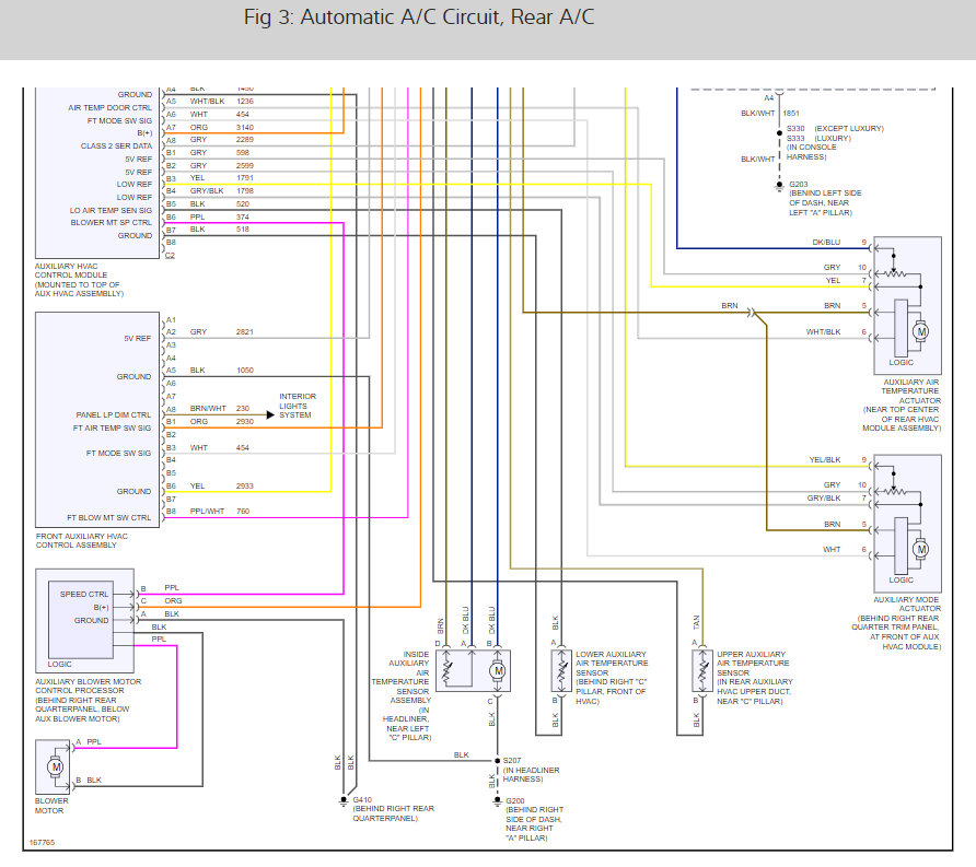

This sounds like the blower motor has failed but to be sure we can check for power and ground back at the blower motor here is a guide and some diagrams below so you can get the problem fixed.
Cheers
