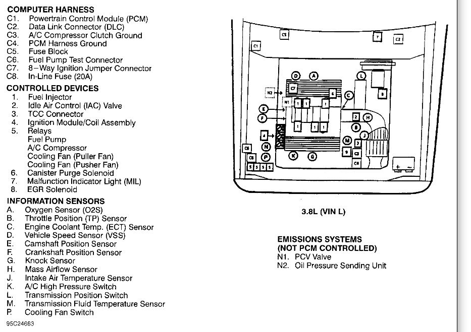

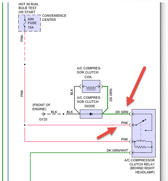

hint if compressor won't start it may be out of Freon, if that is case then there is a leak and should be fixed...... see pic ac compressor relay behind right headlight

it may have a slow leak which is seasonal that is quite common. if not recharged eventually to low for compressor to start. your pic is nonspecific as to which relay is compressor

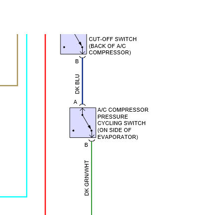

unplug relay if you are going to jump it there. also pic of pressure switch.

o which wires am i jumping? pink to green?
Apr 13, 2016 at 10:17 AM
You will jump the pink to the green
Apr 13, 2016 at 11:25 AM
FIXITMR
  • 9,990 POSTS
yup that makes the compressor run gonna try to test for leaks before attempting to charge its completely empty as far as i can tell.

so i added freon and it lasted the summer! now its hot again this yr and AC not working again! so i'm here to see what i did last time!
Jun 2, 2017 at 2:52 PM
FIXITMR
  • 9,990 POSTS
same deal jumpered relay plug added freon working again
