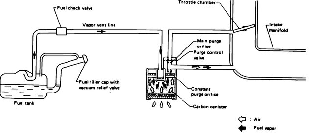

Here is one for you to start with. I am sorting through and I will add more when I find them.
Regards,
Jon

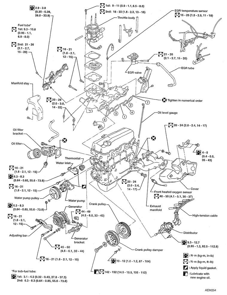

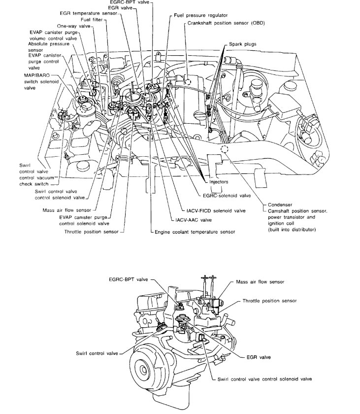

Thank you Ken. I am ordering the injectors all new. Should I do the same with the fuel regulator? JC
Nov 17, 2018 at 1:52 AM
Yes, its a good idea here is the location of the the fuel pressure regulator below. Check out the diagrams (Below). Please let us know what happens.

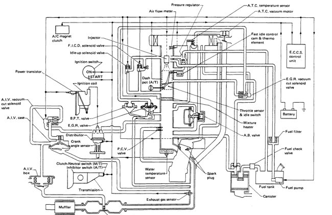

BLUELIGHTNIN6
  • 16,542 POSTS
can you see this OK? if not then give me your email and i will send it to you that way, you can then blow it up on your PC.
https://www.2carpros.com/forum/automotive_pictures/261618_Noname_1205.jpg
I have updated this post you can now see the diagram (BELOW)

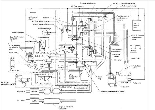

BLUELIGHTNIN6
  • 16,542 POSTS
no problem, i enlarged it the best i can and posted it below. i also emailed you the diagram as well, you can do more to it on your PC than I can here in the forums..

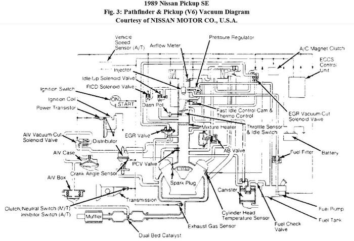

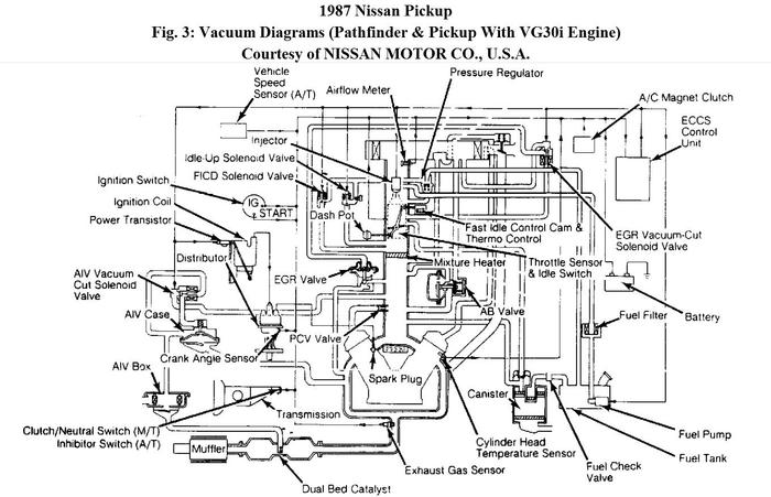

SHIMMAN

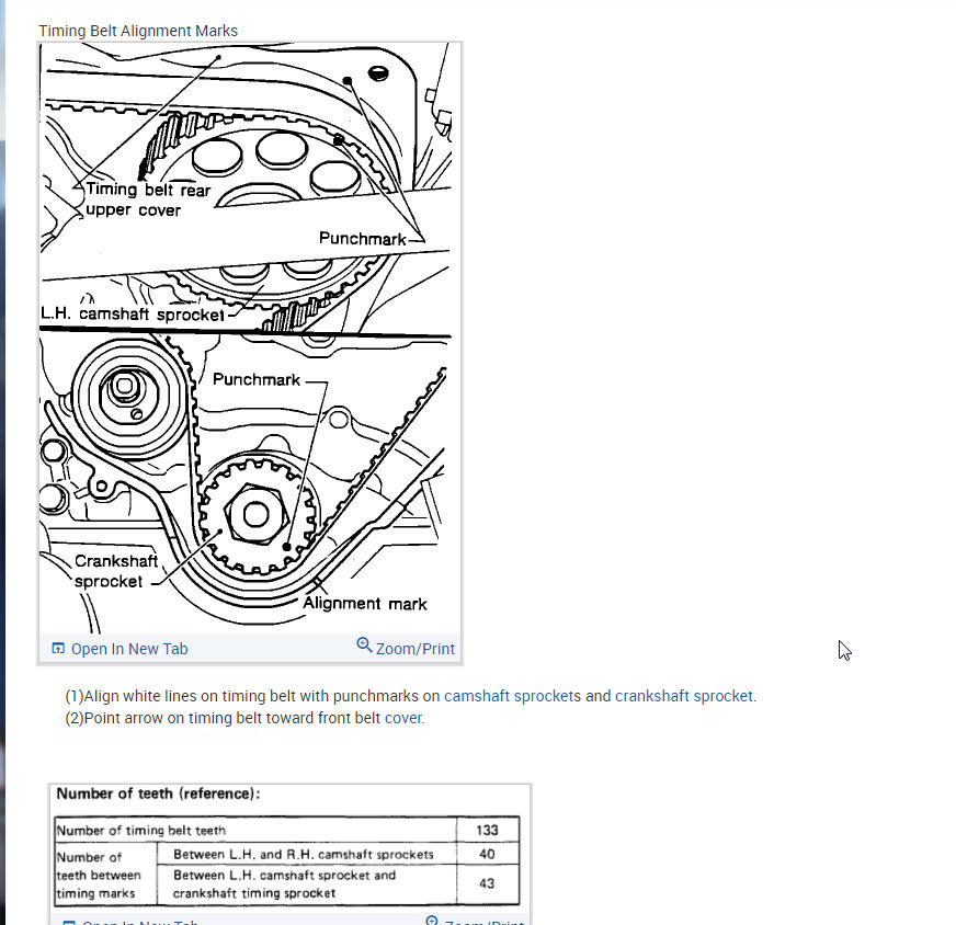

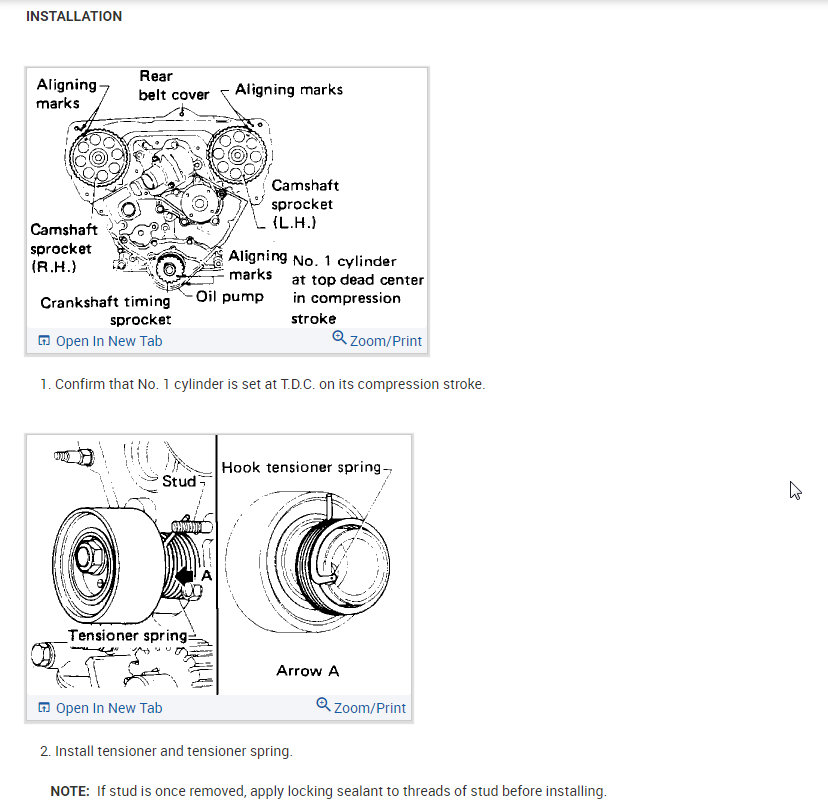

I have a 1989 Nissan pick SE. VG301 motor V6 2WD with 127,000 miles on it. I recently had to change the heads due to a timing issue which froze the valves up and I lost compression. Since the new heads have been on I have got poor poor gas mileage and heavy black soot in tailpipe, so thick its eaten a hole in the pipe. As driving I feel like a backpressure or surge when gas pedal is not depressed. I was unsure of vaccum lines and where to re attach them. Any suggestions as to what is causes the poor gas mileage and can anyone provide me with a detailed diagram of the vaccum system. Mainly the lines that go to the throttle body or intake?
Feb 18, 2021 at 12:18 PM (Merged)
KHLOW2008
  • 41,814 POSTS
Was the timing belt installed correctly?
This is the on;ly vacuum diagram available to me. sorry if it is fuzzy.
RASMATAZ
  • 75,992 POSTS
Its readable-KHLow2008-Could be a valve timing problem as you stated-

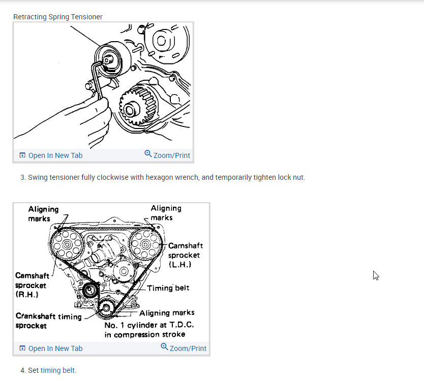

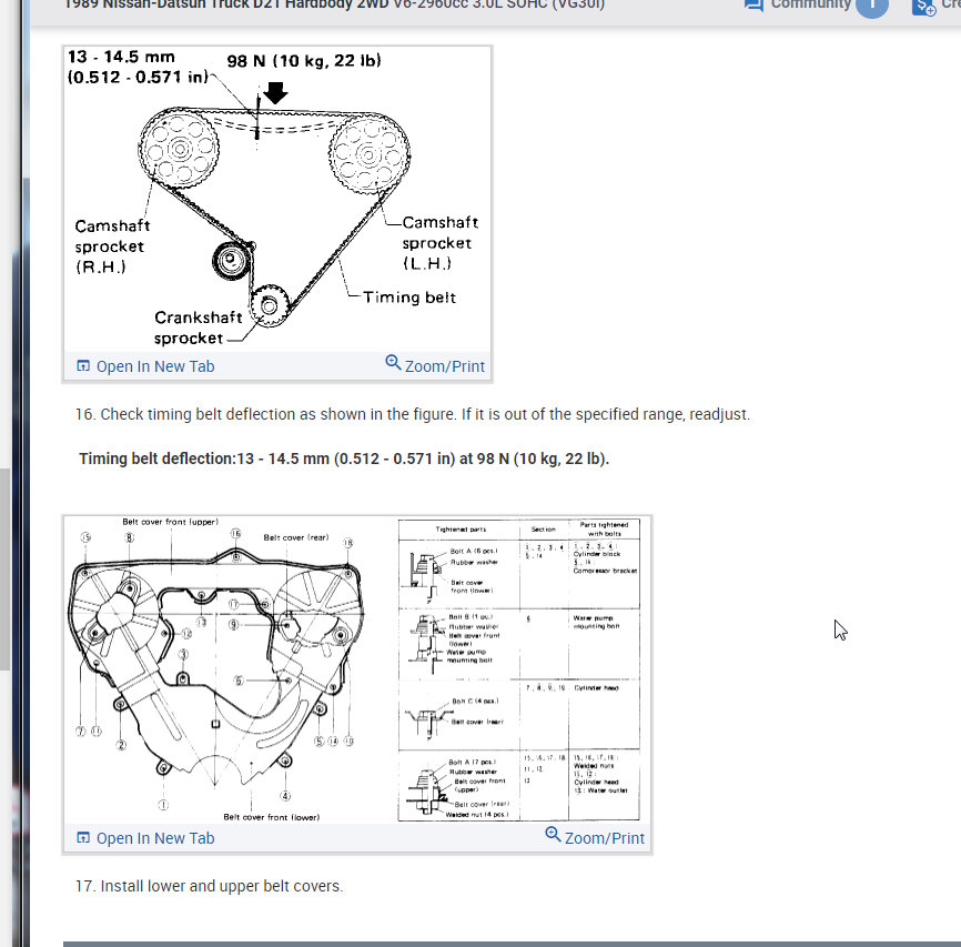

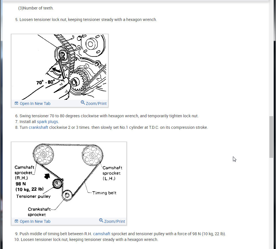

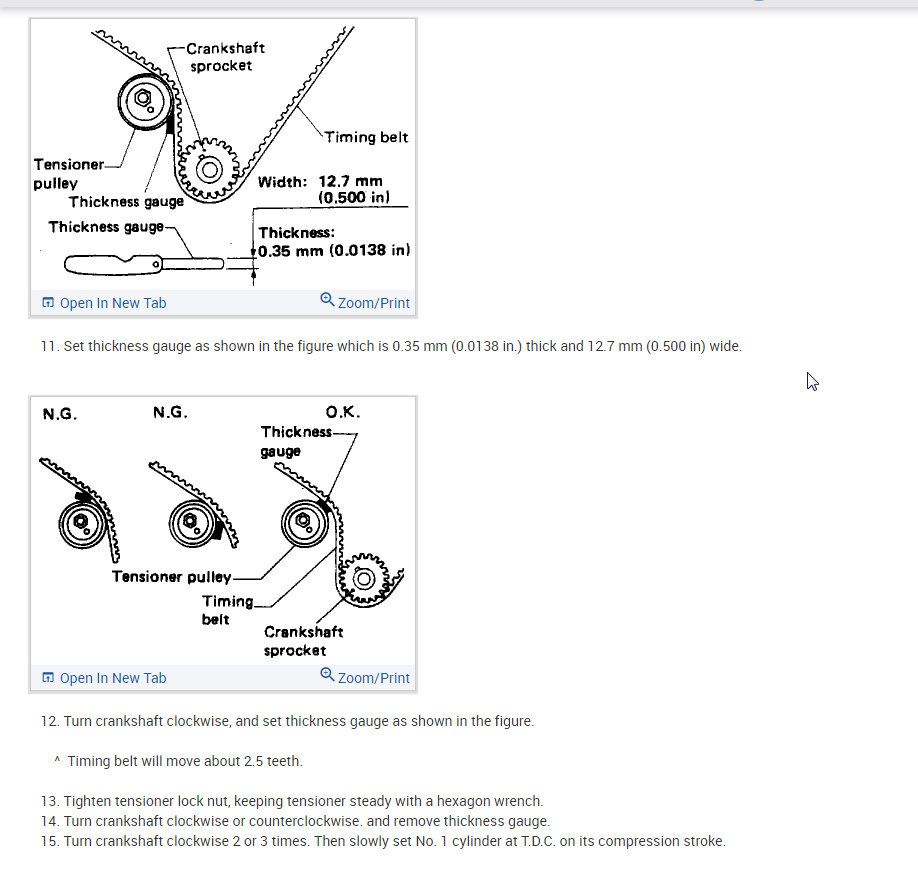

This could be a timing issue as you stated so I attached the process on how to install the timing belt and time the engine.
Also, if this is a vacuum leak issue, then here is a guide that will help with this:
https://youtu.be/4ktw1X4W_-k
Below is the process on how to time the engine. Let us know if you have questions. Thanks

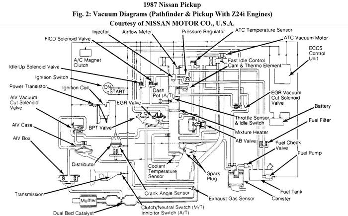

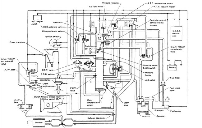

REDNECKMECHANIX
Four cylinder two wheel drive manual 180,000 miles.
please help me. i bought a wonderful little truck to get back and forth to work with. everything on it is great except for the fact that all the vacuum lines have deteriorated or are missing.
does anyone have a vacuum diagram for y lil d21?
it has a 2.4l throttle body injected z24 motor.
Hello, I have found the vacuum diagrams for the engine and EVAp systems I hope this helps. (below)
https://www.2carpros.com/forum/automotive_pictures/12900_z24_1.jpg
(Click the image below) Please let us know if you need anything else to get the problem fixed. Cheers, Ken

REDNECKMECHANIX
lz help me i bo9ut a wonderful little truck to get back and forth to work with and everything on it is great except for the fact that all the vacum lines have deteriorated or are missing does anyone have a vacuum diagram for y lil d21 it has a 2.4l throttle body injected z24 motor someone already posted me a pic of the emissions control system but that is not what i need although i do thank them very much this is a picture of what i dont need i need the diagram that is *****strictly for the vacuum system*** on a 1987 nissan d21 truck with a throttle body injected 2.4L z24 non california emissions motor with a standard transmission
https://www.2carpros.com/forum/automotive_pictures/362013_12900_z24_1_1.jpg
https://www.2carpros.com/forum/automotive_pictures/362013_12900_z24_1_2.jpg
MERLIN2021
  • 17,250 POSTS
It is on a label under the hood when shipped from the factory, this is all that is available to me. for z24i 2.4 engine. Look close, vacuum and electric diagram in one...this is what is suppied by Nissan.
https://www.2carpros.com/forum/automotive_pictures/62217_d21_1.jpg
