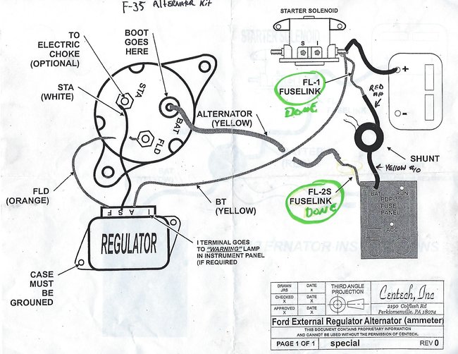

- I have attached a scan of Centech's wiring diagram for the alternator for your reference.

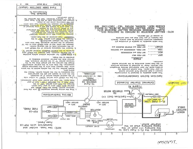

- I have attached Centechs ignition wiring diagram for reference.
- If Centechs wiring diagrams were better integrated between the ignition and alternator systems perhaps it would be easier to troubleshoot.

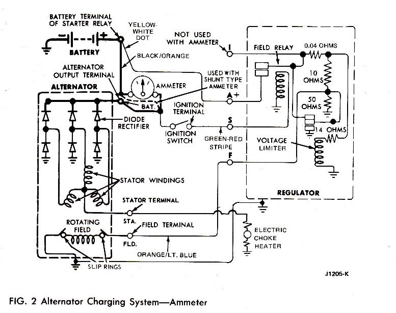

ok thanks but like I said before the amp guage and lite are both wired different on a factory setup so i'm assuming you have a lite to begin with as ford amp gauges were for crap back then

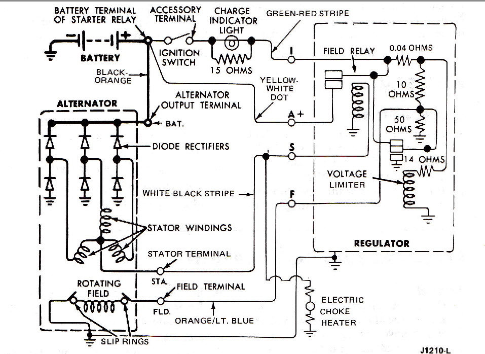

I thought the one diagram I sent to you showed the wire going to the s terminal on voltage regulator. least it's fixed that's the important part.
