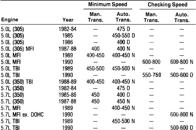

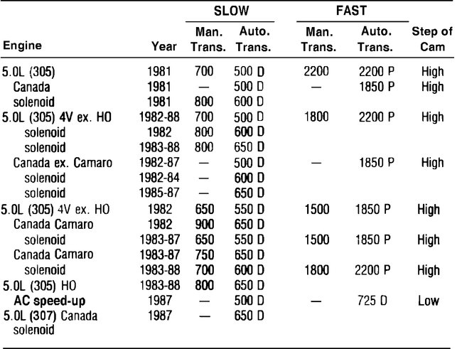

I was waiting and watching for this. LOL Ready for bed here. Anyway, is the engine idle speed when it's in gear and stopped low? I attached two pictures. One indicates idle speed if the engine is fuel injected and 2 shows if it has a carburetor. Take a look at them and see if it falls within the specs. Also, make sure the alternator belt is tight.

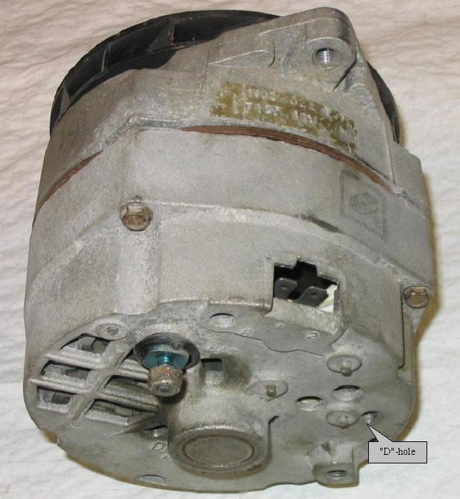

Next, I need to know what type of alternator was replaced because they have different types of voltage regulators. See Picture 3.

I'm not sure what its idling at, it has a 350 sbc in it and the rpm gauge isn't working properly! And the belt is tight it has absolutely no give. The battery stay's at 13v+ until I'm in drive and completely at a stand still, then drops all the way to red line , I can hear and feel the motor gradually slow down. But while in park and with foot off the brakes there is absolutely no problem. It idles fine.

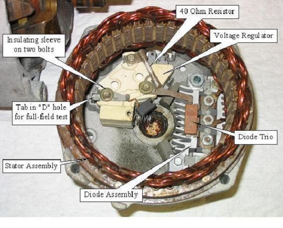

The second common problem that only pertains to GM generators is a defective diode trio. Current flow through the dash warning light gets this system started, then once it's producing current, a tiny sample of that is tapped off and goes through the diode trio. That develops a little current that keeps the electromagnetic field energized until you stop the engine. The voltage it develops has a second function. That is to turn the warning light off. The clue here when one of those three diodes fails, is it only turns the light off two-thirds. The often-overlooked symptom is the warning light is still lit up very dimly. Quite often you can only see it glowing at night.

Are you familiar with the "D"-hole in the rear housing? There's a tab in that hole to ground. You poke in a metal screwdriver, pick, or even a cotter pin, to touch that tab, then move sideways to also touch the housing. That bypasses the voltage regulator and lets the generator run wide open. Remember, all generators are very inefficient at low speeds, so don't raise engine speed to prevent burning open the fuse link wire.
If Joe is right, doing this will bring charging voltage back up You'll also hear the engine load down a little, and the generator may "sing" a little to let you know it's really working.
If the charging voltage doesn't change when grounding the tab, the regulator is already running the generator as hard as it can, then the low voltage is going to be due to failed diodes or a slipping belt.
