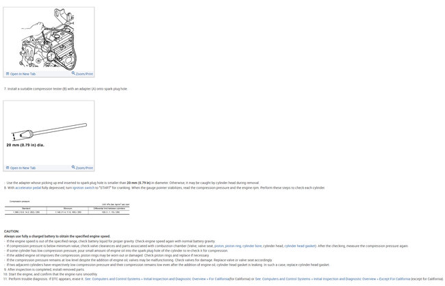

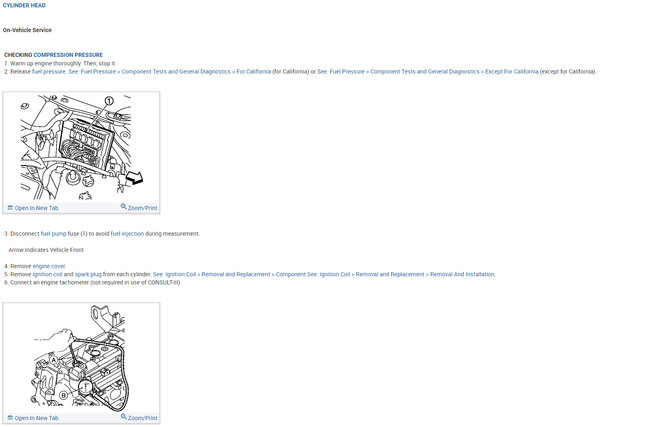

Sounds like yo may have cylinder head gasket leak ? use the following links and diagrams to check for head gasket leak:

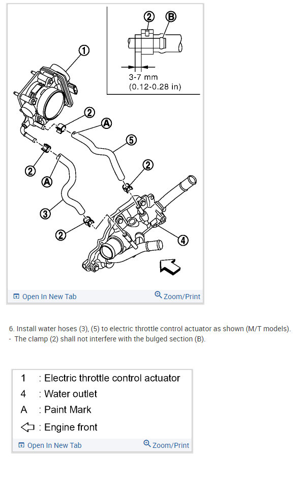

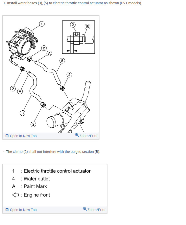

I think you need to check adjoining hose connections and water hoses to electric throttle control actuator. see below diagrams.

My computer seems to be really playing up tonight the diagrams should be below this time.

that is okay no need to be sorry. Not sure what you want me to check for. The small hose that goes to the side of throttle body has coolant run through it. What do you want me to check?

Those hoses and connections from the water outlet are the only thing above the coils and spark plug tubes that could possibly at some stage leaked a little coolant causing the pooling down the tube your referring to are there any signs of coolant leaking at some stage ? as you have already stated if coolant was leaking all the time you would have a loss of pressure and drop in coolant level and eventually overheating so it cannot possibly be still leaking.
