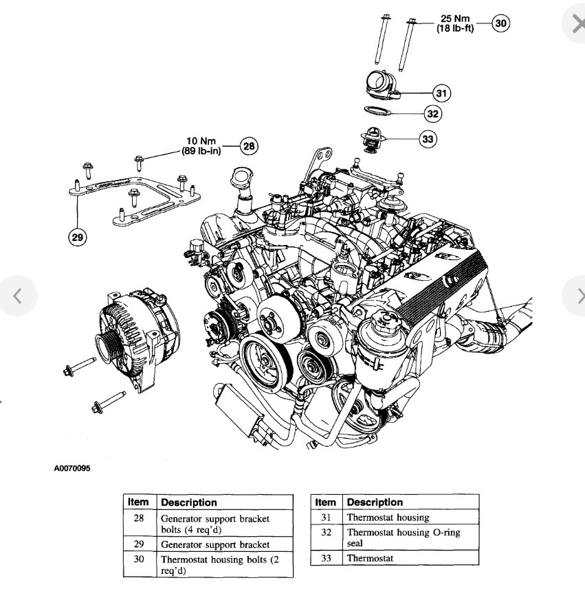

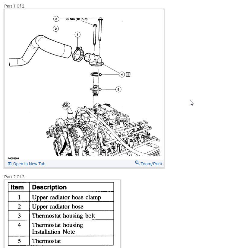

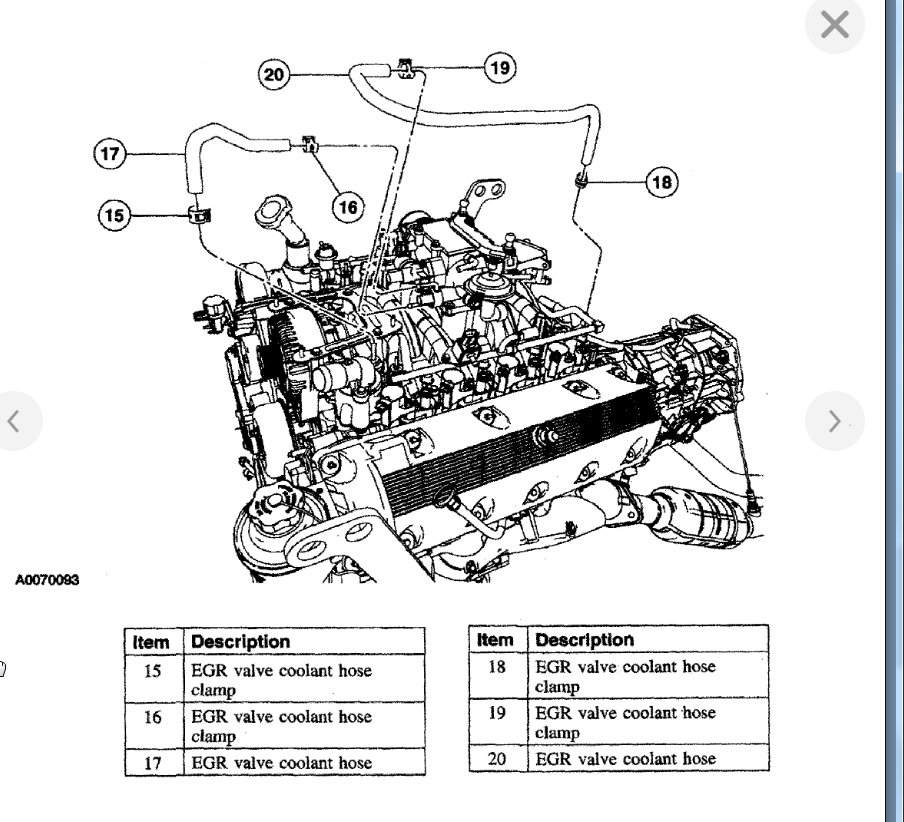

I asked what the part was that the thermostat housing was bolted to, and a mechanic answered it was the water pump. I disagreed and after researching it looks like the crossover. Could this be right?
Oct 28, 2019 at 12:56 PM

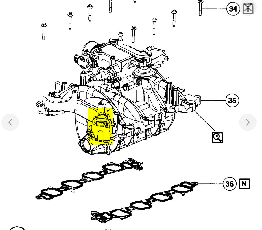

The thermostat housing bolts to the intake manifold. Take a look at the pictures attached for more detail. Let me know if there are more questions. Thanks
Oct 28, 2019 at 6:56 PM
ROBERT LOUDERMILK SR.
  • 12 POSTS
You are right. Thanks. How do I remove it. The bolts are on the bottom side of the manifold. Appreciate your help.
Oct 30, 2019 at 7:04 AM

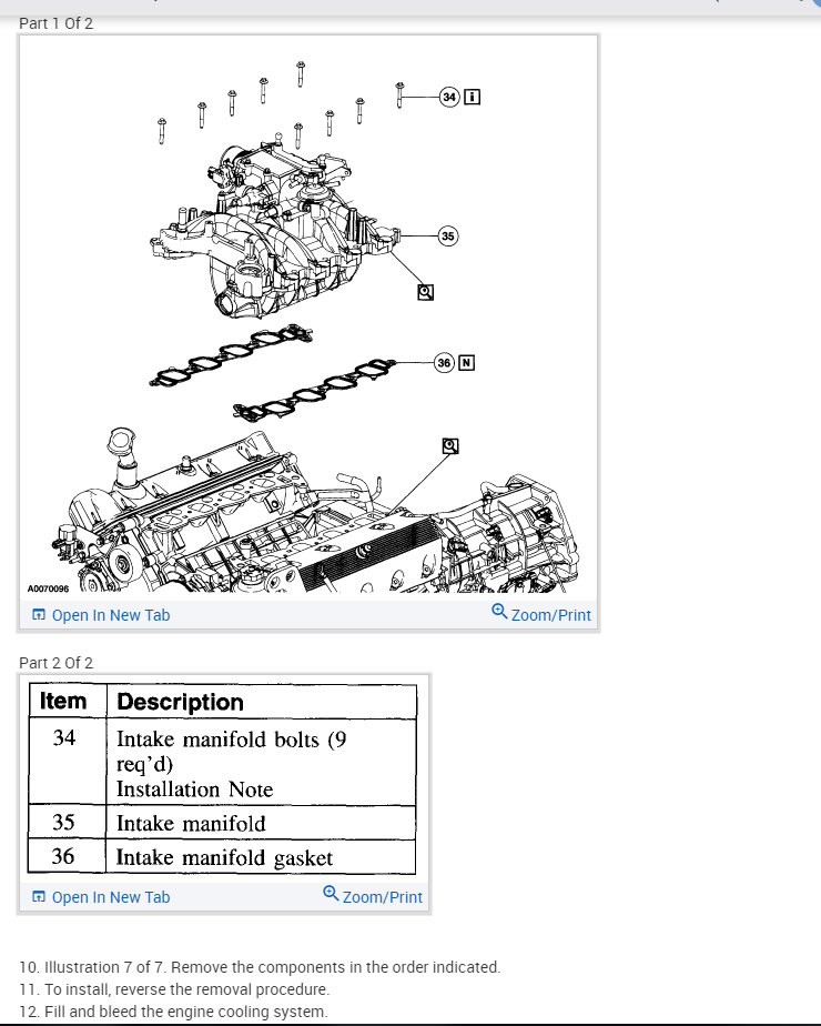

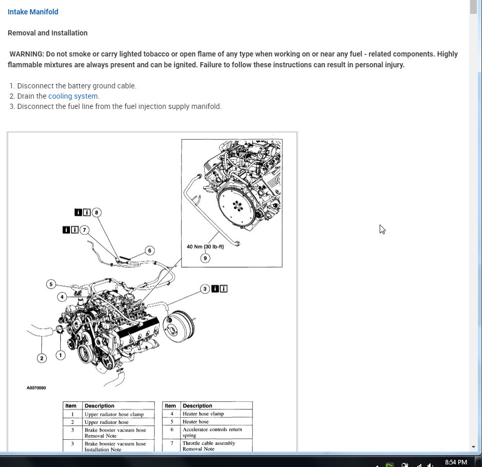

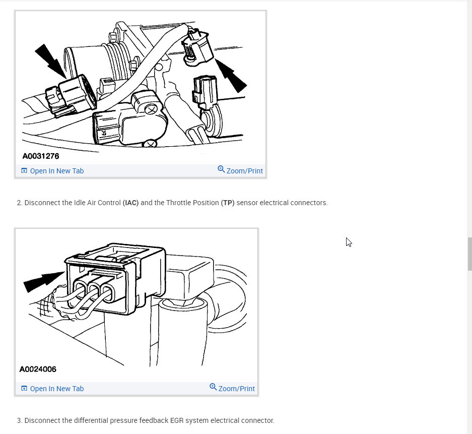

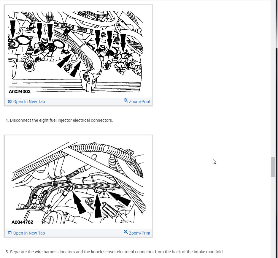

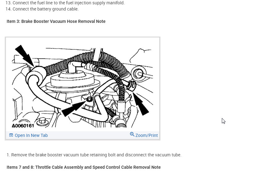

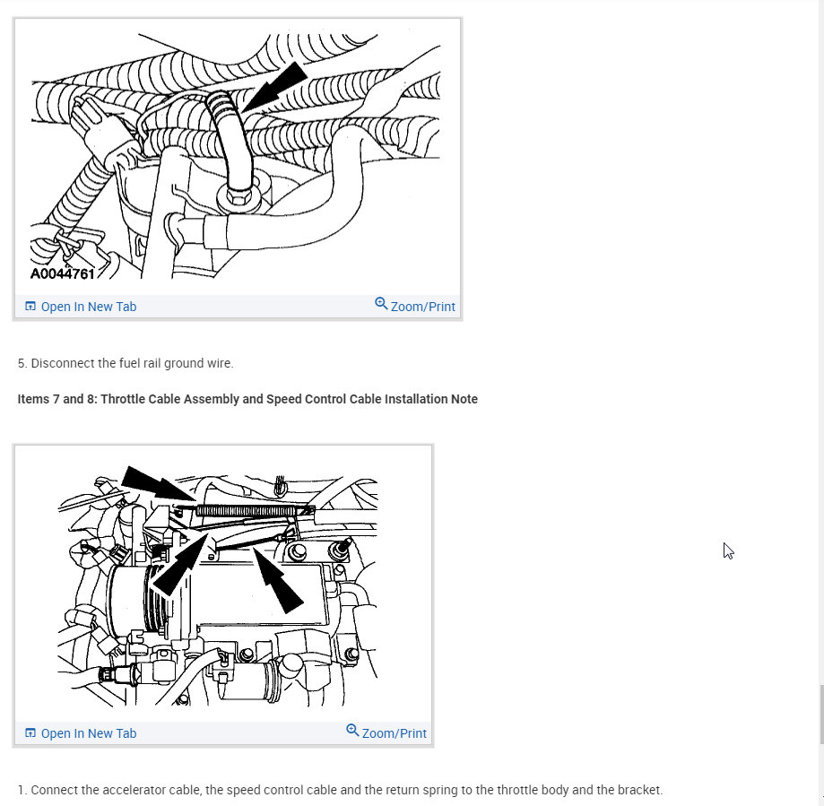

This is part of the manifold and is not removable separate. It is a single molded component.

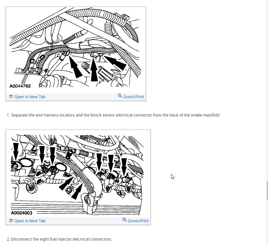

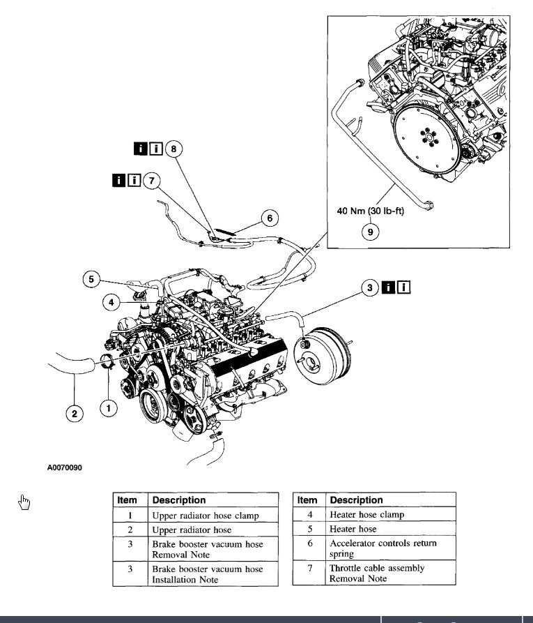

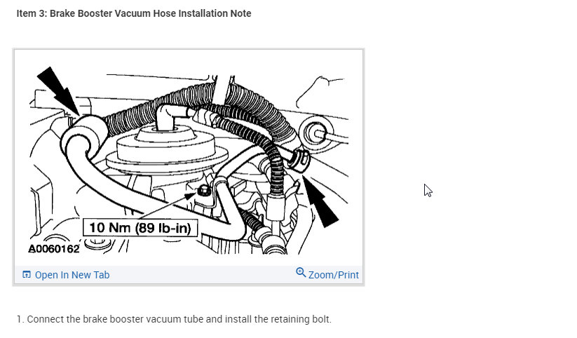

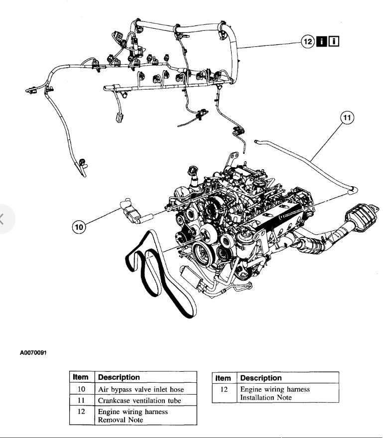

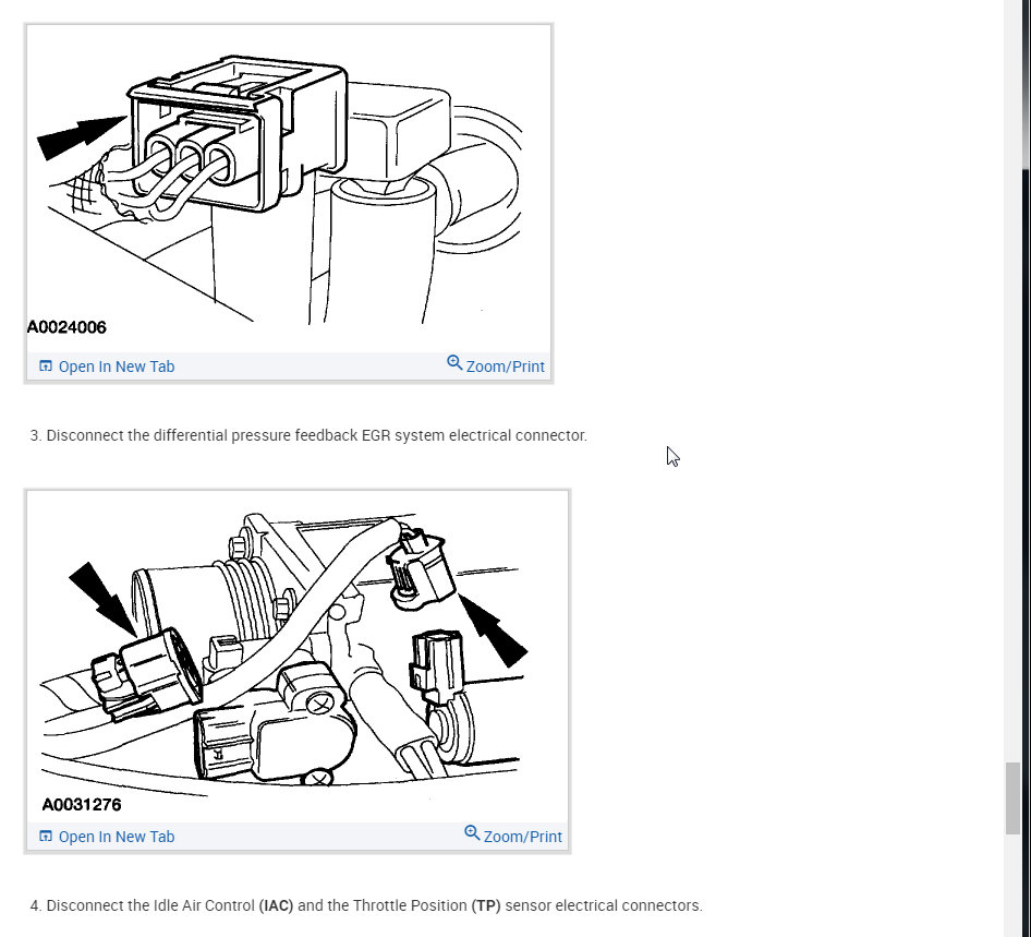

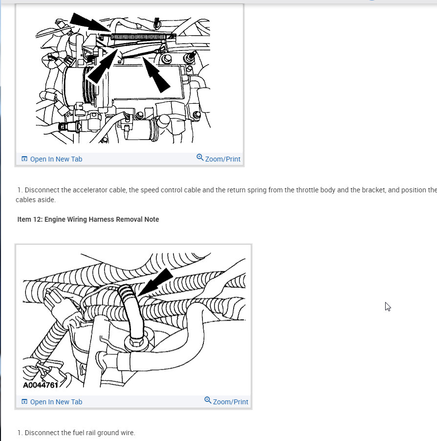

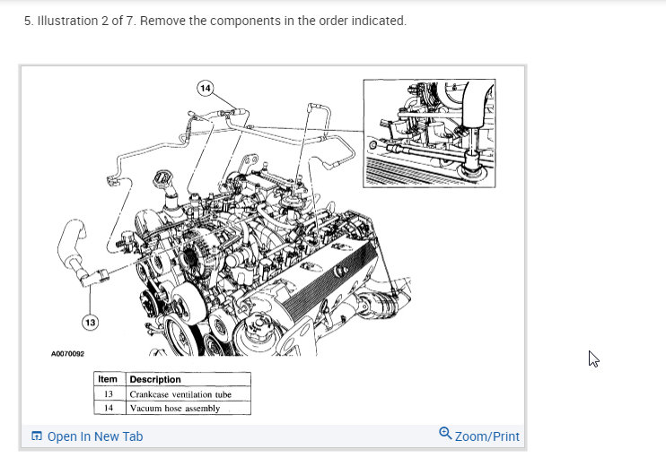

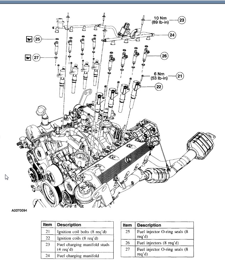

Here are the steps to remove the intake manifold. Let me know if you need more info.
Oct 30, 2019 at 6:11 PM
  • 12 POSTS
Thanks. I watched it on YouTube. The guy had a new intake with built in rubber gaskets. No gasket sealer involved. Looked easier.

Haha. This is a little involved but not a bad job. I would do it but I have a job where I don't have to get my hands dirty anymore and I do this on the side. I like having clean finger nails too much to go back to actually turning wrenches.
Let us know if you need anything else.

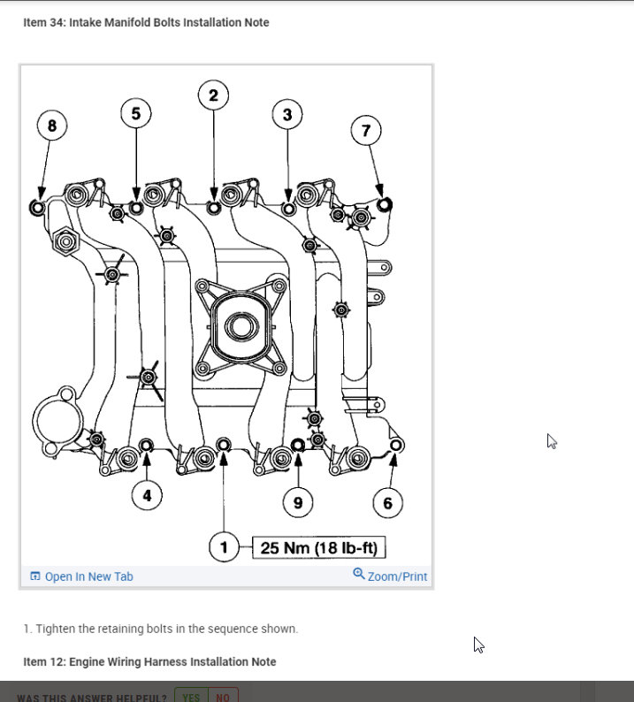

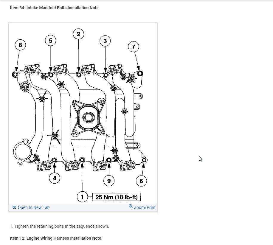

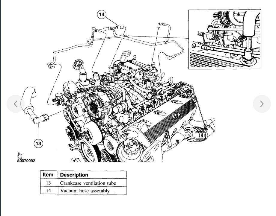

is there a sequence and what is the proper torq of the manifold bolts?
Oct 31, 2019 at 11:53 AM
Yes. The 14th attachment above. I reattached it here.
Oct 31, 2019 at 5:16 PM
