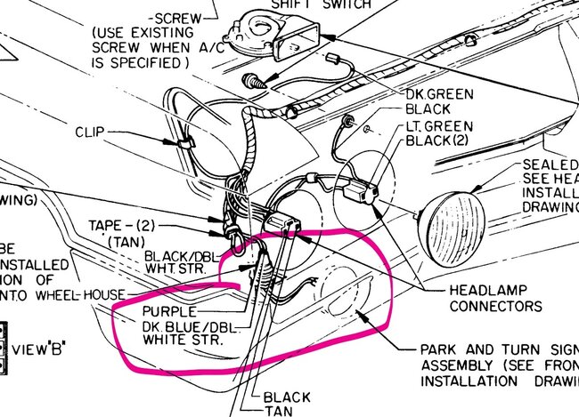

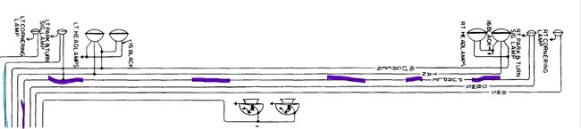

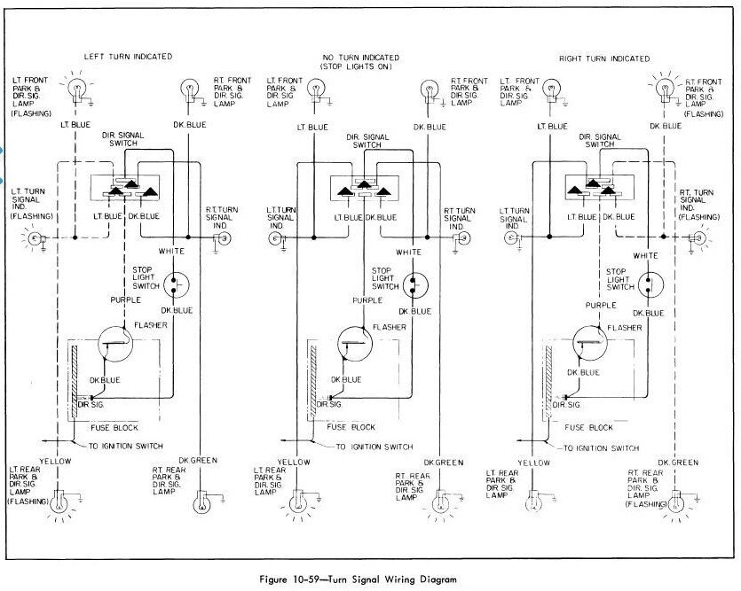

The 64 should have front parking lights that come on with the taillights. The turn signals should be the light blue (left) and dark blue (right) The bulb should be an 1157A (2 filament amber glass. 32 cp turn, 4 cp parking) The parking lamp feed should be a purple wire. The stock unit uses only 2 wires, the bulb ground wasn't wired in it was the shell of the lamp in the metal lamp housing with the ground coming from the lamp housing bolted to the bumper and the bumper bolted to the frame. If someone has changed those out for different holders with 3 wires you need to sort out which one is ground. For that use a test light and turn on the turn signal and probe the wires, the one that flashes is the turn for each side. Now turn on the parking lights and find the park light feed. Now check that the ground is actually connected to a ground. Attached are the OE wiring and routing.
