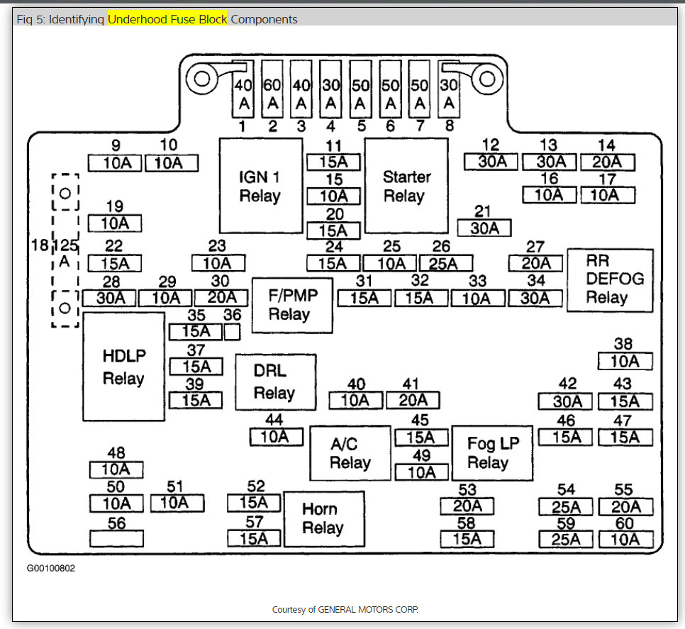

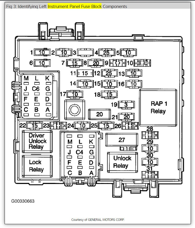

The second is a communication failure which means the CAN is down which can be because one computer is not working because it is out or a fuse is blown, let start with the easier.
Test with the key on. Diagrams (below).
Please let us know what you find.
