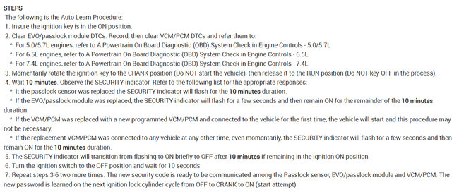

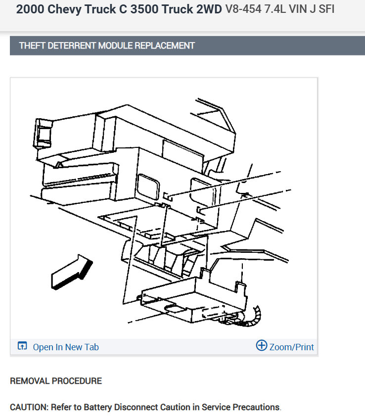

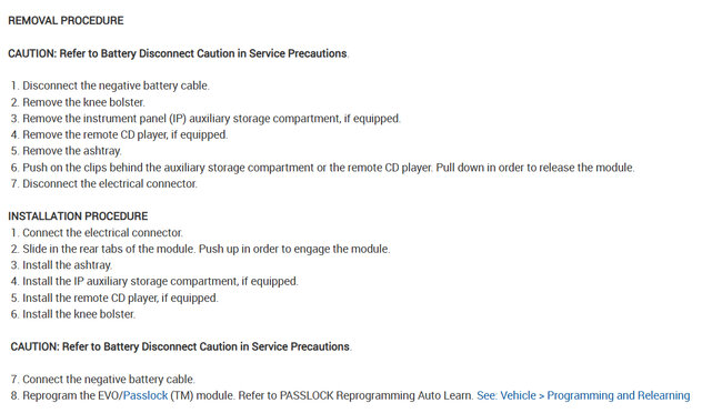

If all fuses are okay, I have seen the pass lock module at the key go bad, here is how to replace it. Also, check the ground for the module which is the blk/wht wire which is at the right top of the cylinder head.

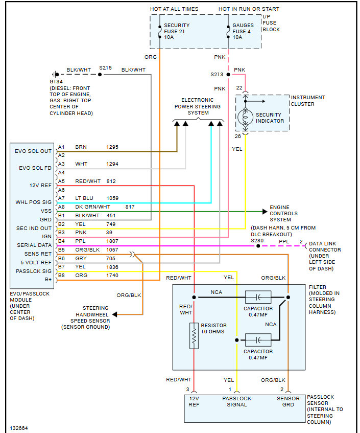

I assume the security light is flashing? If so, you can try swapping the module out. Here are the wiring diagrams for the security system so you can see how it works. Check out the images (below). Let us know how it goes.
