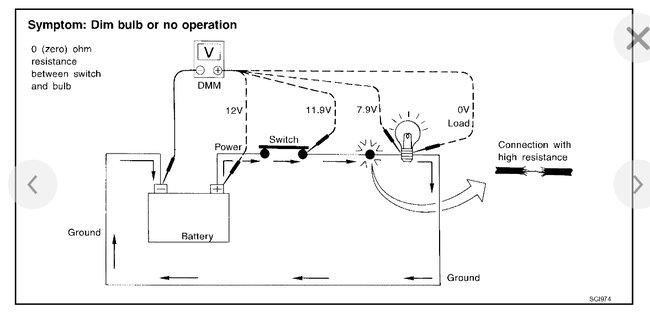

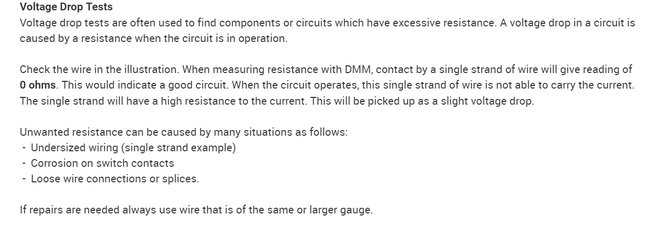

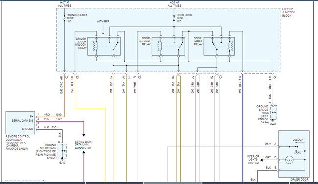

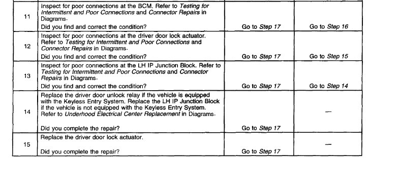

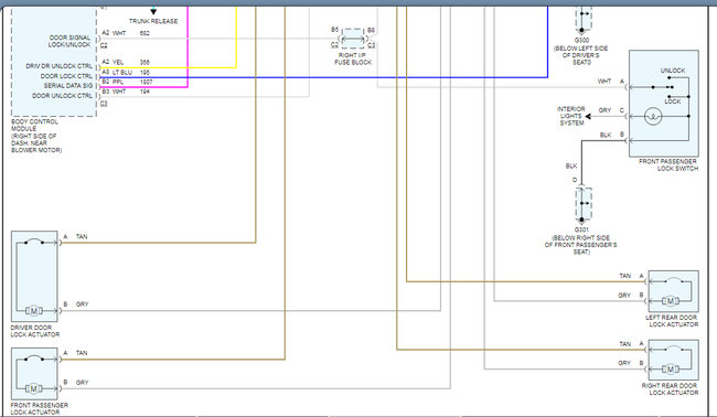

Is your vehicle's Malfunction Indicator Lamp[MIL] or "check engine" light illuminated? For reference, I have included a wiring diagram of your vehicle's Power Locks circuits in the diagrams down below. Please get back to us with the answer to the MIL question and we can go from there.

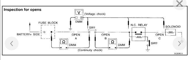

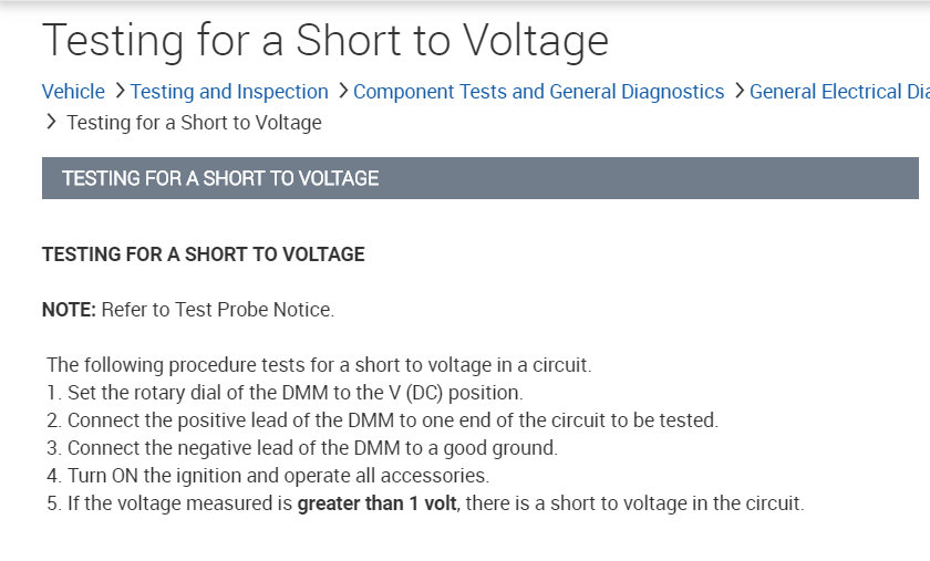

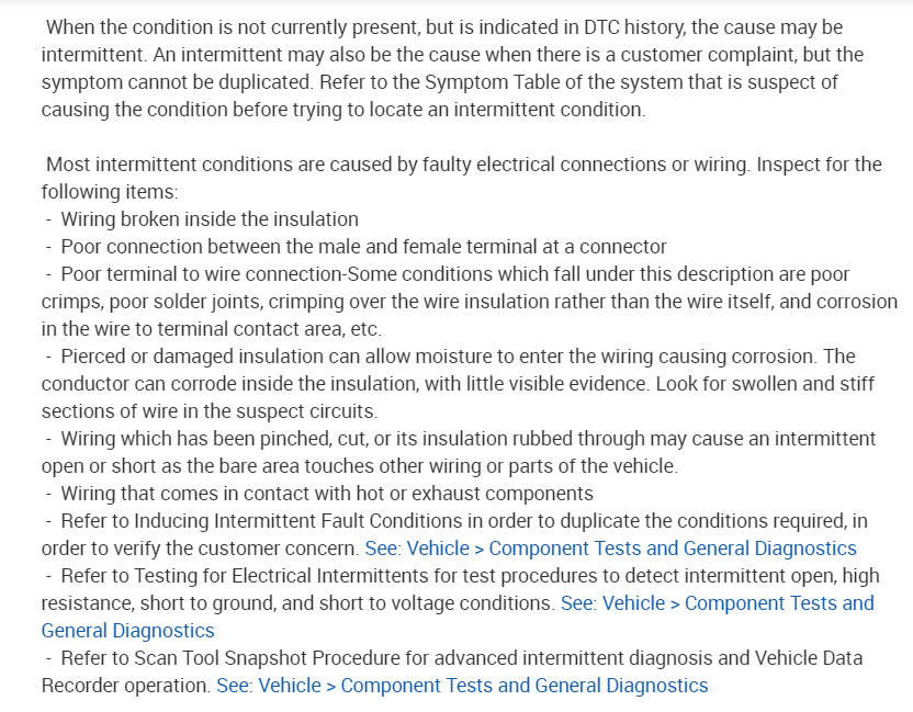

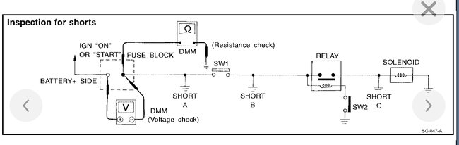

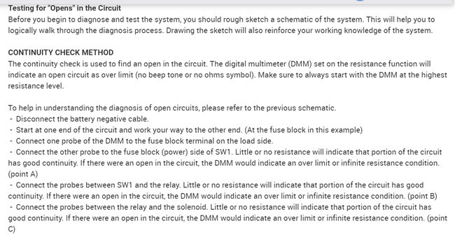

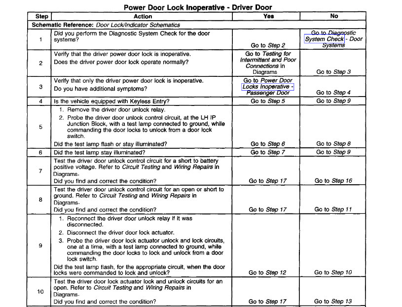

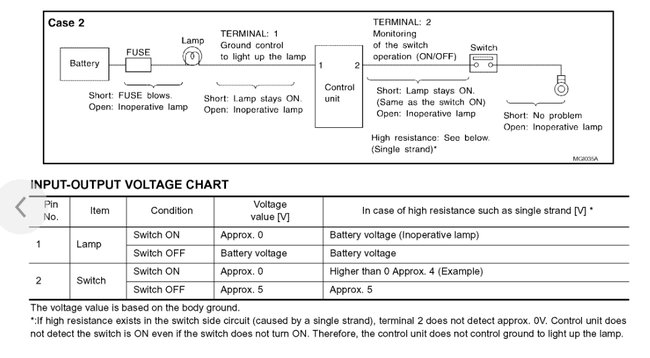

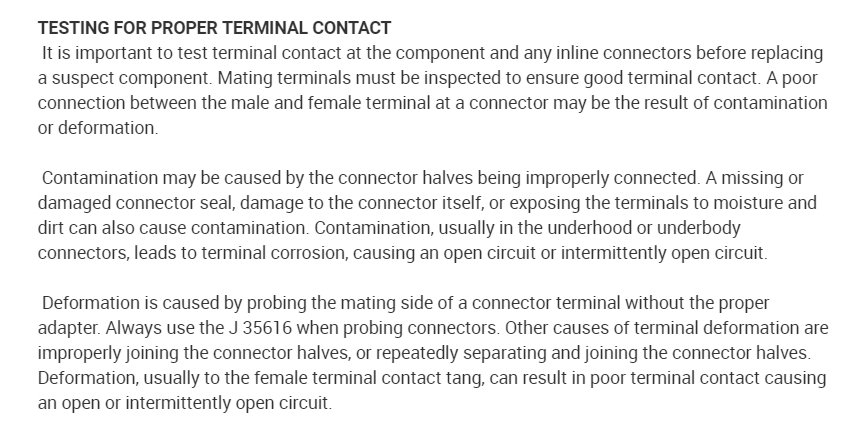

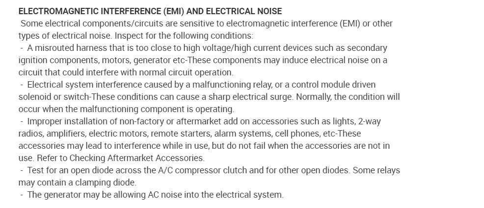

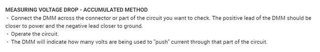

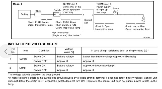

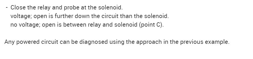

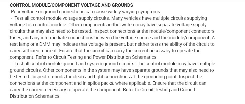

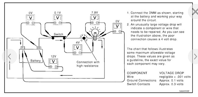

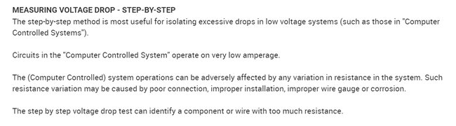

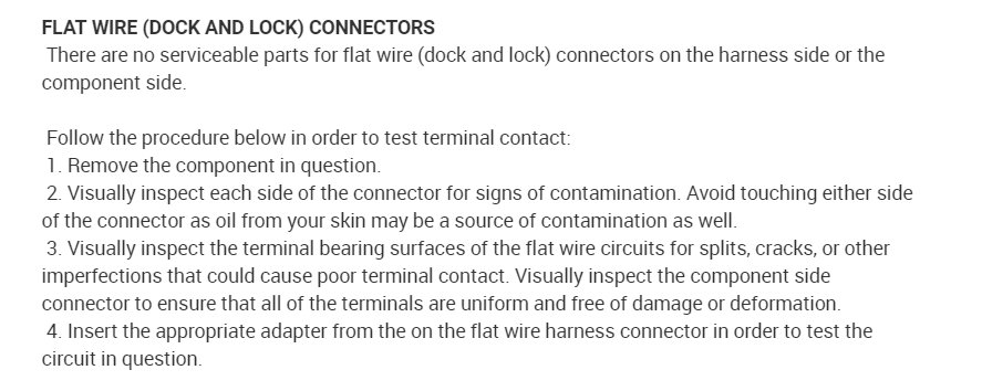

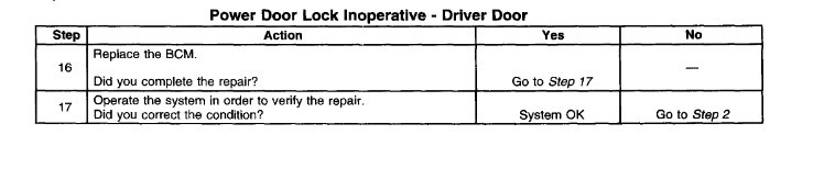

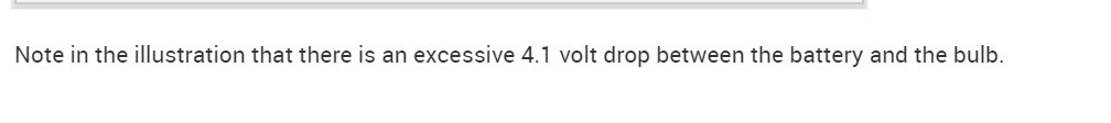

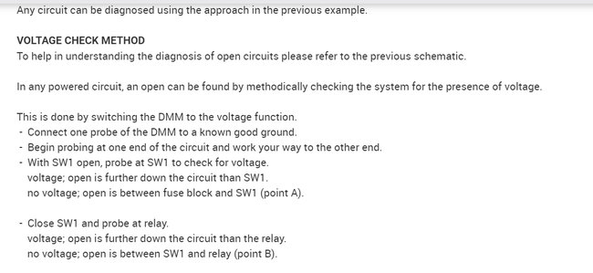

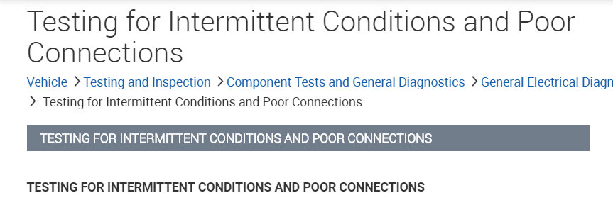

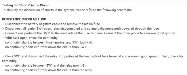

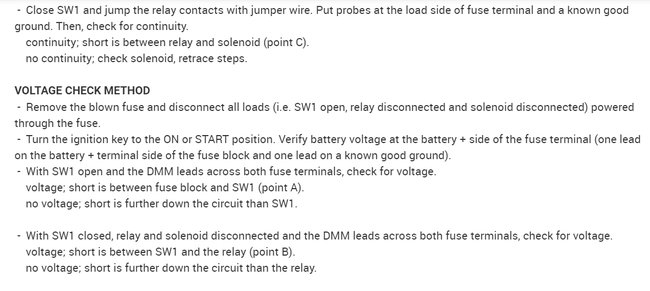

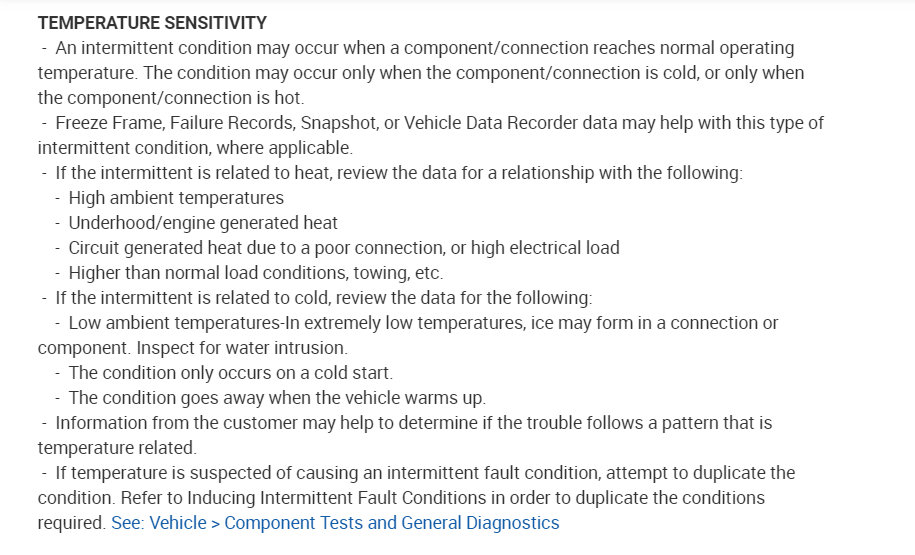

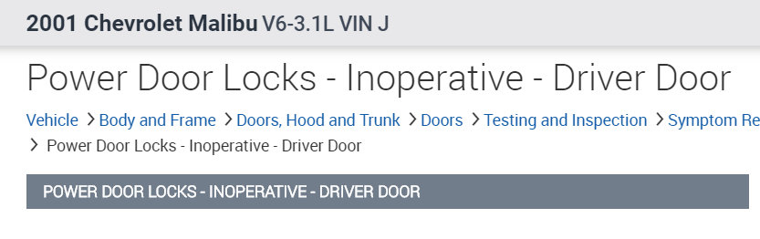

Okay, in the diagrams down below I have included the diagnostic troubleshooting guides for the driver's side door power locks inoperative, how to find a short to power and short to ground in an automotive electrical circuit, how to find an intermittent and poor electrical connectors in an automotive electrical circuit, and how to find unwanted resistance in an automotive electrical circuit via voltage drop method. You will need to use a Digital Multi-meter [DMM] to do this, so here is a link below explaining how to use, if needed:
Please go through these guides and get back to us with what you are able to find out.
