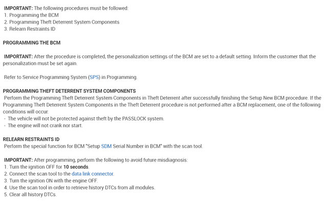

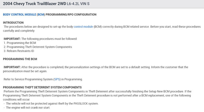

Did you use the scan tool to gather the old BCM information to be transferred to the new BCM?
Information on programming:
Gather Necessary Information: Before starting the programming process, make sure you have all the relevant information, such as vehicle identification number (VIN), programming file(s) for the new BCM, and any security credentials or codes required for access.
Read Current BCM Data: The scan tool will read the current data from the old BCM, allowing you to verify the configuration and settings before transferring them to the new BCM.
Here is additional information from AllData. You can get a preprogrammed unit by searching Google or Ebay if you give them your VIN. Check out the images (below). Please let us know how it goes.
