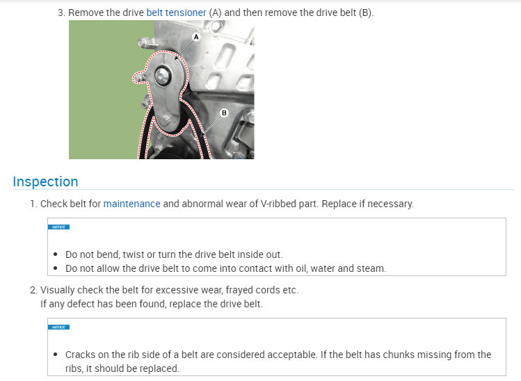

Can't figure out how to loosen the serpentine belt. There's a tensioner towards the back, but it doesn't budge at all.
The 2016 model had no tensioner and an adjuster under the alternator, but the 2017 has a tensioner. I just can't get it to move. Help!

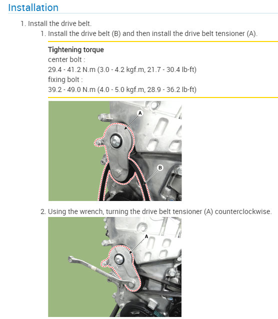

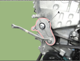

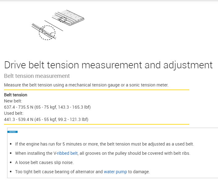

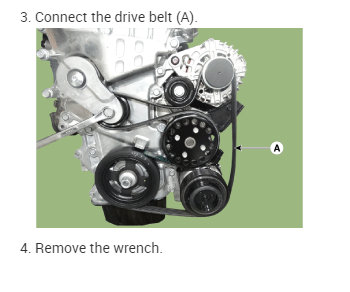

Here is a basic tutorial for you showing what's involved for remove/replace:
https://www.2carpros.com/articles/replace-serpentine-belt
https://www.2carpros.com/articles/how-a-serpentine-belt-tensioner-works

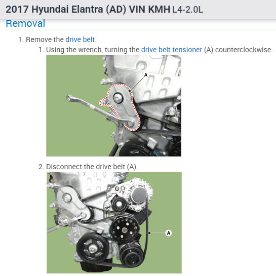

I've attached below step-by-step instructions for your vehicle.Hope this helps and thanks for using 2CarPros.

You need to use a wrench to turn the tensioner so the pulley moves in to loosen the belt as shown in the pictures. Then you need to remove the tensioner to get the belt free.

The wrench or socket you can use to release tension to remove and replace the Serpentine belt from the tensioner is 17mm. Hope this helps and thanks again for using 2CarPros.

You can try using some penetrating oil on the center of the tensioner and then use a hammer to try to move it in both directions and free it. If the tensioner will not move the next step would be to remove the tensioner itself and replace it while replacing the belt. It doesn't move easily and depending on where you can put the wrench it can make it worse.

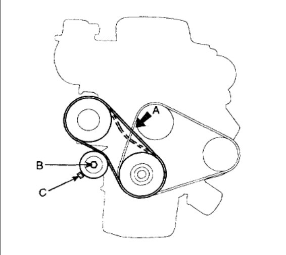

I need to replace the AC belt?
Jan 25, 2021 at 12:49 PM (Merged)
You will need to loosen the locking bolt (B) and turn (A) to relieve tension and readjust after belt replacement
Check out the diagrams (Below) Please let us know if you need anything else to get the problem fixed.
