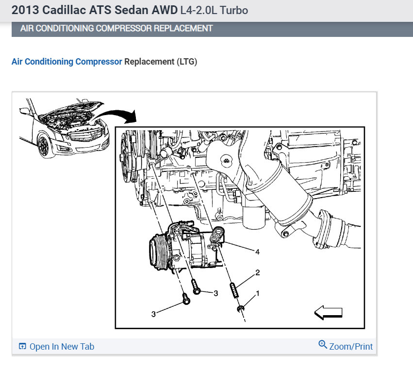

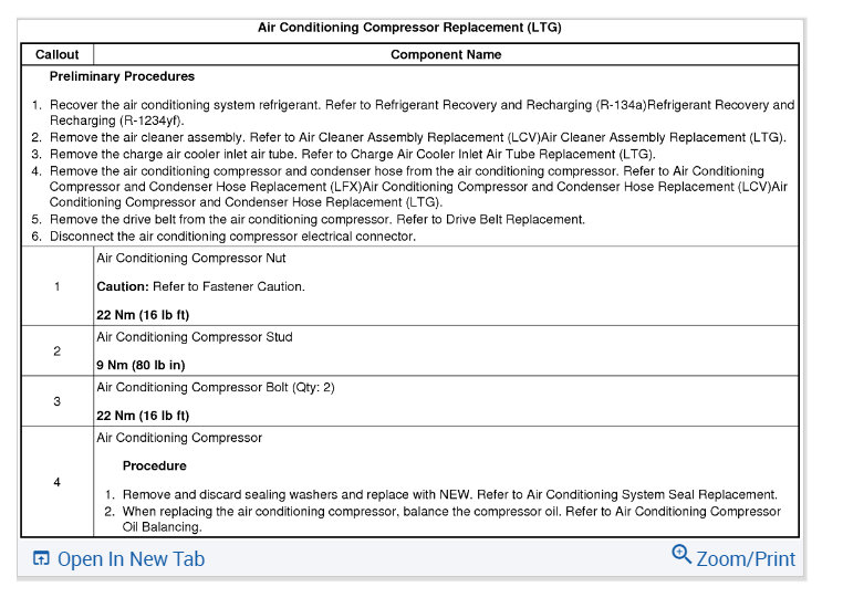

This happens when the A/C compressor coil is shorted out, which is a common repair on all cars. I would get a new compressor from Amazon (AC Delco unit). here are generic guides to help you do the job with specific instructions in the diagrams below for your car:

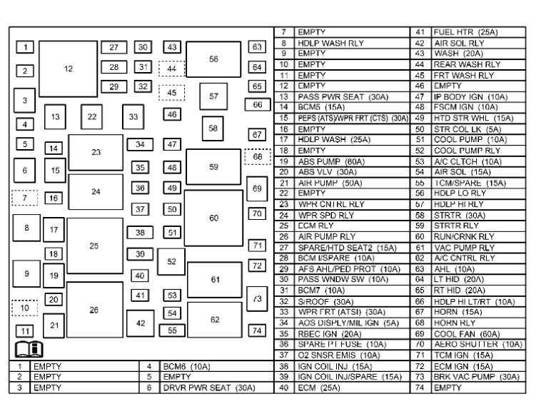

There is only one wire (brn-grn) from the compressor clutch and the relay, it could be the relay is shorted out because of the bad compressor. here is a guide to help check it and the location of the relay #62:

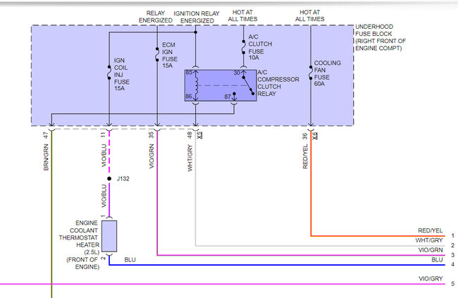

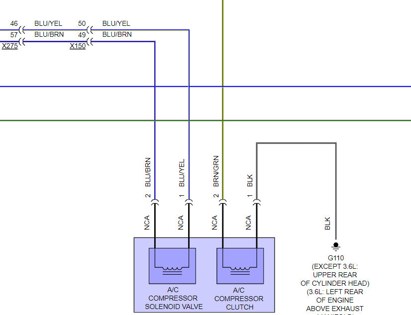

It is either the relay or the wiring going to the compressor. here is the wiring diagrams so you can see how the system works brown/green wire go to the compressor from the relay you can test the connection and a short to ground using this guide:

The only thing left is the wiring, it must be pinched or rubbed through. Please use the guide and wiring diagrams to test the brown/green wire, make sure it is not shorting to ground.

I had to run a wire to compressor to battery to over pass it but it’s working that way. Thank you so much for advice and help. I highly appreciate it.
Jun 29, 2022 at 5:36 PM
Yep, the wire must have been shorted, Glad you could get it fixed, that kind of problem can be tough. Please use 2CarPros anytime we are here to help.
