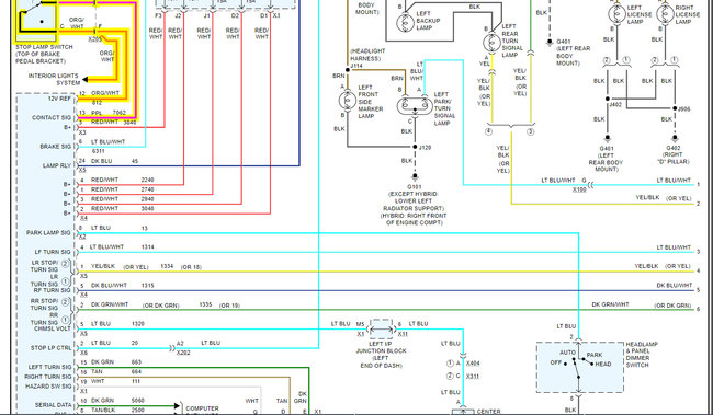

Good evening,

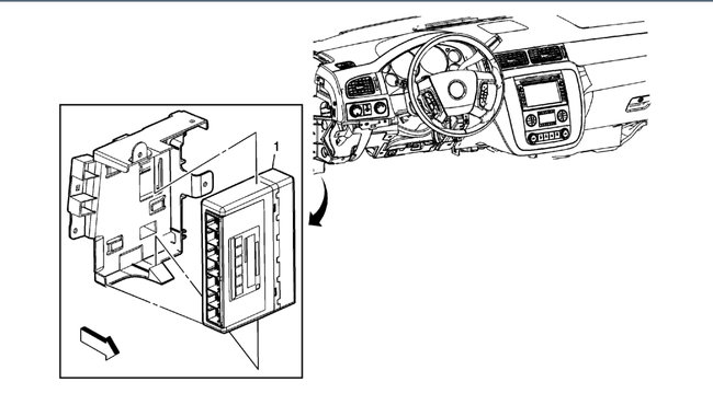

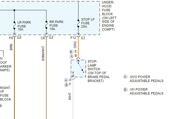

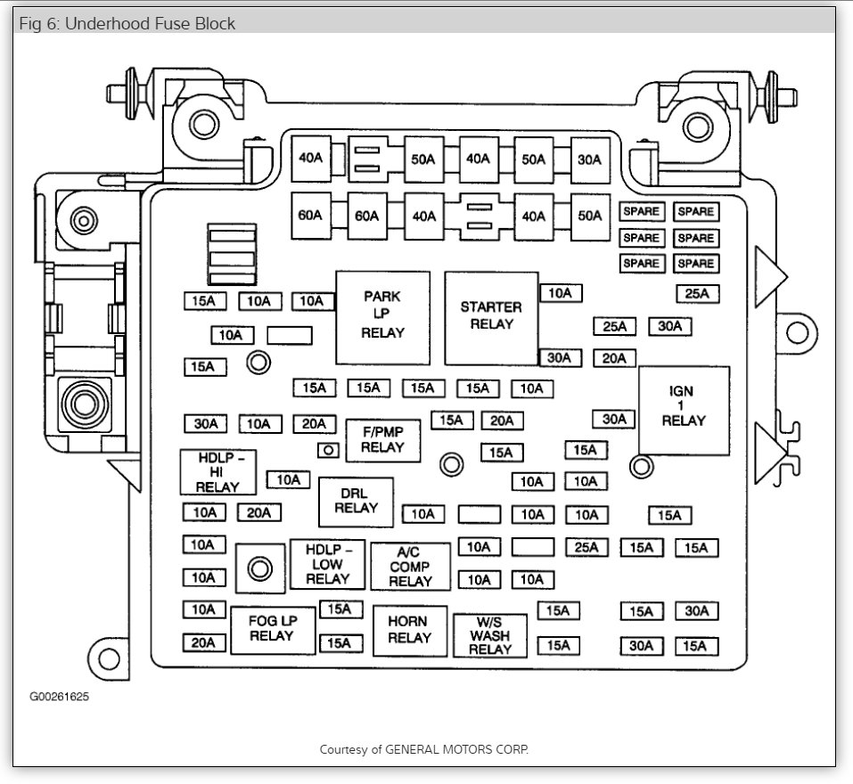

The brake light switch sends a signal to the body control module and the module sends power to the lights.

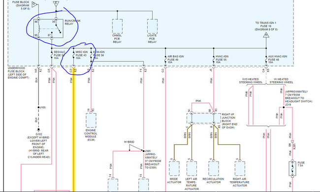

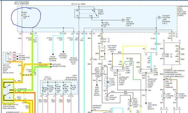

There is a fuse for the switch which I circled in the fuse diagram.
Make sure you have power to both fuses I circled.

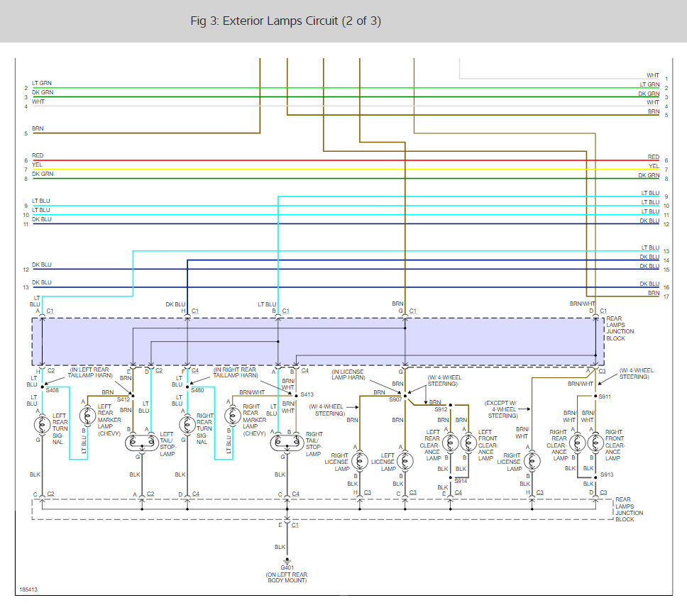

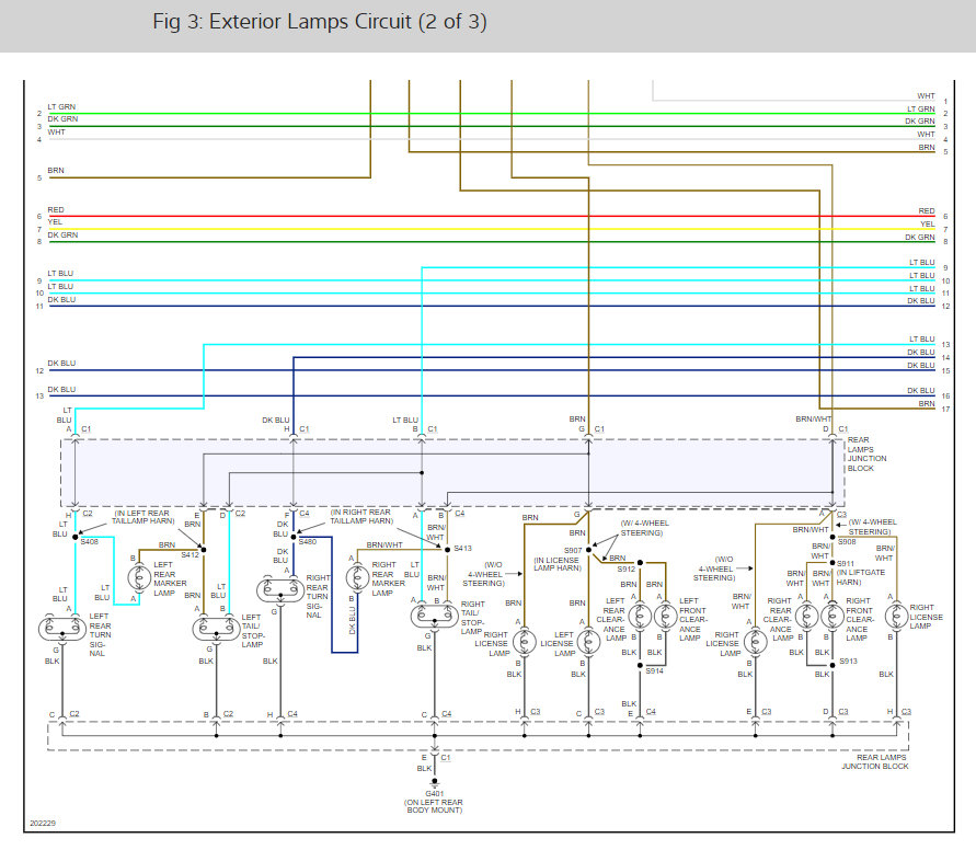

There is no power going to the right brake light. The brake light bulb is a double element with tail light. There is also a separate socket with double element tail/signal. All lights work except right brake. I unplugged the 5 wire pigtails on each side and compared checking for power. There is one wire that is hot all the time on each pigtail, same position. When brakes are applied a second wire becomes hot on left side, but not on the right. I am trying to determine where the right side branches off, assuming it comes from the front on one wire. I can't find any sort of junction block where they branch off from. The harness has not been disturbed and every anchor point is tight and all wire coverings intact. The fuse shows to be with the signal even though they are separate bulbs, and the fuse is good. Thanks for your help.

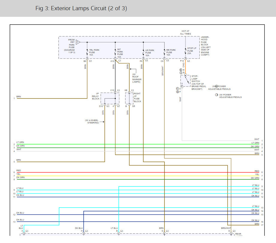

DANNY L
  • 5,648 POSTS

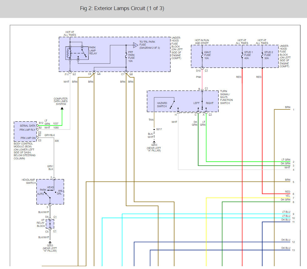

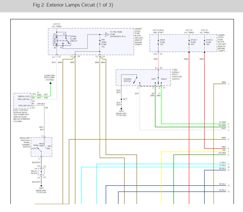

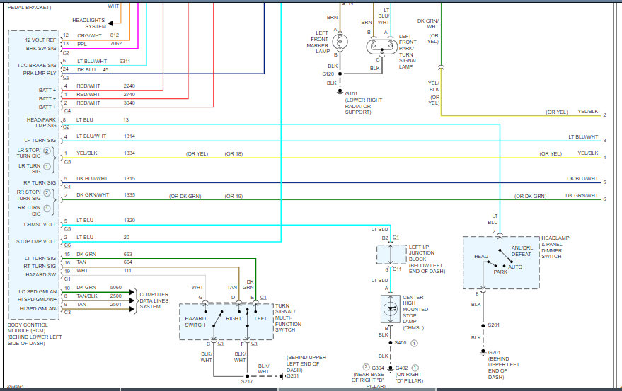

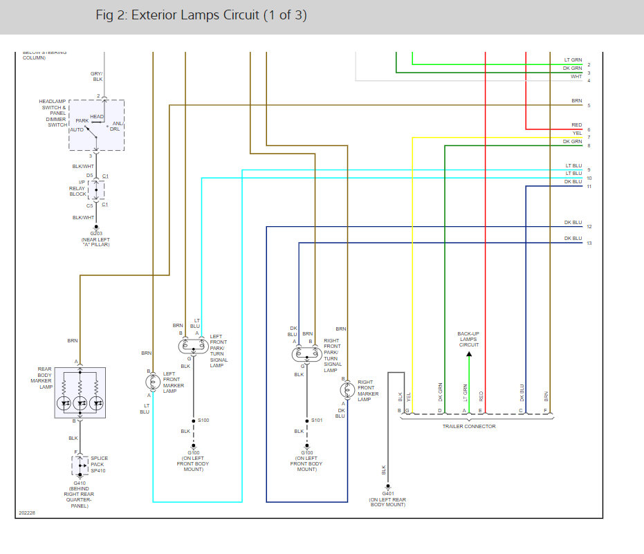

Hello, I'm Danny.
I've attached a wiring diagram of the exterior lights below for your SUV. I've cut the pictures in half so you can view larger. Here is a tutorial on how to test wiring:
Hope this helps and keep us updated as to what you find. Thanks for using 2CarPros.

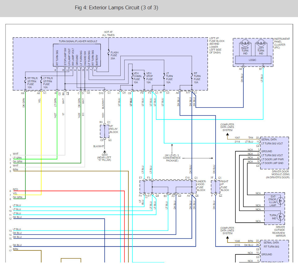

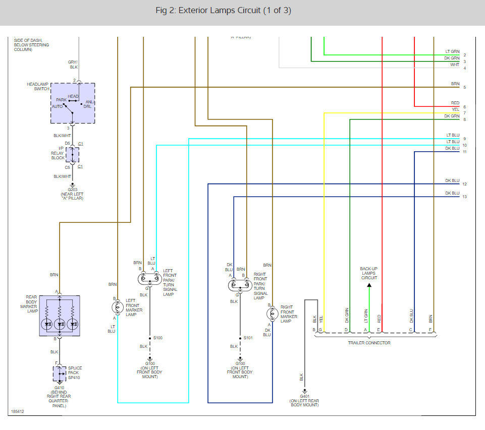

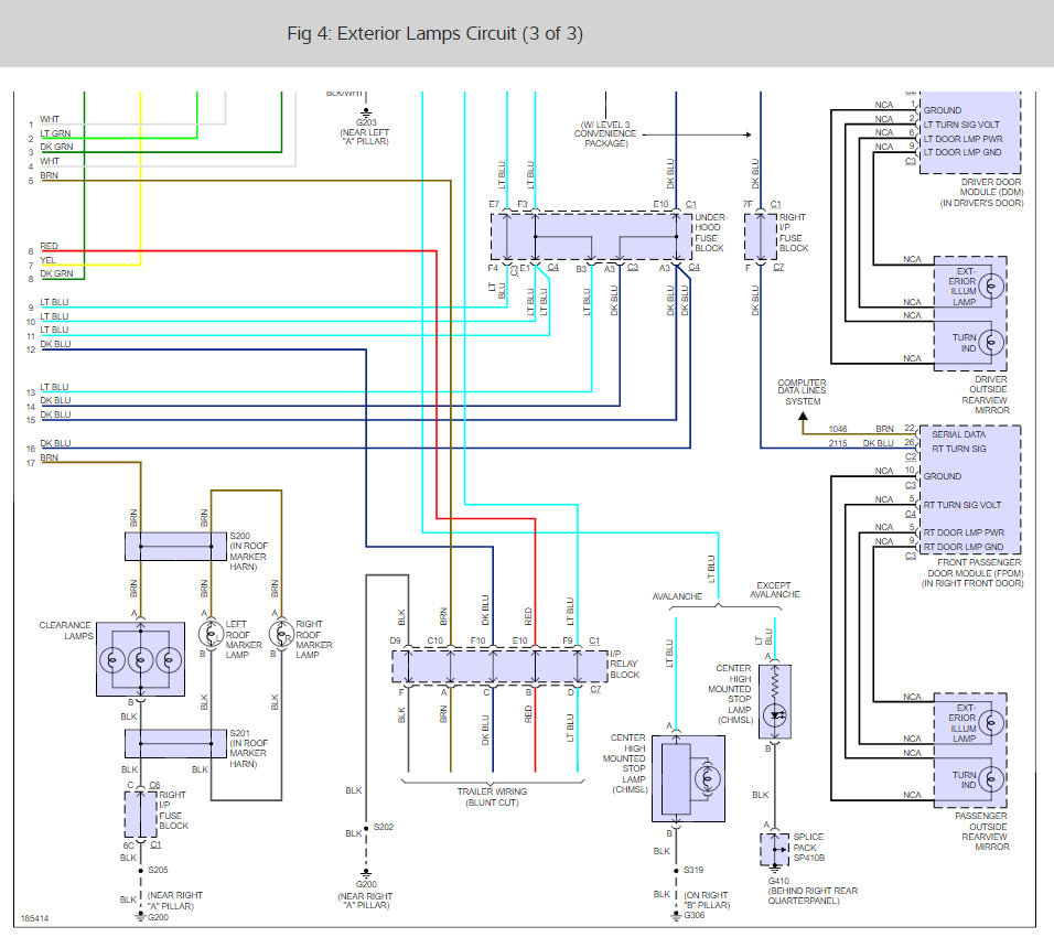

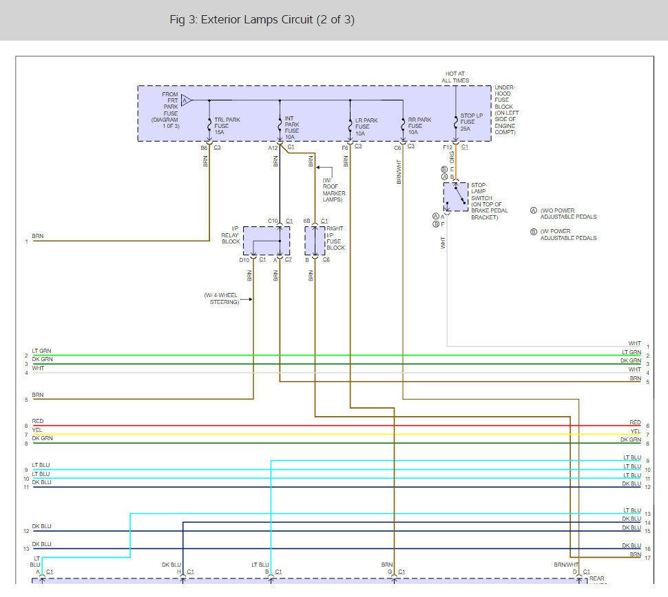

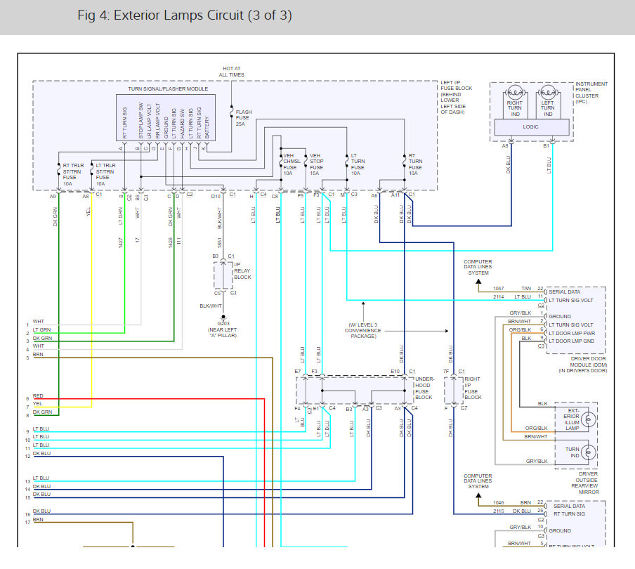

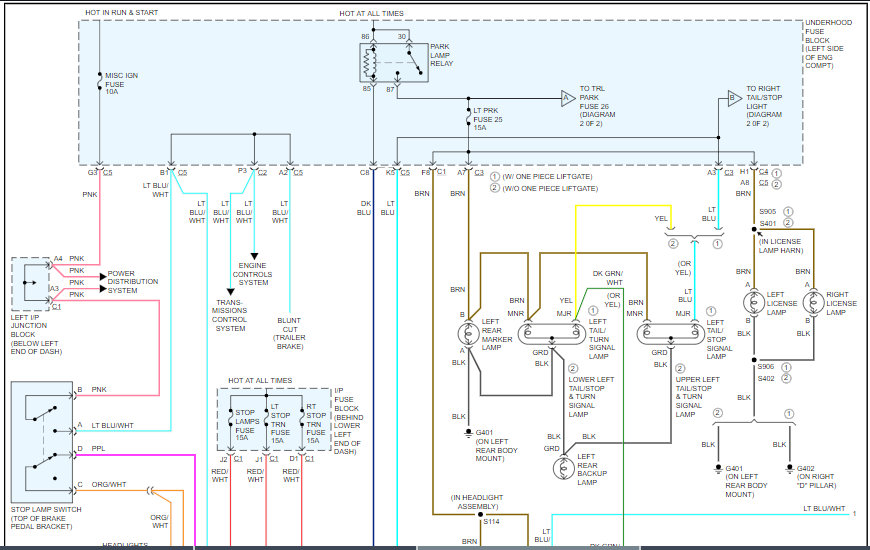

I have seen the brake light switch and the flasher module stop working to cause this issue here is guide and the brake light wiring diagrams so you can see how then system works and which wires to test to see where you are losing power.
Check out the diagrams (Below). Please let us know what you find. We are interested to see what it is.
Dec 23, 2020 at 1:31 PM (Merged)
MR. HYPERVENTILATING
Thanks it was the flasher module I had to get a new one for $54.00 fix my problem. I love this site.

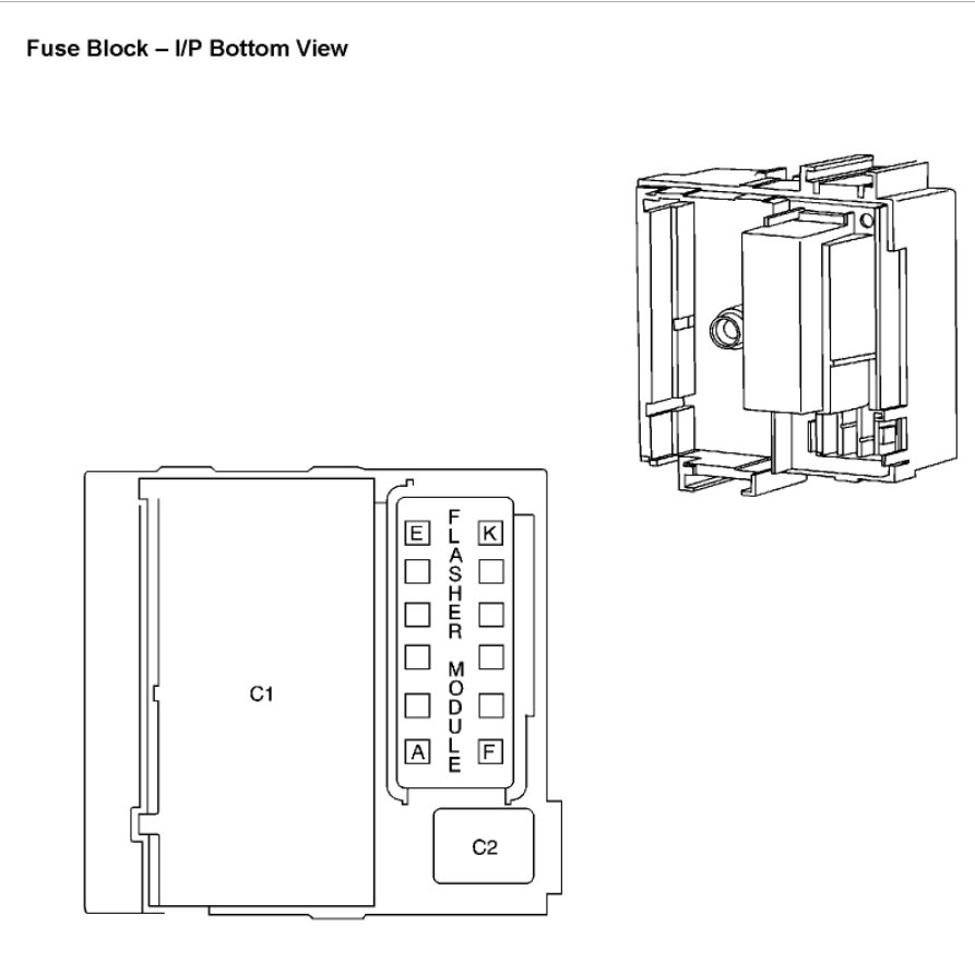

There is a flasher module under the fuse box that goes out.
Here is a wiring diagram and the location of the flasher module so you can take a look and do some testing here is a guide to do so:
Check for power at the fuses as well.
Check out the diagrams (below).

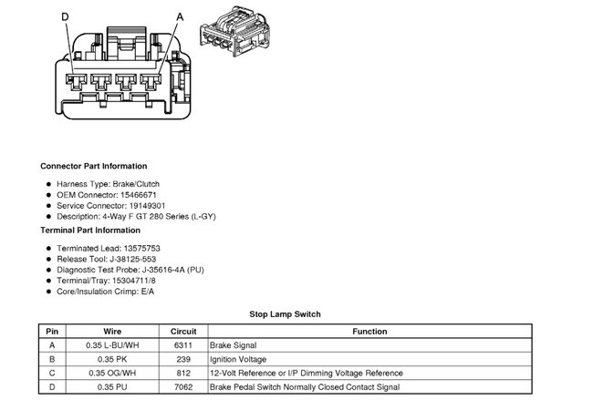

Good afternoon,
Did you verify power in and out of the switch for the brake lights?
The orange wire is power from the fuse block and the white is power out to the turn signal switch.

Hello, there two fuses for the brake circuit, you need to check the fuse circuits, to see if they are hot.
The stop lamp fuse is hot all the time, supplies voltage to the brake switch.
The vehicle stop fuse is after the switch, goes hot when you step on the brake. Both fuses should be in the underhood electrical center. Driver side brake lite voltage, lite blue wire.

Hello, does the high-mount brake lite work? If none of the brake lites work, check the feed to the brake switch. The switch should be activated by the brake pedal arm. Orange wire is hot all the time, white wire goes hot when the switch is activated.

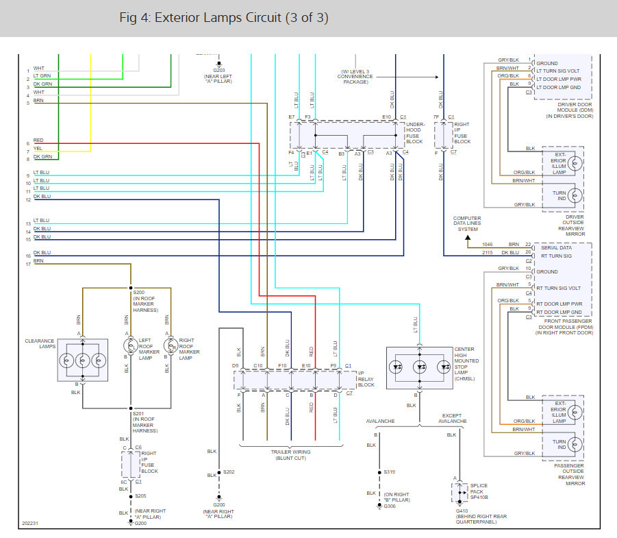

Your brake light wiring harness may be faulty or wiring harness plug may have come loose. If your cyclops is working then the stop light switch is working.

check lt. blu wire to see if there is power there, it may be a bad socket or a bad ground. it grounds to spare tire bracket under truck. If no power it is broken wire or bad connection at very rear cross frame there should be a circuit board that may be the problem as well it' s on lh side of truck
