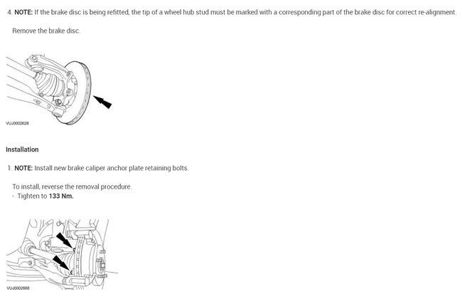

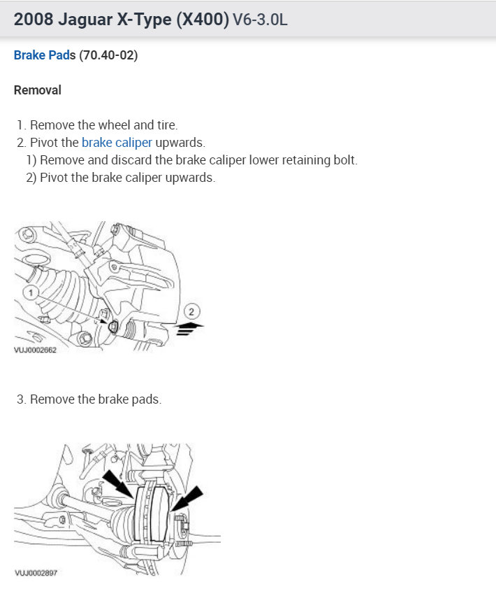

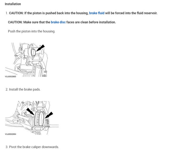

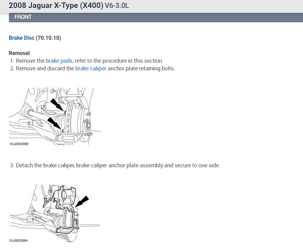

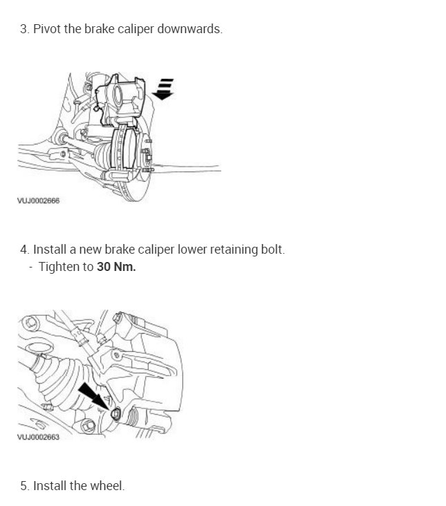

It sounds like you have warped brake rotors, if you can upload a quick video and upload it here in your response I can tell for sure. I have included instructions on how to replace the brake rotors and pads in case you need them in the images below. This guide can help as well:
