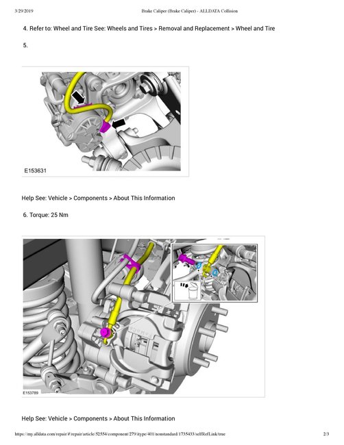

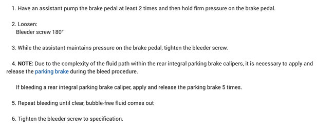

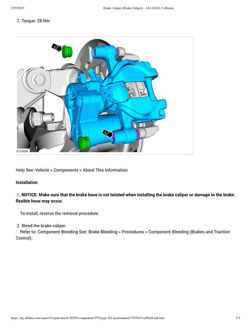

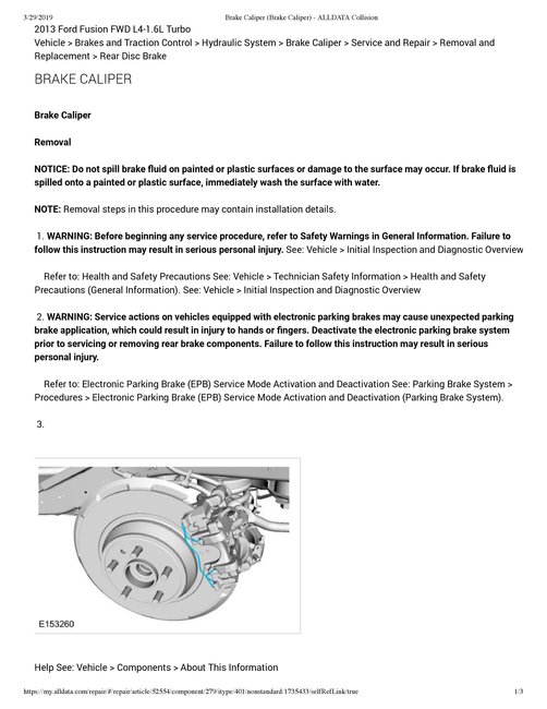

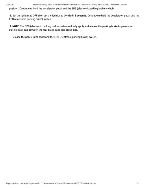

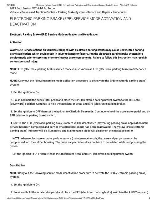

Hey TIMBRIGHT,
I will attach the instructions to replace the rear caliper.
They advise you deactivate the park brake before doing this so i will also add the procedure for this. You will need to reactivate after fitting.
For bleeding i will also add the section on brake bleeding, it looks like you just need to activate the park brake a few times to remove all the air from the caliper. You may need to start the engine to do this but it should work with just ignition on.
The bleeding part you do not need the engine on for.
Hope this is everything you need but any further questions please do not hesitate to ask.

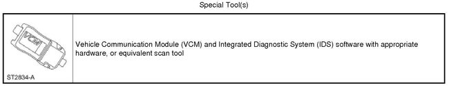

Good morning,
There is no other way to bleed it except with a scan tool. The scan tool opens all the solenoids and allows the air out of the system.
Hydraulic Control Unit (HCU) Bleeding
WARNING: Do not use any fluid other than clean brake fluid meeting manufacturer's specification. Additionally, do not use brake fluid that has been previously drained. Following these instructions will help prevent system contamination, brake component damage and the risk of serious personal injury.
WARNING: Carefully read cautionary information on product label. For EMERGENCY MEDICAL INFORMATION seek medical advice. In the USA or Canada on Ford/Motorcraft products call: 1-800-959-3673. For additional information, consult the product Material Safety Data Sheet (MSDS) if available. Failure to follow these instructions may result in serious personal injury.
WARNING: Do not allow the brake master cylinder to run dry during the bleeding operation. Master cylinder may be damaged if operated without fluid, resulting in degraded braking performance. Failure to follow this instruction may result in serious personal injury.
NOTICE: Do not spill brake fluid on painted or plastic surfaces or damage to the surface may occur. If brake fluid is spilled onto a painted or plastic surface, immediately wash the surface with water.
NOTE: When any part of the hydraulic system is disconnected for repair or installation of new components, air can get into the system and cause spongy brake pedal action. This requires bleeding of the hydraulic system after it is correctly connected.
All vehicles
1. Use the Pressure Bleeding procedure to bleed the system. For additional information, refer to Brake System Bleeding.
2. Connect the scan tool and follow the ABS HCU Hydraulic Control Unit (HCU) bleeding instructions.

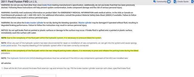

Welcome to 2CarPros.
Due to the complexity of the fluid path within the hydraulic system, it is necessary to pressure bleed the system. To make things worse, it requires specific software. Here are the directions:
________________________
2010 Ford Fusion FWD L4-2.5L
Vehicle Brakes and Traction Control Hydraulic System Brake Bleeding Service and Repair Procedures Brake System Bleeding
BRAKE SYSTEM BLEEDING
picture 1
picture 2
Pressure Bleeding
NOTE: When any part of the hydraulic system has been disconnected for repair or installation of new components, air can get into the system and cause spongy brake pedal action. This requires bleeding of the hydraulic system after it has been correctly connected.
NOTE: Due to the complexity of the fluid path within the rear integral parking brake calipers, it is necessary to press and release the parking brake during the bleed procedure.
NOTE: The Hydraulic Control Unit (HCU) bleeding procedure must be carried out if the HCU or any components upstream of the HCU are installed new.
All vehicles
1. Clean all the dirt from around the brake fluid reservoir cap and remove the cap. Fill the brake master cylinder reservoir with clean, specified brake fluid.
pic 3
2. NOTE: Master cylinder pressure bleeder adapter tools are available from various manufacturers of pressure bleeding equipment. Follow the instructions of the manufacturer when installing the adapter.
Install the bleeder adapter to the brake master cylinder reservoir and attach the bleeder tank hose to the fitting on the adapter.

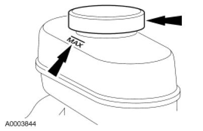

This isn't a difficult process, but you will need a helper. To get you started, here is a video showing how it's done. Use this as a guide.
https://youtu.be/w7gUsj2us0U
Here are the directions specific to your vehicle.
Manual Bleed
WARNING: Use of any other than the approved DOT 3 brake fluid will cause permanent damage to brake components and will render the brakes inoperative. Failure to follow these instructions may result in personal injury.
WARNING: Brake fluid contains polyglycol ethers and polyglycols. Avoid contact with eyes. Wash hands thoroughly after handling. If brake fluid contacts eyes, flush eyes with running water for 15 minutes. Get medical attention if irritation persists. If taken internally, drink water and induce vomiting. Get medical attention immediately. Failure to follow these instructions may result in personal injury.
CAUTION: Do not allow the brake master cylinder reservoir to run dry during the bleeding operation. Keep the master cylinder reservoir filled with the specified brake fluid. Never reuse the brake fluid that has been drained from the hydraulic system.
CAUTION: Brake fluid is harmful to painted and plastic surfaces. If brake fluid is spilled onto a painted or plastic surface, immediately wash it with water.
NOTE: When any part of the hydraulic system has been disconnected or a new component is installed, air may enter the system, causing spongy brake pedal action. This requires the bleeding of the hydraulic system after it has been correctly connected.
1. CAUTION: Be sure to check the brake fluid level in the brake master cylinder reservoir often. Do not let it run dry.
Fill the brake master cylinder reservoir with the specified brake fluid.
2. Begin bleeding the system, going in order from the RH rear wheel, to the LH rear wheel, to the RH front wheel and ending with the LH front wheel.
3. Attach a rubber drain hose to the rear bleeder screw and submerge the free end in a container partially filled with clean brake fluid.
4. Have an assistant pump the brake pedal 10 times and then hold firm pressure on the brake pedal.
5. Loosen the bleeder screw until the fluid flow stops. Maintain pressure on the brake pedal and tighten the bleeder screw.
6. Repeat Steps 4 and 5 until clear, bubble-free brake fluid flows.
7. Tighten the bleeder screw to 8 Nm (71 inch lbs.).
^ Refill the brake master cylinder reservoir as necessary.
8. Continue bleeding the brake hydraulic system at each wheel.

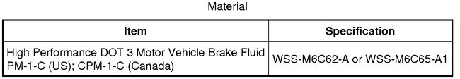

9. Fill the brake master cylinder reservoir with the specified brake fluid.
