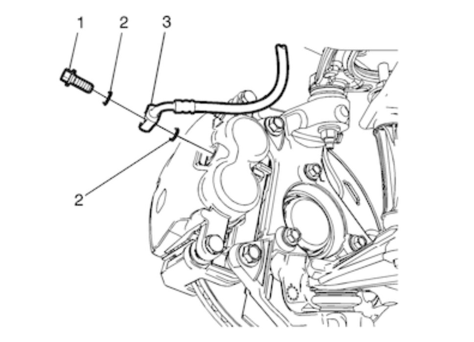

Since it is only the front brakes, I question the master cylinder. Try this. When the brakes are locked up, see if they release if you open the brake line at the master cylinder. If it doesn't, work forward. Move to the caliper. Open the bleeder and see if the brake releases.

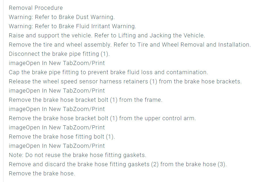

I have seen situations where the rubber brake hose on the calipers would fail internally causing the brake pads to remain partially actuated or fully. When driving, there would be enough drag on the brakes to cause them to get hot. Now, brake fluid expands when it is hot, so the brakes would slowly continue to engage.
If the brakes release when you open the bleeder on the caliper, replace the rubber brake hose.

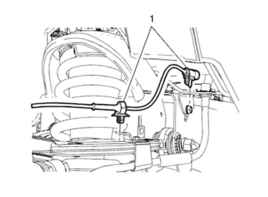

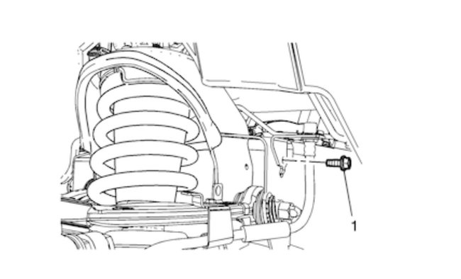

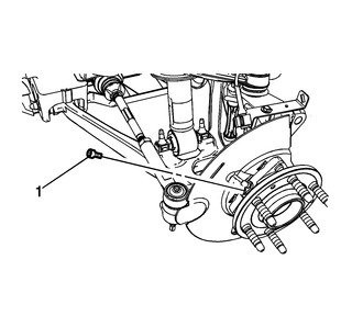

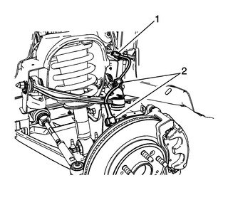

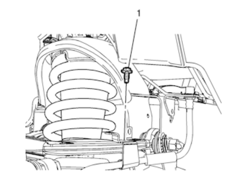

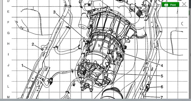

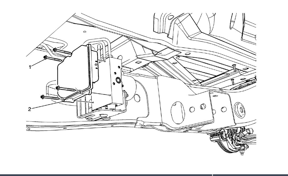

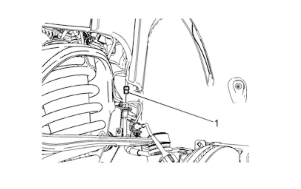

I didn't realize turning caused this problem. With that in mind, the first thing I would check are the ABS sensors on the front wheels. Check to confirm the wiring isn't damaged, shorted, or not properly plugged in at the connector.
I attached pictures of where the wiring mounts and sensor location. Check both sides. Also, based on the year, I strongly recommend scanning the computer for diagnostic trouble codes.

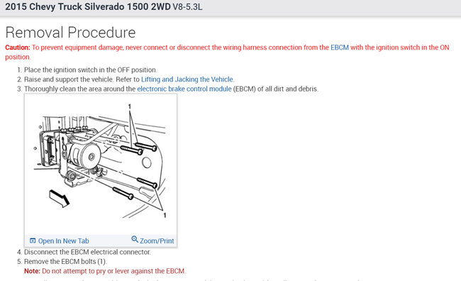

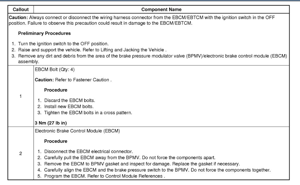

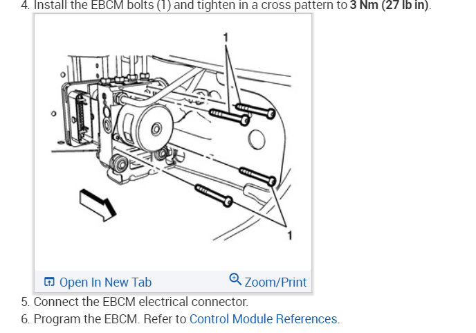

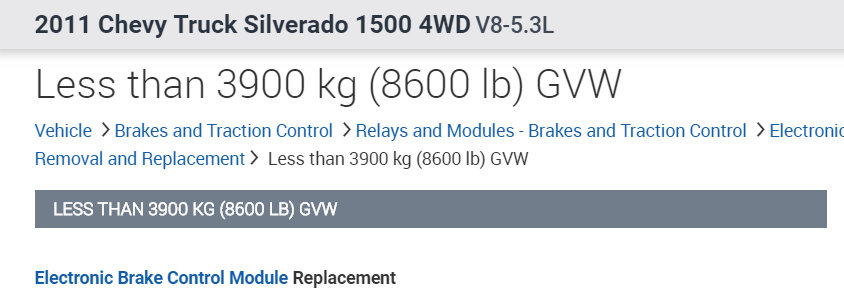

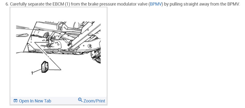

If the module is to blame this video with show you how to replace it with instruction and diagram below to help show you on your truck.
https://youtu.be/lUotkKXG9dY
ABS traction control module replacement reprogramming.
Note:
DO NOT program a control module unless directed to by a service procedure or a service bulletin. If the control module is not properly configured with the correct calibration software, the control module will not control all of the vehicle features properly.
Ensure the programming tool is equipped with the latest software and is securely connected to the data link connector. If there is an interruption during programming, programming failure or control module damage may occur.
Stable battery voltage is critical during programming. Any fluctuation, spiking, over voltage or loss of voltage will interrupt programming. When required install the EL-49642 - SPS Programming Support Tool to maintain system voltage. If not available, connect a fully charged 12?V jumper or booster pack disconnected from the AC voltage supply. DO NOT connect a battery charger.
Turn OFF or disable systems that may put a load on the vehicles battery such as; interior lights, exterior lights (including daytime running lights), HVAC, radio, etc.
During the programming procedure, follow the SPS prompts for the correct ignition switch position.
Clear DTCs after programming is complete. Clearing powertrain DTCs will set the Inspection-Maintenance (I-M) system status indicators to NO.

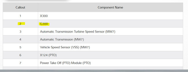

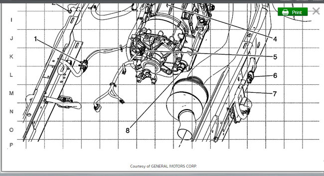

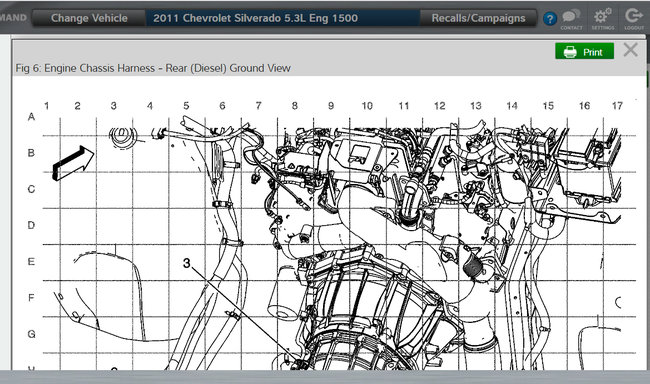

  • 4,897 POSTS
Okay, this could be a problem with ground #300, which is located below the drivers door on the body mount. Check and make sure that the ground is clean, corrosion free, tight, and making good metal to metal contact. Please check this ground out and get back to us with what you are able to find out.

Hello again,
This is the ground for your vehicle's Electronic Brake Control Module (EBCM). 75% of all electrical problems on a vehicle are ground problems.If the ground is okay, I would suspect the EBCM itself. In the diagrams below I have included the directions for removal and installation of the EBCM. Please go through the guide and get back to us with what you are able to find out.
