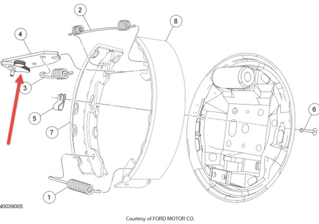

In order to save myself some money, which is now debateable, I changed the rear brake drums on my car. The reason for the change was that while driving one day recently, the rear of the car started to sway as if fishtailing. When taking of the left rear wheel and drum, it was clear that the bearings were shot. In addition, the race and other components of the bearings had melted to the spindle. In an effort to fix my car, I decided to replace both rear drums as well as spindles. This included replacing the brake shoes as well.
Removing all of the items in questions was fairly straight forward. Putting them back together was a different story. The spindles both went on with ease. I also replaced the ABS line going into each spindle on the back as well. This was easy as well.
The brake shoes were not bad in getting them on but took a little longer. I looked at several diagrams and pictures I took from before I removed them for guidance.
The issue arises when I tried to put the new drum over the new spindle. Most resources stated that these should slide right on. This was not the case. I triple checked that the parts I bought were the correct ones, and it appears they are. That being said, it took a rubber mallet, and basically the same amount of energy it took to get the old ones off, to get the new ones on.
The new brake shoes were always in the way. On both sides it took several attempts, of putting on and pulling off the new drums until I got what I thought was right. In the first attempts, the wheel would not even move when I got the drum all the way on. I had to use a hammer to get them off again, and actually had to purchase a new drum again because I do not have a press and purchased drums with wheel bearings included. These were damaged when pulling off the new drum, probably pulling it off crooked.
At any rate, none of the articles I used mentioned an adjuster, which I did nothing with.
When I trusted the car out for the first trial run, the rear left wheel turned somewhat while on the jack, but not nearly the one and a half turn that some resources suggested it should do. The rear right side was fine. After driving, there was a significant smell and smoke/steam coming from rear left tire. I pulled the tire and drum off again, this time by removing the spindle. Once the drum and spindle were off, the drum spun fine, so I am guessing the brake shoes are the culprit.
When I pulled all of it off on this last time, the brake drum backing plate came off as well. I tried to find another one, but could not. I put everything back together using the spindle to hold the rear backing plate on this time. I also had to replace this left rear brake line, the steel part since it broke.
The last caveat to all of this is that in order to get both rear drum s on, it required disconnecting the emergency brake. It was too tight and essentially pulling the new brake shoes. I have not reconnected the emergency brake.
As far a driving now goes, there is minimal smell from before, but it is there, and the brake pedals require pumping in order to get the brakes to work. The first push is all the way to the floor and subsequent brake pedal pushes add the necessary resistance to stop.
I know there is a lot here, but if you can decipher all I have done, that is great. There are several questions I have however related to all of this:
1) Is it okay to attach the old brake drum backing plate using the spindle?
2) How do I use the adjustor to adjust the brake shoes? (I had a hard time getting the shoes to align on the wheel cylinder)
3) how do I tell if the new bearings I put on are bad? (the smell, visually, etc.)

more than likely you probably forgot or did not know to back off the adjusters on both sides and brake shoes were to large for the drums you also when disconnecting brake lines you need to rebleed the system. the best thing for you to do now is to take to a mechanic so he can open all the valves on the ABS unit and bleed and adjust the brakes that you have installed that should take care of it. see picture.

Hey JEFFCLANDERS,
Yep it sounds like you got the rear brake show adjustment off, here is a guide to show you how to do the job.
https://www.2carpros.com/articles/how-to-replace-rear-brake-shoes-and-drums

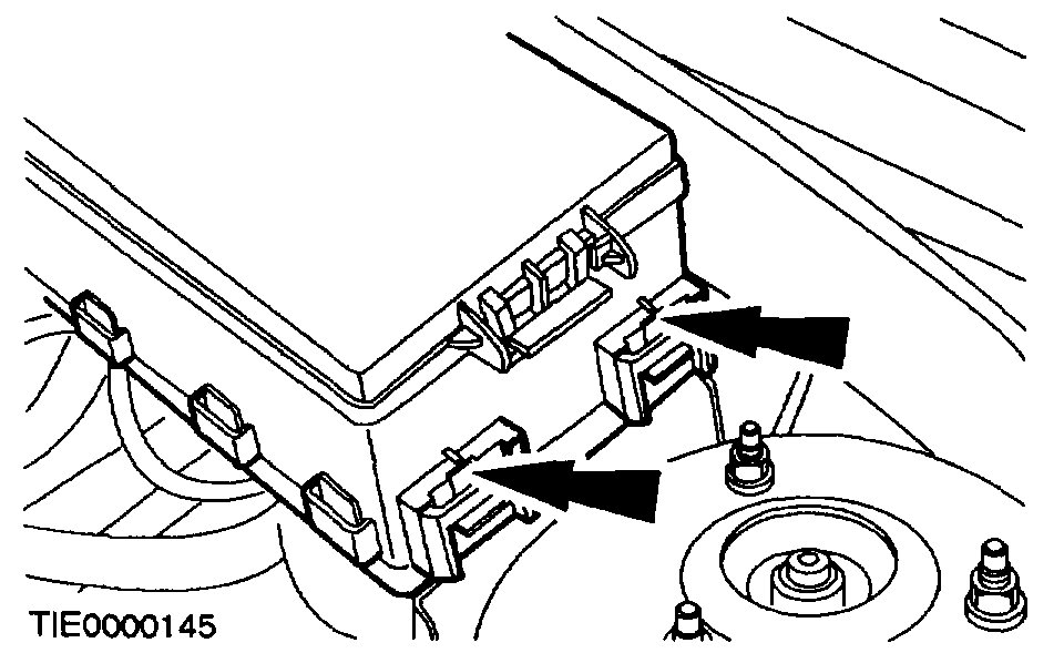

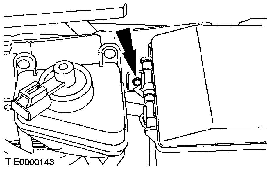

2. Disconnect the electrical connector from the filler cap.
1 Pull back the tab.
2 Depress the clips.
3 Disconnect the electrical connector.
Picture 2

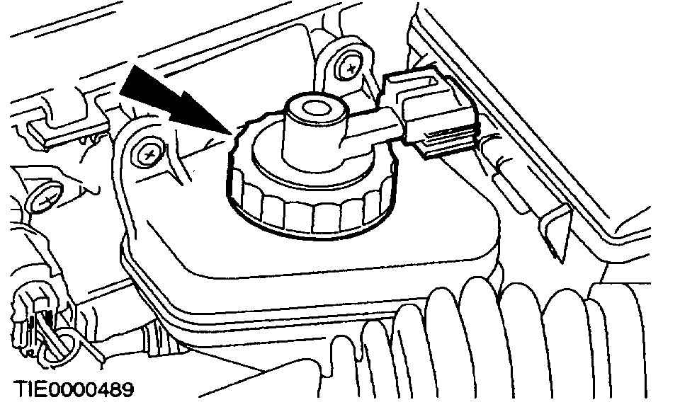

3. CAUTION: Make sure the filler cap does not become contaminated.
Remove the brake fluid reservoir filler cap.

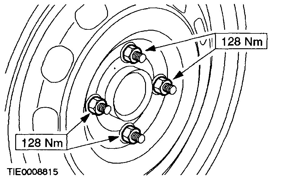

4. Loosen the wheel nuts of both front wheels.
5. Raise and support the vehicle.
6. Remove the front wheels.

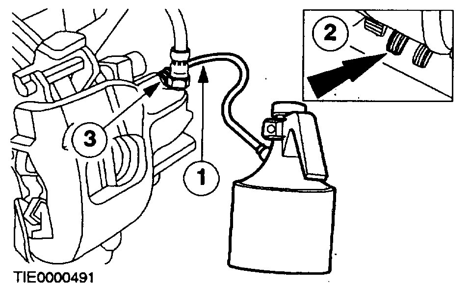

Picture 3

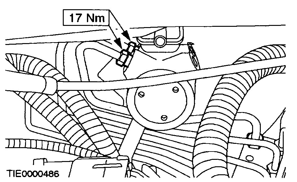

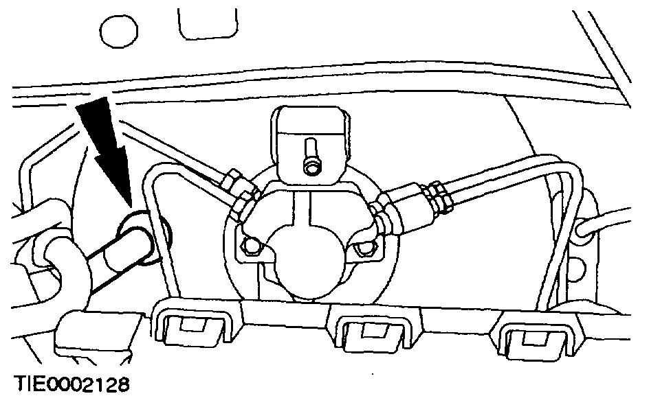

7. Loosen the bleed nipple.
1 Remove the dust cap.
2 Loosen the bleed nipple.

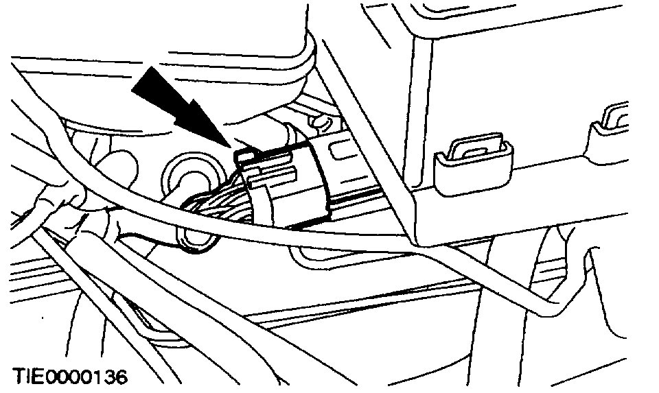

Picture 4
8. NOTE: Carry out this process on both the front brake lines.
Drain the brake fluid reservoir.
1 Connect a bleed tube to the bleed nipple and into a suitable container.
2 Pump the brake pedal until no more fluid is expelled.
3 Tighten the bleed nipple.

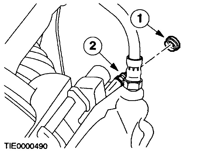

11. Remove the air cleaner.
12. Remove the air cleaner outlet tube.
Picture 5

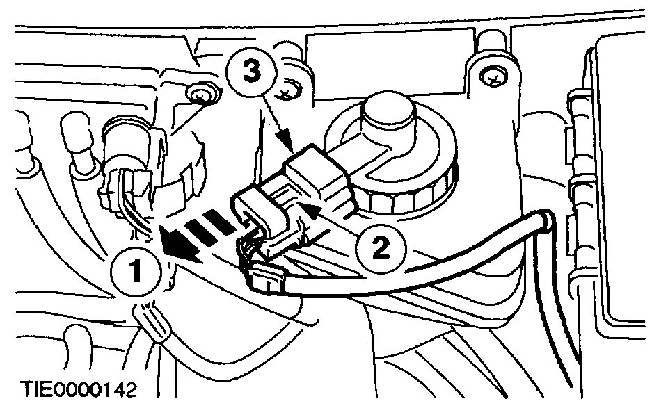

13. Disconnect the central electrical box electrical connector.
Picture 6

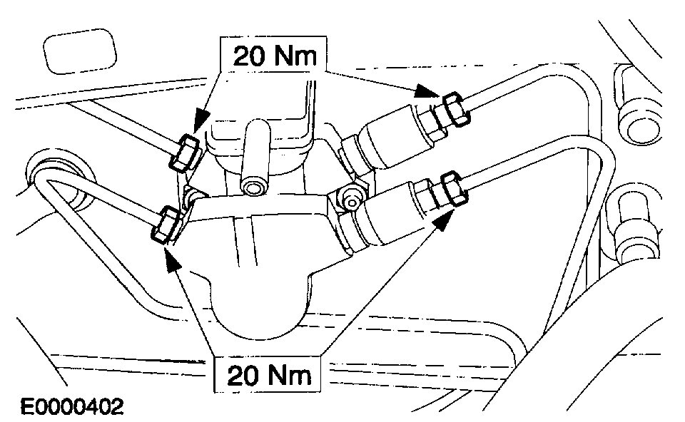

16. Disconnect the brake fluid feed tube.
Picture 9
17. CAUTION: Cap the brake tube connections to prevent fluid loss or dirt contamination.
Disconnect the brake tubes.
Picture 10

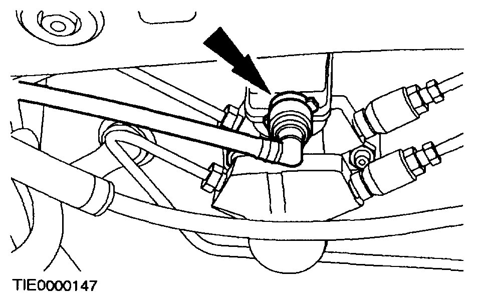

Vehicles with anti-lock brakes
18. CAUTION: Cap the brake tube connection to prevent fluid loss or dirt contamination.
Picture 11

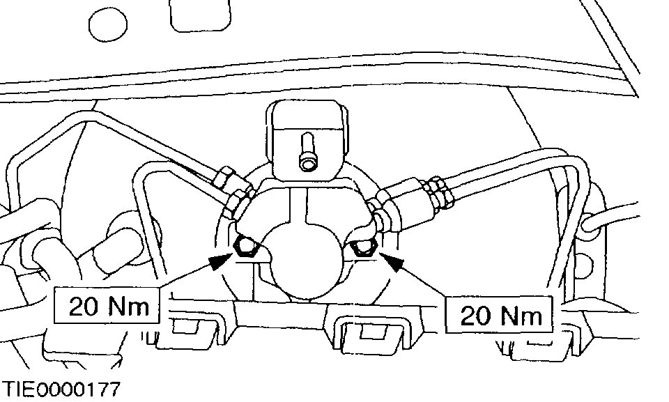

20. Remove the master cylinder.
Installation
Picture 13
Picture 14
All Vehicles
1. CAUTION: Before installing the master cylinder make sure that the vacuum seal is in place and that the mating faces are clean.
NOTE: After installation, bleed the brake system.
To install, reverse the removal procedure.
