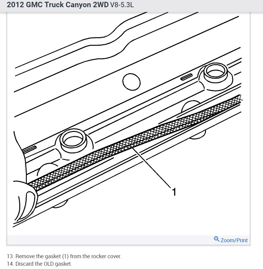

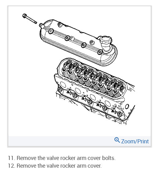

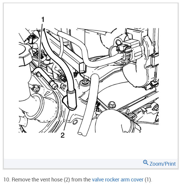

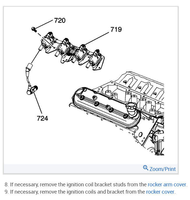

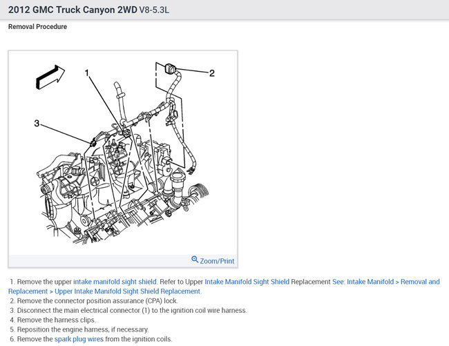

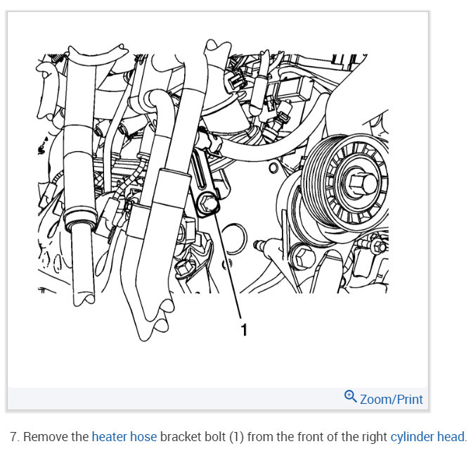

This sounds like the valve cover gaskets are leaking onto the exhaust manifold. Can you use a flashlight and check the valve cover gaskets to see if there are leaking? Here is a guide to help you see what you are in for when doing he job the car is different but the procedure is the same. Check out the diagrams below to see how the job is done on your car.
https://www.2carpros.com/articles/replace-valve-cover-gasket
