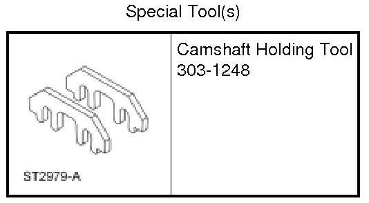

Special Tool(s)
pic 1

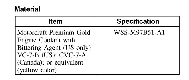

CAUTION: The engine cooling system is filled with Motorcraft Premium Gold Engine Coolant. Mixing coolant types degrades the corrosion protection of Motorcraft Premium Gold Engine Coolant.

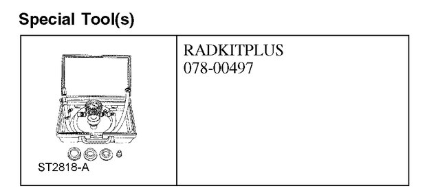

Filling and Bleeding with RADKITPLUS
1. Using the special tool, install the RADKITPLUS and follow the manufacturer's instructions to fill and bleed the cooling system.

^ Vehicle cooling systems are filled with Motorcraft Premium Gold Engine Coolant. Always fill the cooling system with the same coolant that is present in the system. Do not mix coolant types.
^ Do not add/mix orange-colored Motorcraft Specialty Orange Engine Coolant or equivalent, meeting Ford specification WSS-M97B44-D or green colored Premium Engine Coolant. Mixing coolants may degrade the coolant's corrosion protection.

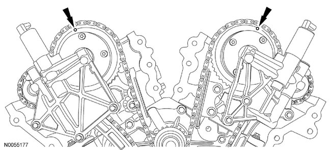

pic 3

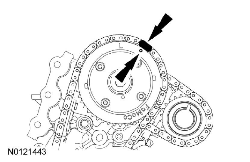

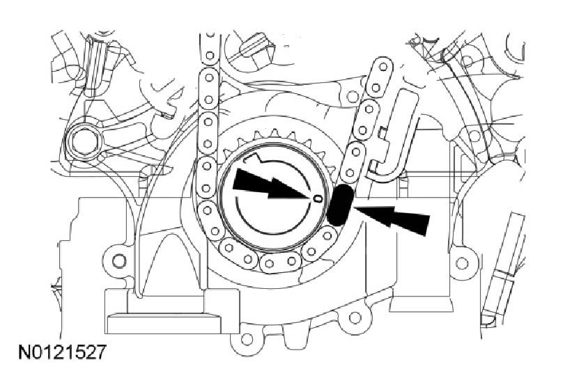

5. Rotate the crankshaft clockwise and align the timing marks on the Variable Camshaft Timing (VCT) assemblies as shown.

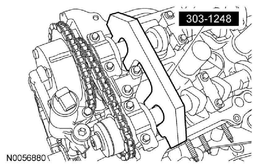

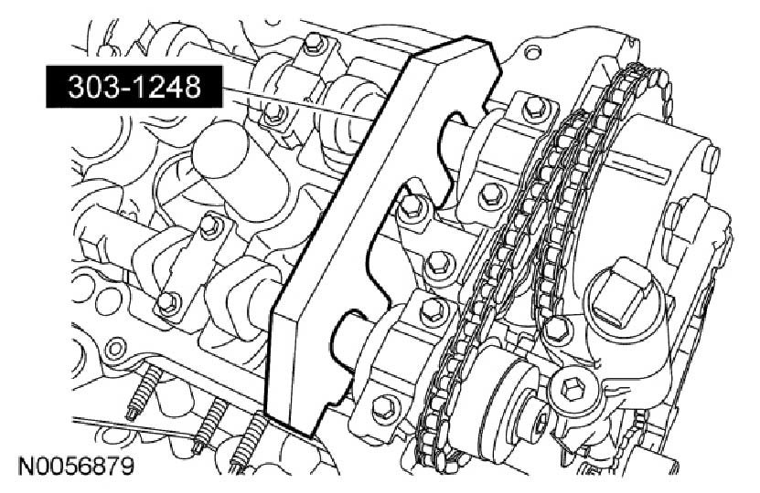

6. NOTE: The Camshaft Holding Tool will hold the camshafts in the Top Dead Center (TDC) position.
Install the Camshaft Holding Tool onto the flats of the LH camshafts.
pic 5

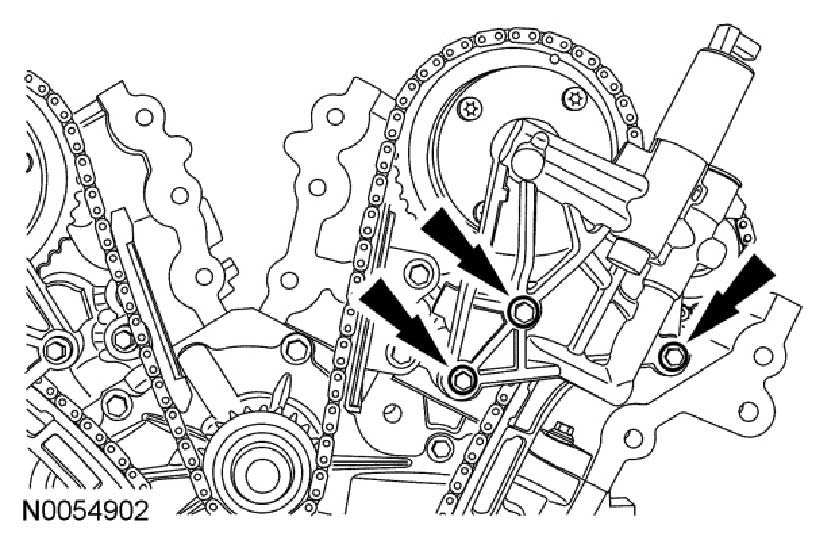

7. NOTE: The Camshaft Holding Tool will hold the camshafts in the TDC position.
Install the Camshaft Holding Tool onto the flats of the RH camshafts.

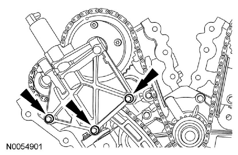

pic 6

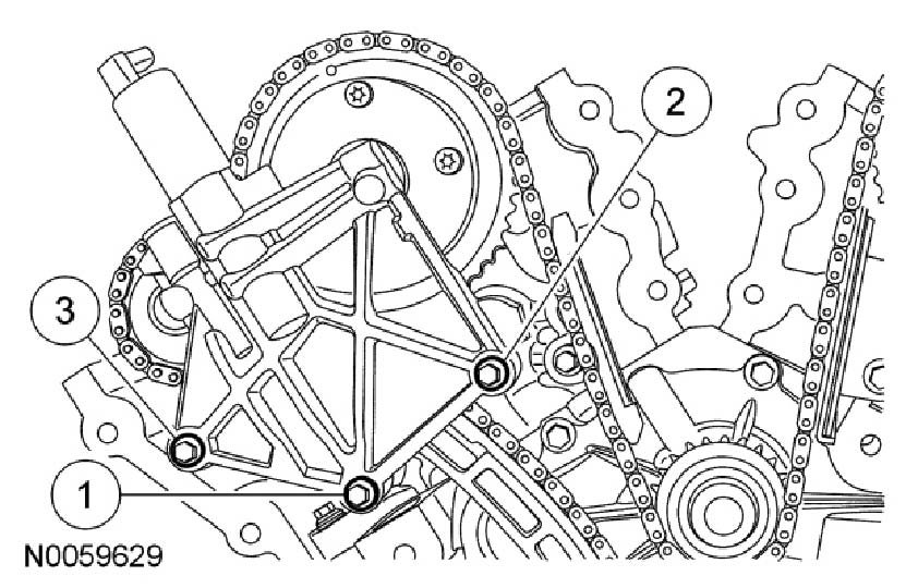

8. Remove the 3 bolts and the RH VCT housing.
pic 7

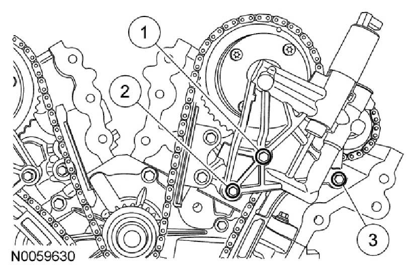

9. Remove the 3 bolts and the LH VCT housing.

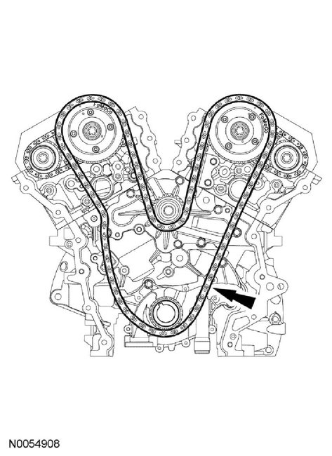

NOTE: The following 3 steps are for primary timing chains when the colored links are not visible.
pic 8

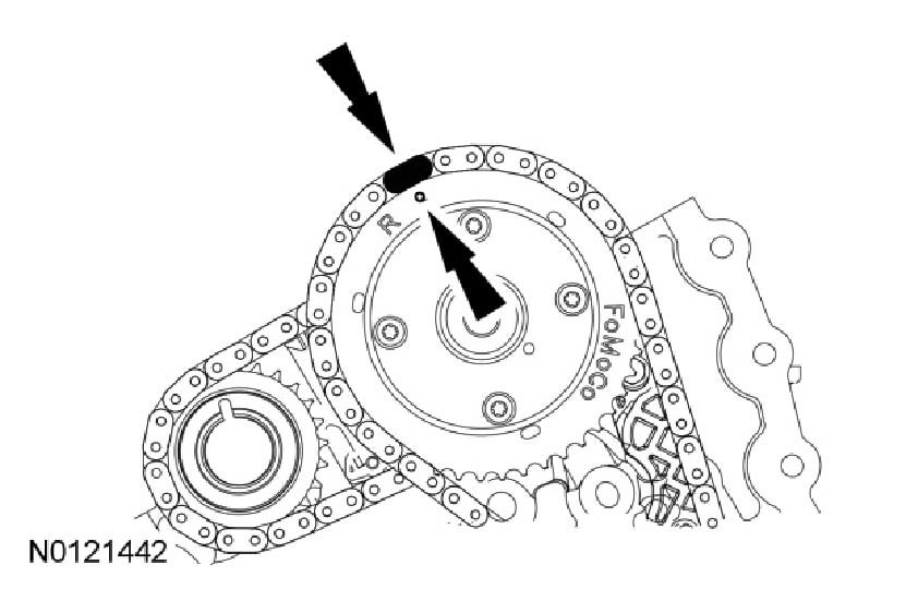

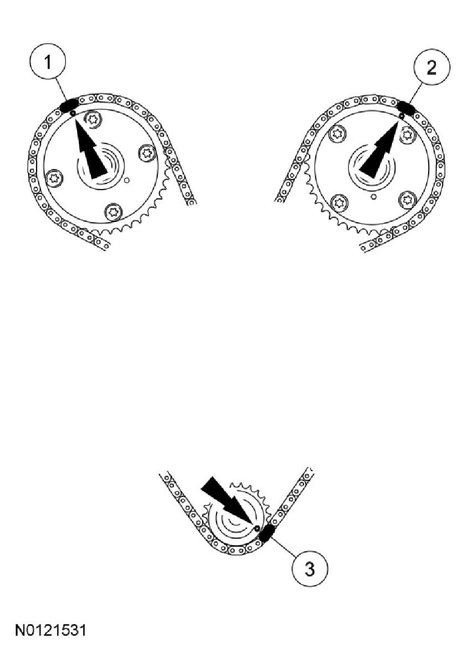

10. Mark the timing chain link that aligns with the timing mark on the RH intake VCT assembly as shown.
pic 9
11. Mark the timing chain link that aligns with the timing mark on the LH intake VCT assembly as shown.
pic 10
12. Mark the timing chain link that aligns with the timing mark on the crankshaft sprocket as shown.

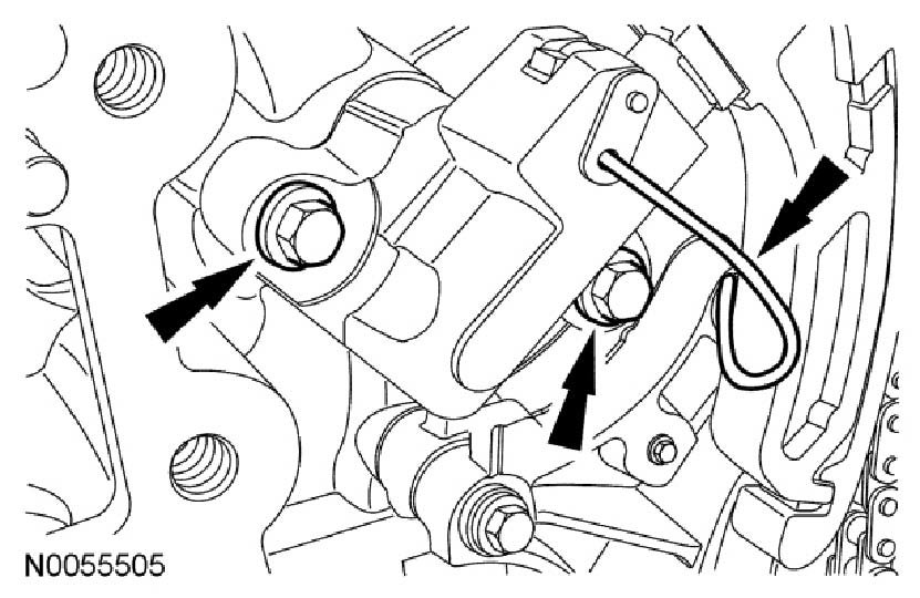

pic 11

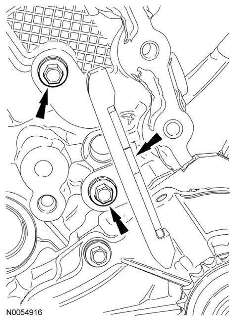

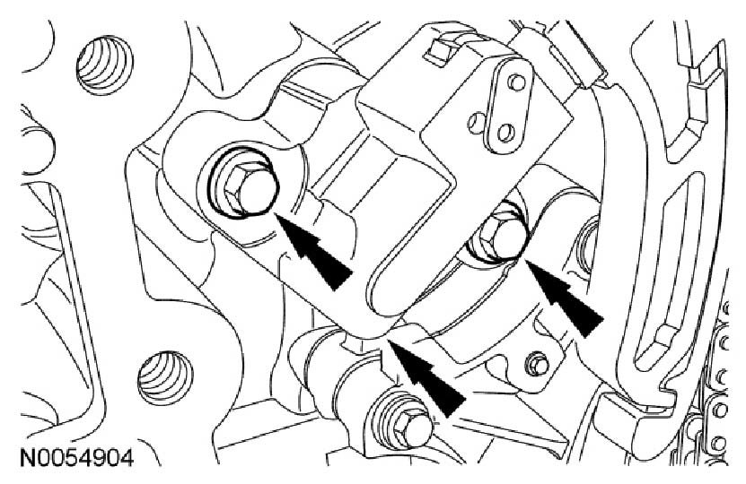

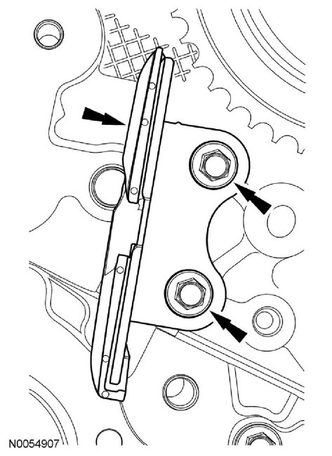

13. Remove the 2 bolts and the primary timing chain tensioner.
pic 12

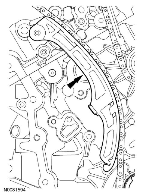

14. Remove the primary timing chain tensioner arm.
pic 13

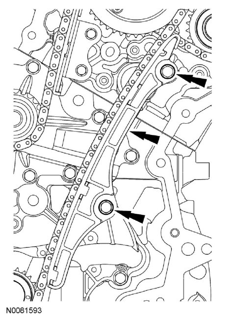

15. Remove the 2 bolts and the lower LH primary timing chain guide.
pic 14
16. Remove the primary timing chain.

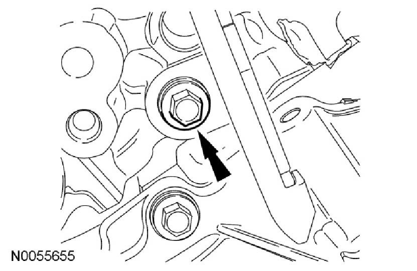

18. Remove the RH primary timing chain guide lower bolt.
pic 17
19. NOTE: The RH primary timing chain guide must be repositioned to allow the coolant pump to be removed.
Loosen the RH primary timing chain guide upper bolt.
- Rotate the guide and tighten the bolt.

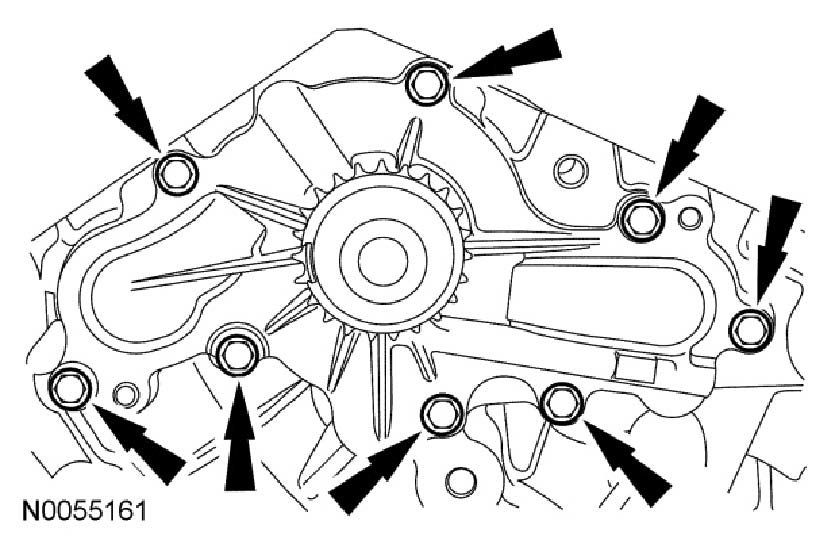

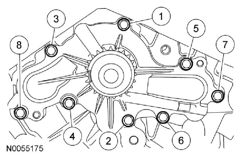

21. Remove the 8 bolts and the coolant pump.
Installation
pic 19
1. NOTE: Clean and inspect all sealing surfaces.
Install the coolant pump and the 8 bolts.
- Tighten in the sequence shown to 10 Nm (89 lb-in).

4. Loosen the RH primary timing chain guide upper bolt.
- Position the RH primary timing chain guide and install the lower bolt.
- Tighten the 2 bolts to 10 Nm (89 lb-in).

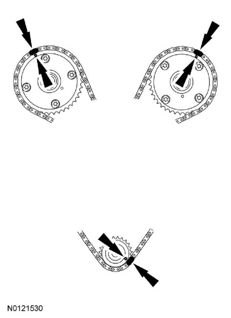

5. Install the primary timing chain with the colored links aligned with the timing marks on the VCT assemblies and the crankshaft sprocket.

8. Install the primary timing chain tensioner arm.

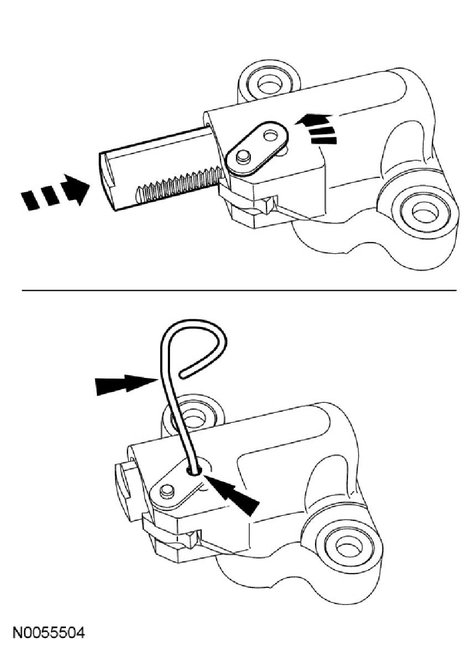

9. Reset the primary timing chain tensioner.
- Rotate the lever counterclockwise.
- Using a soft-jawed vise, compress the plunger.
- Align the hole in the lever with the hole in the tensioner housing.
- Install a suitable lock pin.

11. As a post-check, verify correct alignment of all timing marks.
- There are 38 links in between the RH intake VCT assembly colored link (1) and the LH intake VCT assembly colored link (2).
- There are 27 links in between LH intake VCT assembly colored link (2) and the crankshaft sprocket link (3).
