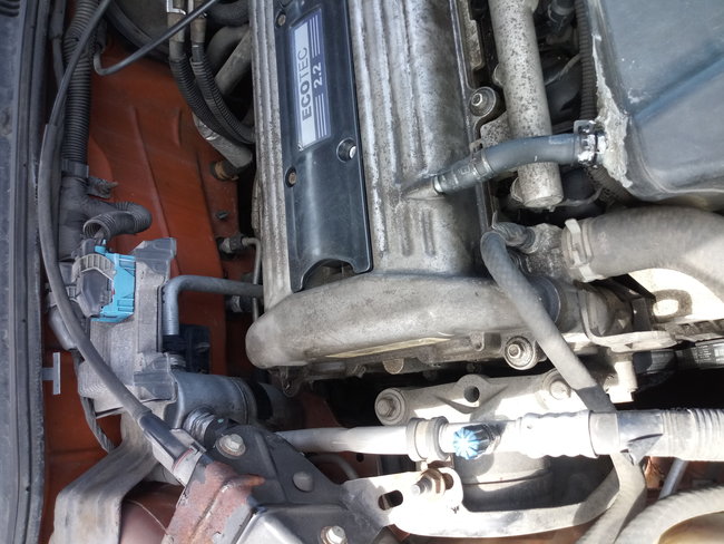

I looked but didn't see anything in that area. i also uploaded a picture.
May 22, 2021 at 11:17 AM

you need to remove the coil housing cover (the top piece).

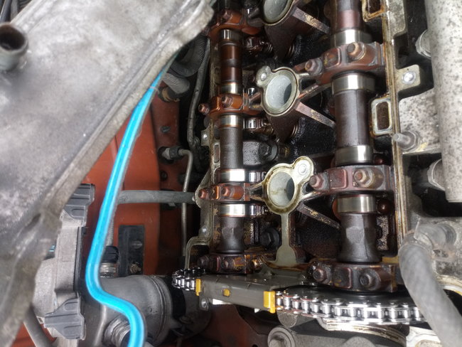

Still no luck unless i'm still in the wrong location. I added a photo so you can see what i'm looking at.

thanks. yep, it is not there. can you look toward the rear of the engine or send a pic please?

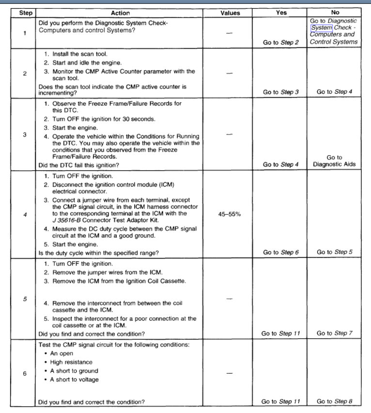

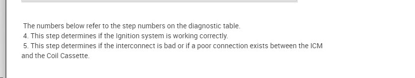

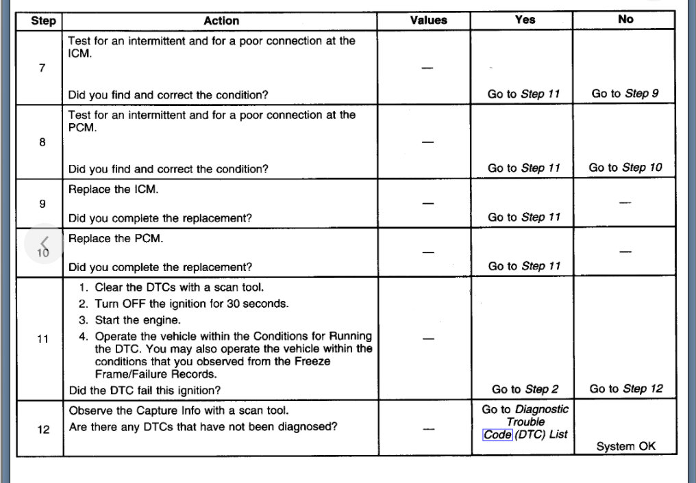

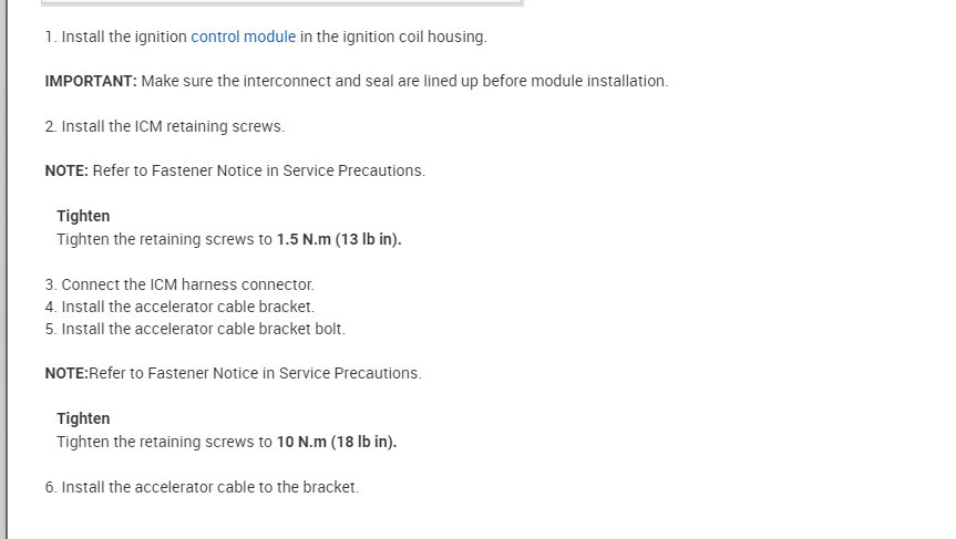

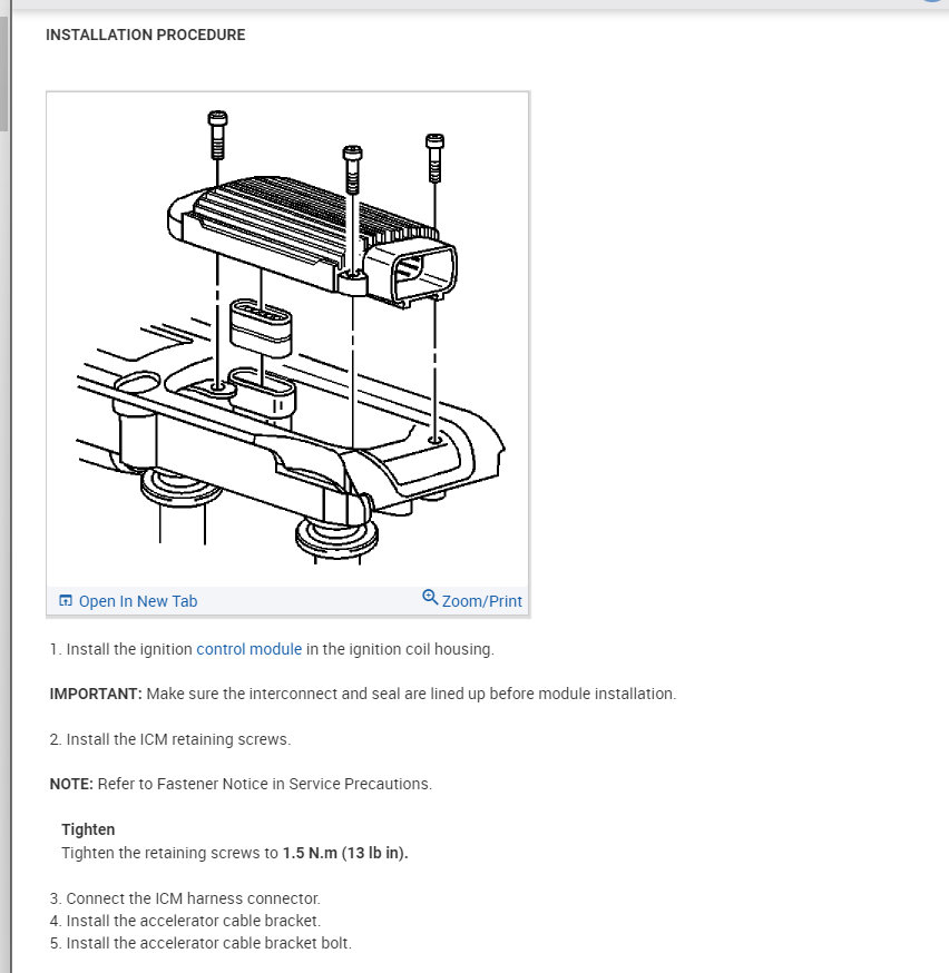

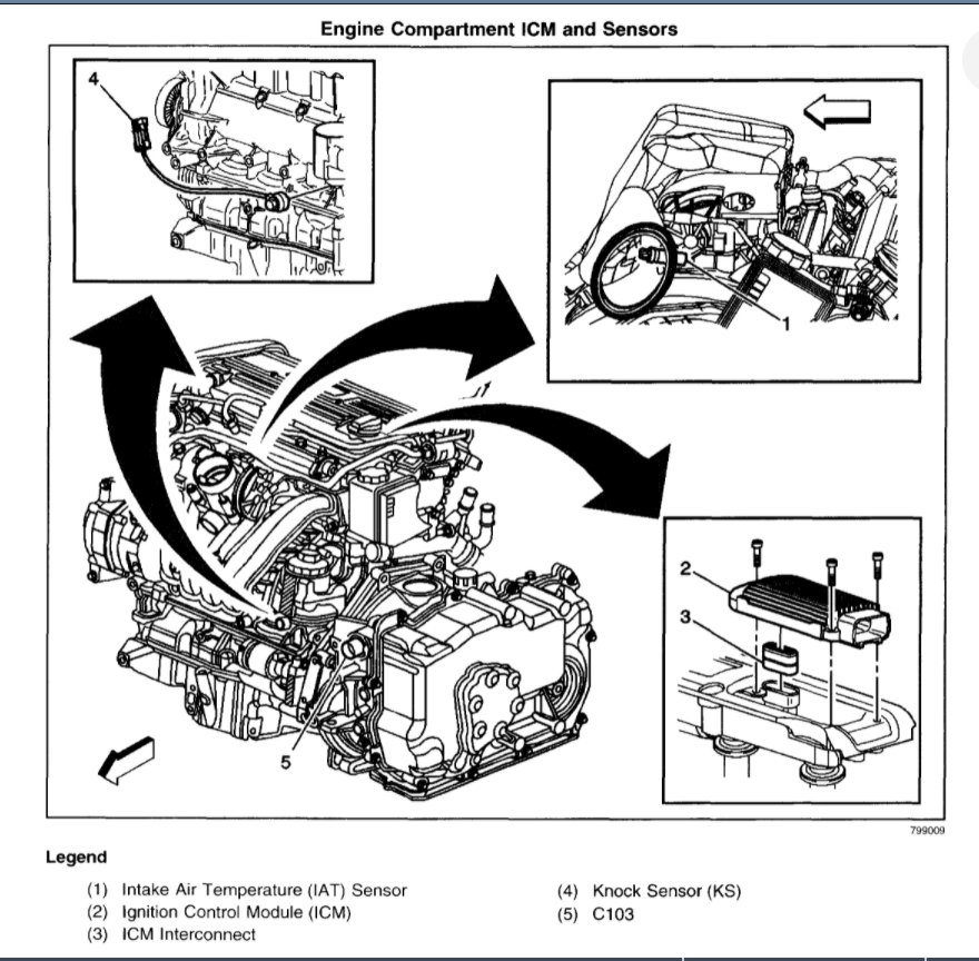

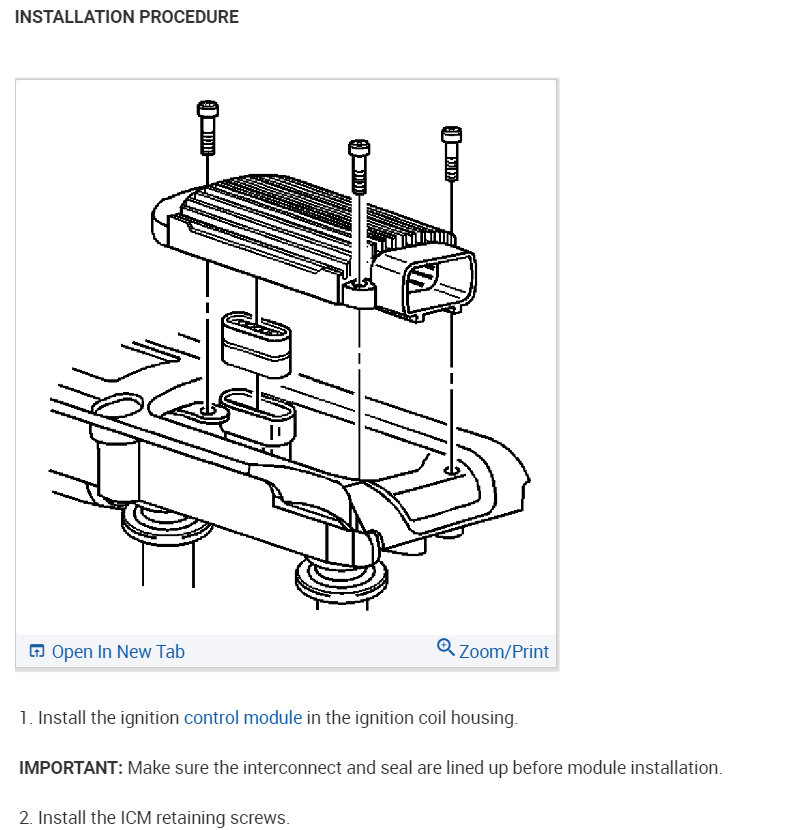

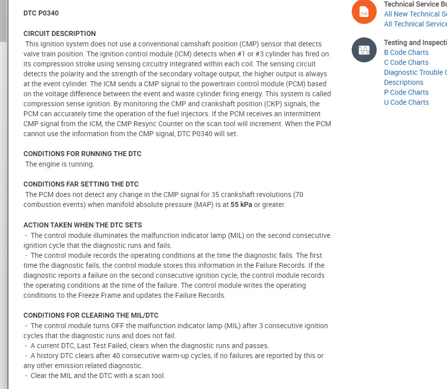

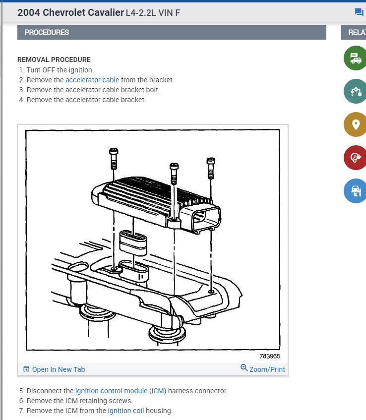

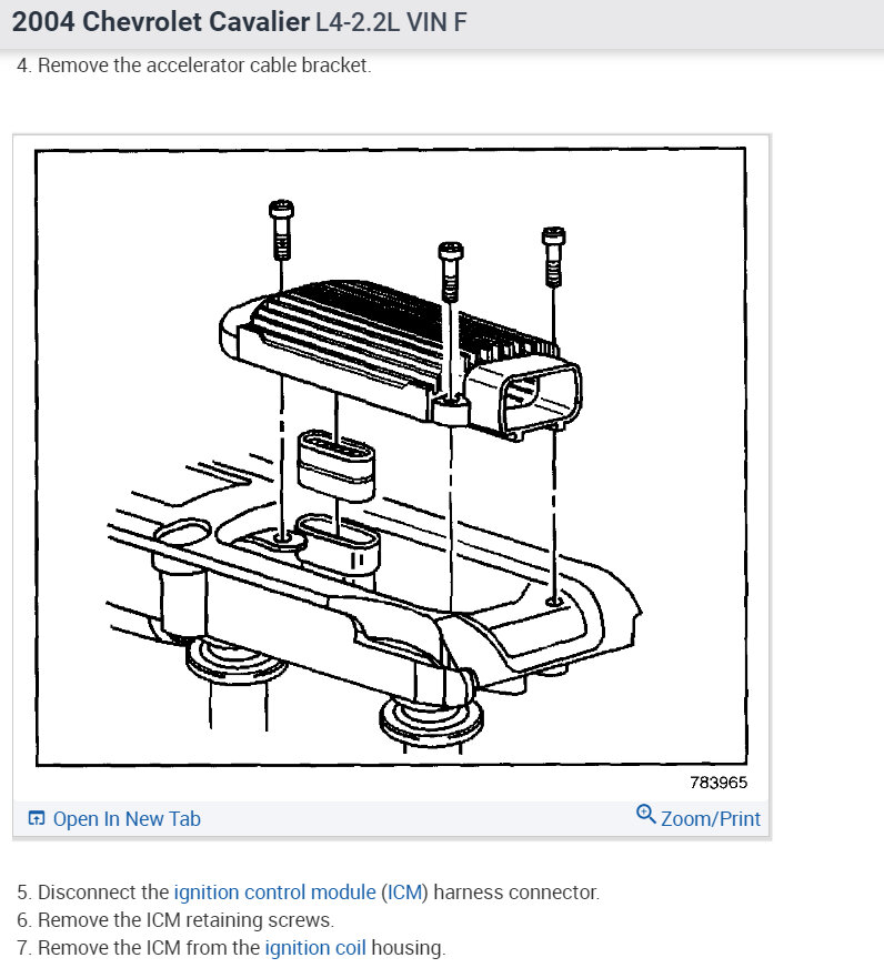

Just to jump in on this one. The CPS is part of the ignition control module on this engine.
I am attaching the info below on how to find this but also the testing for this code because it may not be the ICM as the issue.
So, I would suggest running through this test and see what results you come up with.
Let us know what questions you have.
