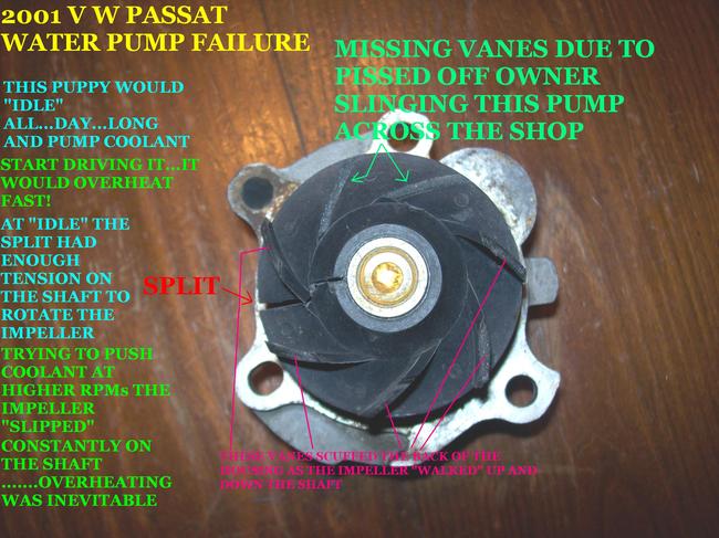

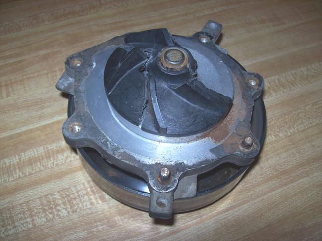

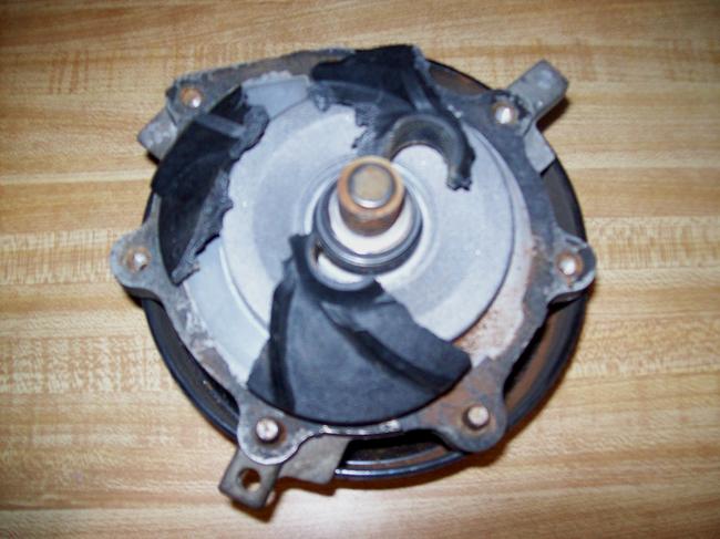

click on each of my pics
1) plastic impellers...gotta love 'em!
2) ford taurus
3) ford taurus (same one as above)....missing a piece........magic?....where could it have gone?
