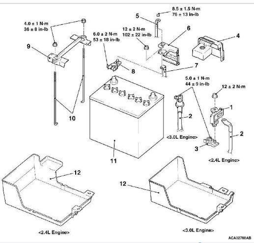

Yep, this sounds like a classic weak battery I would remove it and take it to an auto parts store for testing; to be sure can you upload a short video of the noise it is making? Here is a video that can help you as well:
https://www.youtube.com/watch?v=6YRW8fyNudY
Check out the images (below). Let us know how it goes
