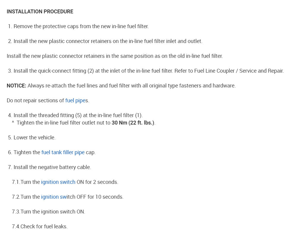

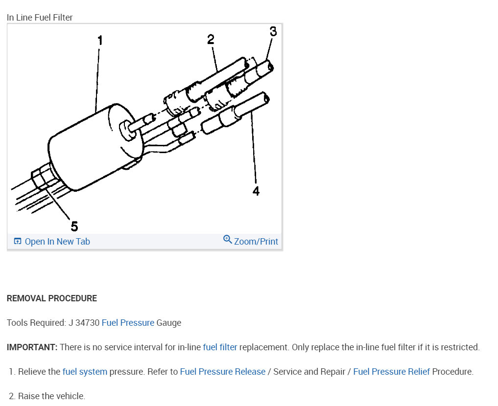

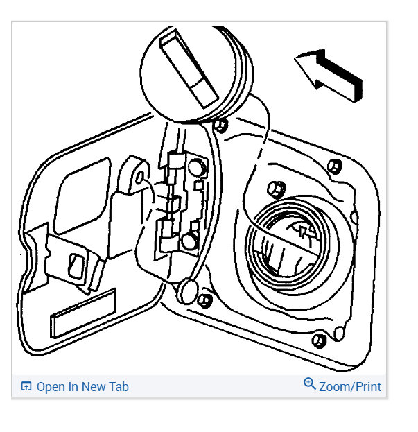

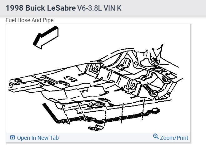

Yep, the fuel filter is the first stop on this type of problem. here are two guides to help us get started and I have included how to change the fuel filter out in your car in the images below:
https://www.2carpros.com/articles/how-to-change-a-fuel-filter
and
https://www.2carpros.com/articles/engine-has-low-power-output
Check out the images (below). Please let us know how it goes.
