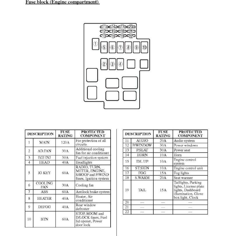

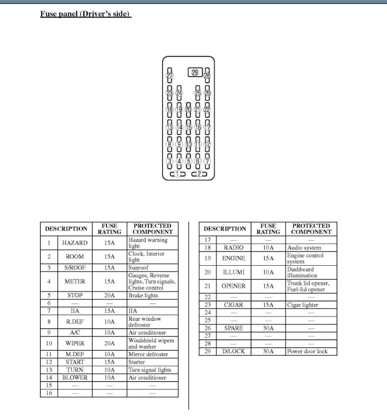

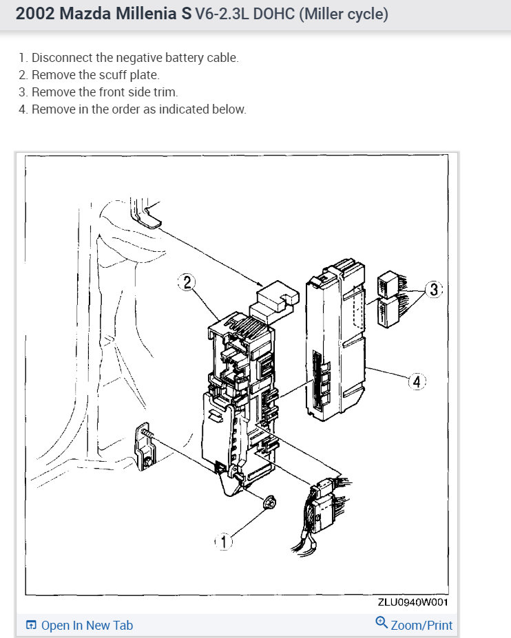

Please confirm the fuses are good here is a guide to help you with the fuse locations as well. If the fuses are good it sounds like the CPU has gone bad here are the replacement instructions and the location below.
CENTRAL PROCESSING UNIT (CPU) [ REMOVAL & INSTALLATION ]
Removal & Installation
Disconnect negative battery cable. Remove left side kick panel trim. Remove joint box mounting screws and remove joint box. Disconnect CPU electrical connectors. Separate CPU from joint box. To install, reverse removal procedure.
CENTRAL PROCESSING UNIT [ REMOVAL & INSTALLATION ]
Disconnect negative battery cable. Remove driver's side kick panel and scuff plate. Remove joint box mounting screws and remove joint box. Disconnect CPU electrical connectors. Separate CPU from joint box. To install, reverse removal procedure.
Central Processing Unit (CPU) On joint box. Check out the diagrams (Below). Please let us know what you find. We are interested to see what it is.
