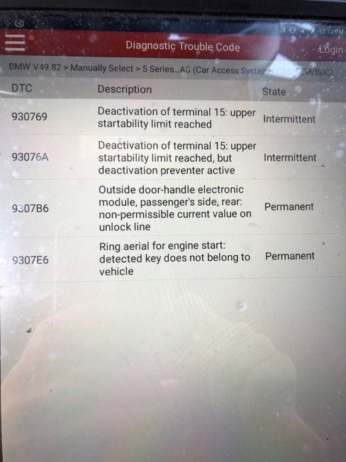

It is actually a 2011 550i, but that option wasn't available. I have some codes in the picture. The car came with 2 fobs, neither one unlock or lock or so anything, replaced both batteries and still nothing. Only one of them would start the car (push start) but you have to bring the fob close to the steering and keep trying to push the start hoping that they sync. Bought a new aftermarket fob and can't program it. Let me know if these codes mean anything to you

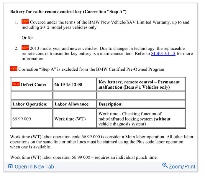

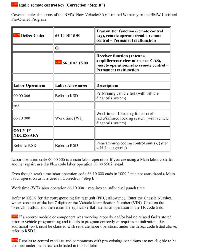

There is a bulletin on this issue. here it is:
SI B66 02 11
Distance Systems, Cruise Control, Remote Control
September 2014
Technical Service
This Service Information bulletin supersedes SI B66 02 11 dated February 2012.
[NEW] designates changes to this revision
SUBJECT
Remote Control and/or Comfort Access Functionality Is Inoperative
MODEL
All
Vehicles with remote control keys that have a replaceable battery
SITUATION
The radio remote control and Comfort Access functionality is inoperative:
^ The vehicle can only be unlocked or locked with the mechanical key.
^ The vehicle can only be started with the remote control key in the slot of the Car Access System (CAS) or when held very closely to the steering column.
CAUSE
The replaceable battery in the remote control key is either damaged or depleted.
CORRECTION
Step A:
A defective/depleted battery in the remote control key will mimic that no battery is installed in the remote control key; hence, no check control message will be displayed. This is why it is imperative to test the battery in the remote control key first.
Testing showed that even when performing diagnosis and following the test plan for the key battery charge/voltage status check offered in ISTA, a damaged/depleted key battery will not be recognized.
As a result, follow the recommendation below without performing a vehicle test:
1.Check the battery functionality by removing the original key battery in the key and install a known good key battery; or, even better, use a battery tester called state of charge (e.g., ZTS Multi-Battery Tester MBT-1) to test the key battery capacity
2.Retest the functionality of the remote control key.
3.When proper functionality is confirmed, replace the key batteries on all assigned remote control keys for the vehicle.
4.If proper functionality cannot be restored with a known good key battery, refer to Step B.
Note:
The average life cycle of a battery in the remote control key is approximately 3 years from the day of production of the vehicle.
More details on the ZTS Multi-Battery Tester MBT-1 can be found in Attachment_A and on the ZTS manufacturer website, www.ztsinc.com/mbt1.html.
Note:
The ZTS Multi-Battery Tester MBT-1 must be purchased through your center (e.g. from Amazon.com, SEARS, etc.). It will not be offered through BMW.
Step B:
Perform diagnosis using ISTA (Integrated Service Technical Application). Complete any test plans related to the radio remote control system.
Note:
If the remote control key must be replaced, swap the existing slide-in (mechanical) key into the new replacement remote control(s).
Important:
If the rearview mirror must be replaced (remote receiver is integrated) on a Convertible, please perform a visual check on the mirror to assure that the frequency of the remote receiver installed in the mirror is 315 MHz.

But all i have are those codes i sent you, the TSB doesn't really help my situation at all because i cannot determine what is faulty, all the codes would clear except for the (outside handle electronic on rear passenger) which says permanent. I very doubt that both fobs are just bad. The code for that trouble doesnt pull out anywhere?

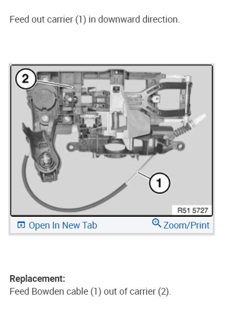

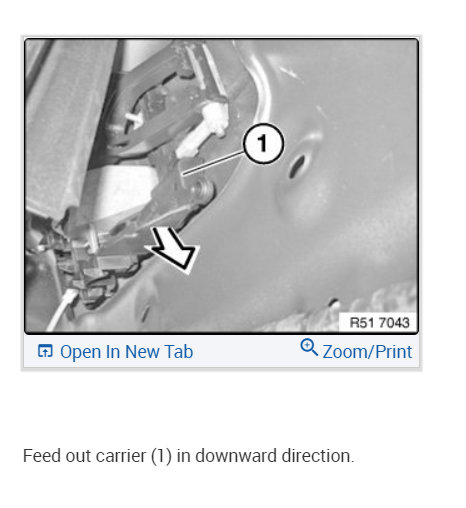

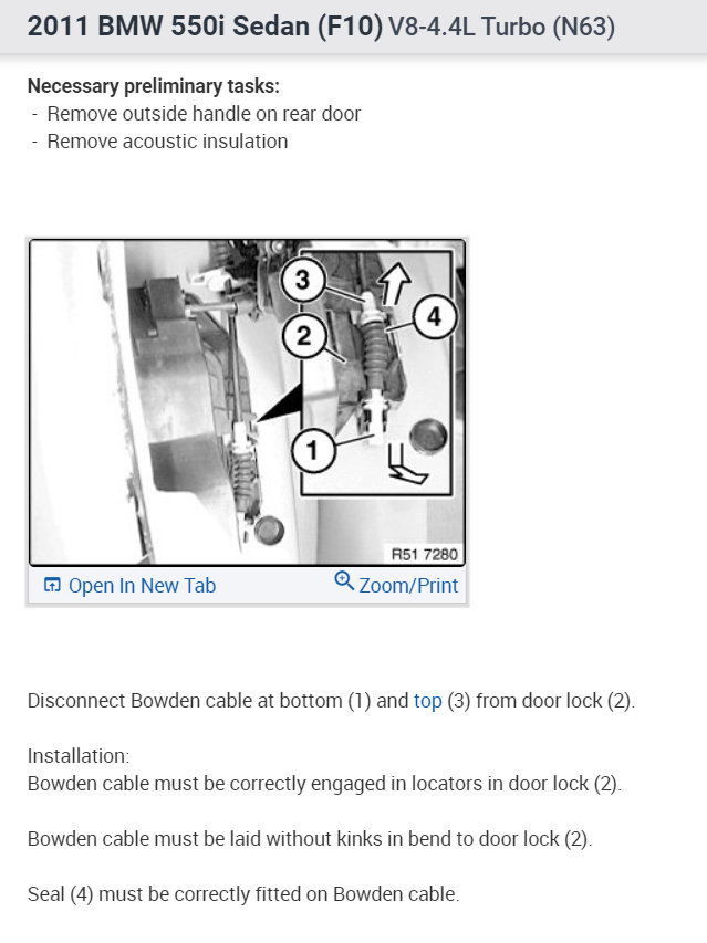

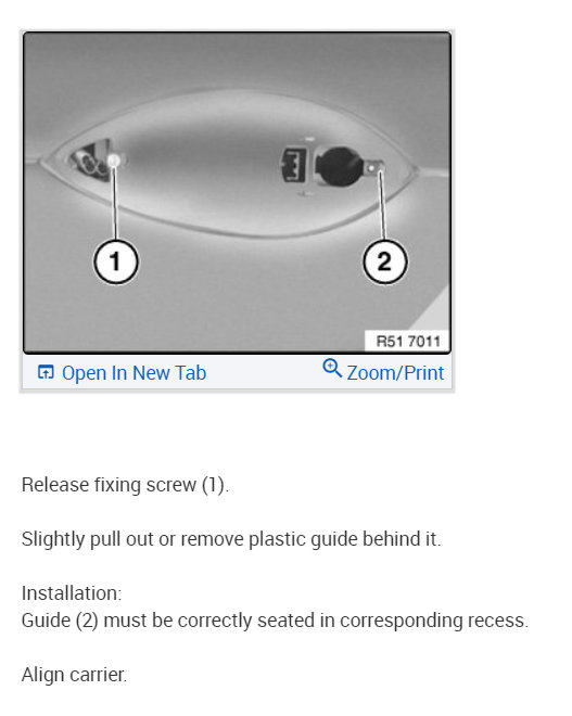

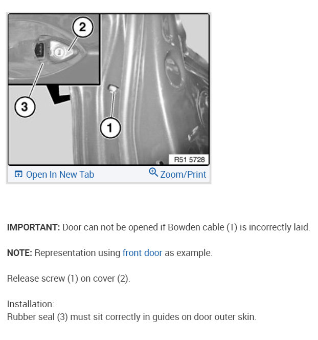

The permanent code I would after first here is how you replace the outside door handle. After replacing it clear the codes and let me know. Check out the diagrams (below). Please let us know what happens.

replaced it and deleted the code. I still cannot start the car without the fob is close to the ring for several seconds and several trials. I have another new fob I bought aftermarket, is there a way to program it since I already have the original? it also makes no sense that both original fobs are bad, both with new batteries.

The errors you posted show that the number of tries to start the vehicle with a bad or wrong fob has been exceeded, that will prevent it from starting on it's own. The door handle code is likely a switch in it, replace the handle to replace the switch. I have seen BMWs where a defective door handle will stop the car from starting.
Next you have a ring code, that is the ring antenna that sees the RFID tag in the fob, it shows that at least one of the fobs you have isn't programmed in, likely both are not as they don't work. The only way to program them is using a scan tool or a key programmer. Many times a locksmith can do that, however in your case you may need to replace the door handle first. Both a dealer and a locksmith can possibly test the fobs to be sure they work and are in the correct range to work with your car.
