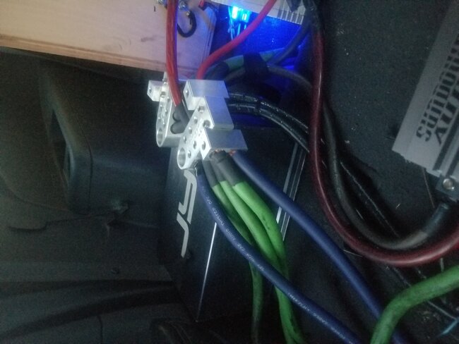

This vehicle has 16 grounds in total mixed with 1/0 and 4/0 cables, and duel runs of power of 1/0 from alt stud to back, and 4 power runs and grounds linking each battery using bus bars. I have triple checked all connections, made sure voltage reads the same from front to back. No resistance in the grounds.

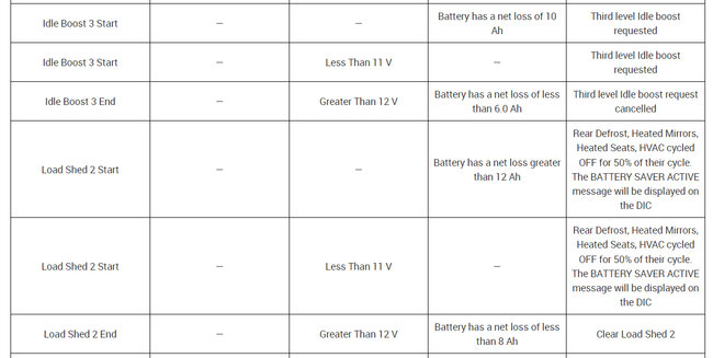

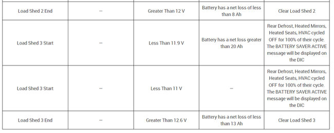

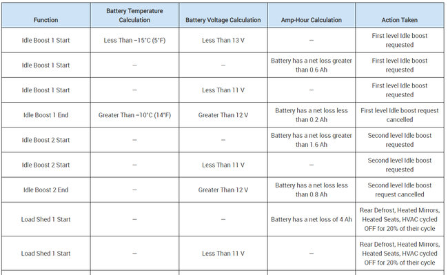

For example, idle boost 1 must be active before idle boost 2 can be active. The criteria used by the body control module (BCM) to regulate electrical power management are outlined below:

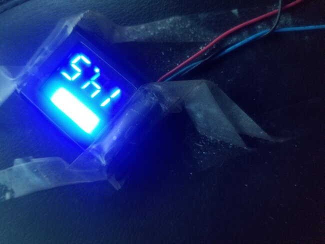

Thanks for your time and your inputs, means a lot to me, especially when I don't have anywhere else to really turn! (: In the photo I'm holding 14.5 after cars been running for 15 minutes now. Compared to how it was 2 days ago, it's not dropping anymore. When it did it was from the heavy bass in idle, dropped hard, didn't regain. Restart the car, see 14.8 then starts dropping to 13.2. Now the car goes to 15.2v cold start, settles at 14.5 14.6 as it should. I do'nt know what happened, I guess the system relearned the chemistry.

I have 2 of these I know, looks like wires everywhere, So many wires, lol.
