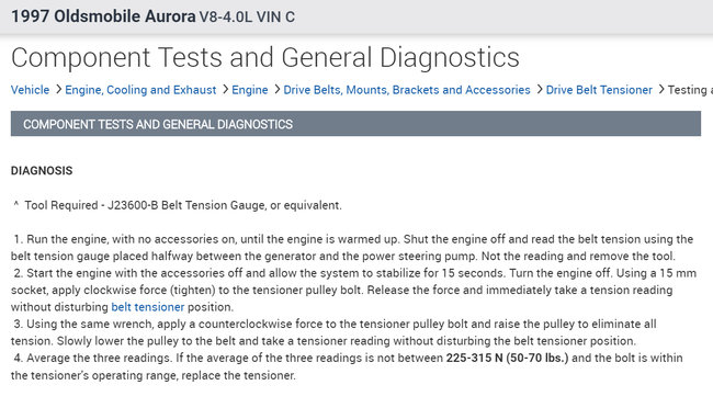

Okay, this could be a problem with the serpentine belt tensioner. In the diagrams down below I have included the factory guidelines for testing and inspection of your vehicle's serpentine belt tensioner. Please go through the guide and get back to us with what you are able to find out.
Thanks,
Alex
2CarPros
Jun 24, 2019 at 2:27 AM

According to my mechanic, when he changed the belt he also checked the tensioner and it was fine. As for what Caradiodoc said, the battery isn't old. It was bought new a couple of months before my son bought the car which wasn't too long ago.

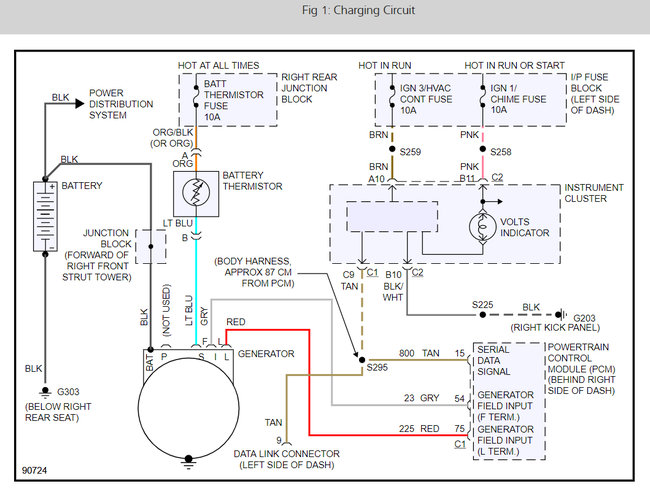

I have seen the instrument cluster cause this problem. here is a wiring diagram to show you how the system works and a video that how the cluster being replaced in a similar car:
https://youtu.be/_HEC44xENxw
Check out the diagrams (Below). Please let us know what happens.
Jun 29, 2019 at 5:23 PM

Can we check to see if the alternator is working? here is a guide. The battery light is run through the cluster and can go bad leaving the battery light on.
Jun 30, 2019 at 9:58 AM
