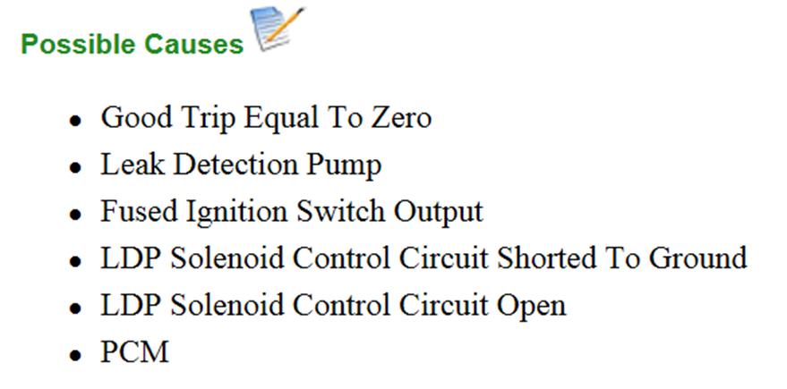

First fualt code retried was P1495 which EVAP Leak Detection Pump Solenoid Circuit Condition. I am told that the possible causes are the following: - Faulty Leak Detection Pump (LDP)
- Leak Detection Pump (LDP) harness is open or shorted
- Leak Detection Pump (LDP) poor electrical connection
How do I trouble shoot further? What can be the cause of the and what is the recommended solution.
A local technician advised that the alternator is regulated by the PCM and has advised that my PCM is faulty. He wanted to bypass the PCM to make the alternator charge properly again. What do you idvise???
