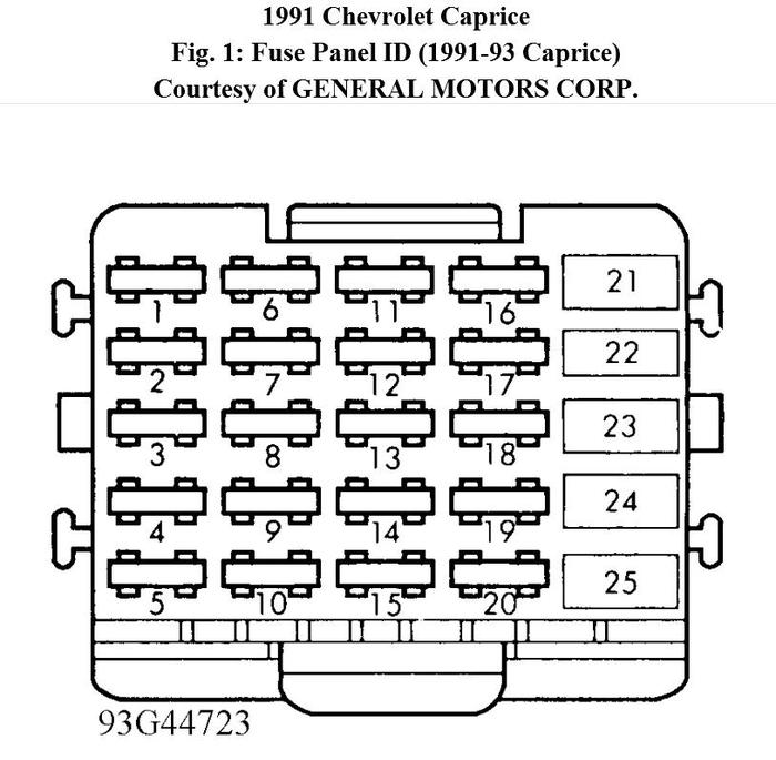

I bought a 1993 Chevy Caprice without an owner's manual and need to check fuses to heater blower motor and rear defrost, but have no idea of their location on the fuse panel. Can you help?
Dec 26, 2008 at 9:52 AM

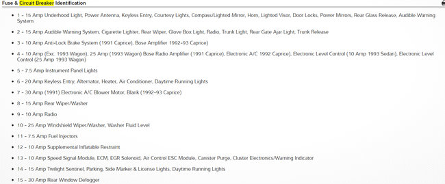

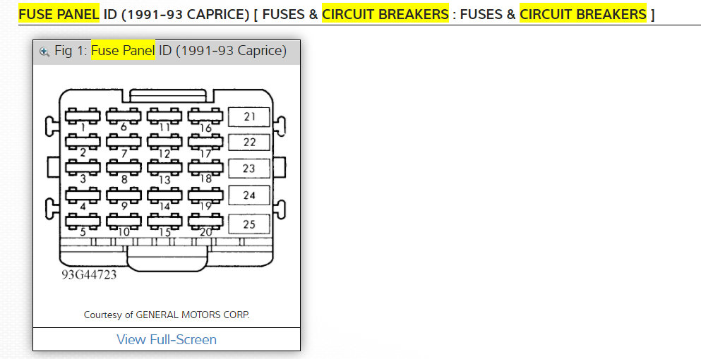

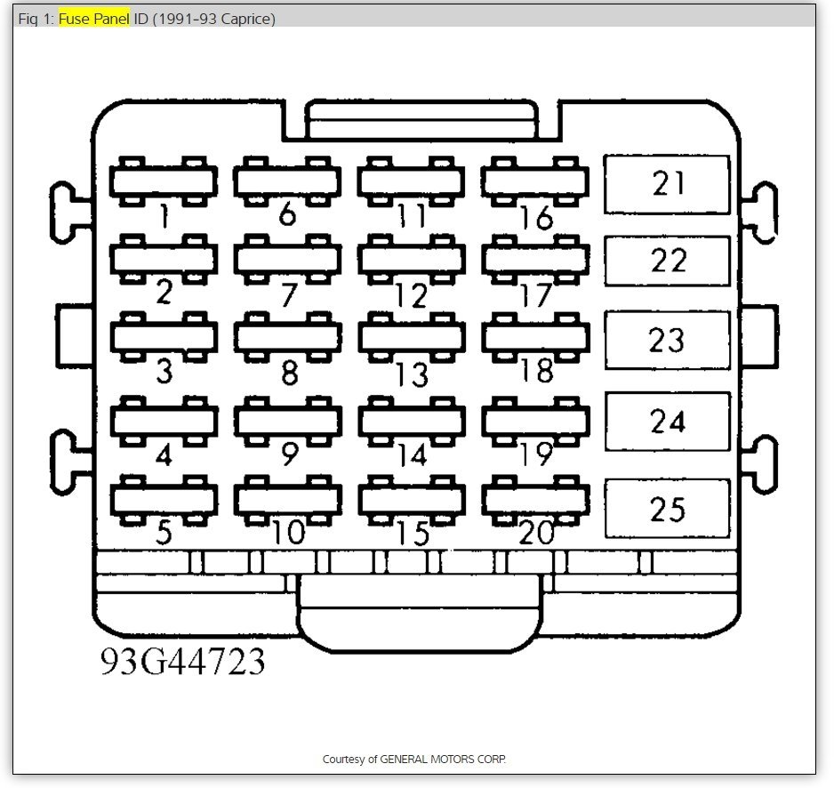

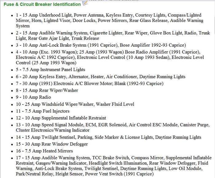

Here is the complete fuse panel and descriptions. (BELOW)
1 - 15 Amp Underhood Light, Power Antenna, Keyless Entry, Courtesy Lights, Compass/Lighted Mirror, Horn, Lighted Visor, Door Locks, Power Mirrors, Rear Glass Release, Audible Warning System
2 - 15 Amp Audible Warning System, Cigarette Lighter, Rear Wiper, Glove Box Light, Radio, Trunk Light, Rear Gate Ajar Light, Trunk Release
3 - 10 Amp Anti-Lock Brake System (1991 Caprice), Bose Amplifier 1992-93 Caprice)
4 - 10 Amp (Exc. 1993 Wagon); 25 Amp (1993 Wagon) Bose Radio Amplifier (1991 Caprice), Electronic A/C 1992 Caprice), Electronic Level Control (10 Amp 1993 Sedan), Electronic Level Control (25 Amp 1993 Wagon)
5 - 7.5 Amp Instrument Panel Lights
6 - 20 Amp Keyless Entry, Alternator, Heater, Air Conditioner, Daytime Running Lights
7 - 30 Amp (1991) Electronic A/C Blower Motor; Blank (1992-93 Caprice)
8 - 15 Amp Rear Wiper/Washer
9 - 10 Amp Radio
10 - 25 Amp Windshield Wiper/Washer, Washer Fluid Level
11 - 7.5 Amp Fuel Injectors
12 - 10 Amp Supplemental Inflatable Restraint
13 - 10 Amp Speed Signal Module, ECM, EGR Solenoid, Air Control ESC Module, Canister Purge, Cluster Electronics/Warning Indicator
14 - 15 Amp Twilight Sentinel, Parking, Side Marker & License Lights, Daytime Running Lights
15 - 30 Amp Rear Window Defogger
16 - 7.5 Amp Heated Mirrors

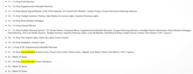

17 - 15 Amp Audible Warning System, TCC Brake Switch, Compass Mirror, Supplemental Inflatable Restraint, Gauges/Warning Indicator, Headlight Switch Illumination, Rear Window Defogger, Fluid Warning, Anti-Lock Brake System, Twilight Sentinel, Daytime Running Lights, Low Oil Module, Park/Neutral Relay, Height Sensor, Power Vent Switch (1991 Caprice)

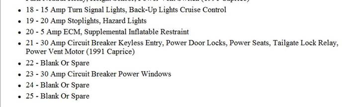

18 - 15 Amp Turn Signal Lights, Back-Up Lights Cruise Control
19 - 20 Amp Stoplights, Hazard Lights
20 - 5 Amp ECM, Supplemental Inflatable Restraint
21 - 30 Amp Circuit Breaker Keyless Entry, Power Door Locks, Power Seats, Tailgate Lock Relay, Power Vent Motor (1991 Caprice)
22 - Blank Or Spare
23 - 30 Amp Circuit Breaker Power Windows
24 - Blank Or Spare
25 - Blank Or Spare

I Have A 1992 Caprice with no Owners Manual would Like to have a diagram Of Its Fuse Box Thank U
Apr 22, 2017 at 11:26 AM (Merged)
RASMATAZ
  • 75,992 POSTS

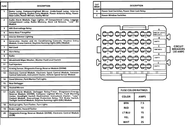

There you go
https://www.2carpros.com/forum/automotive_pictures/12900_fuse_block_5.jpg
https://www.2carpros.com/forum/automotive_pictures/12900_f1_9.jpg
https://www.2carpros.com/forum/automotive_pictures/12900_f2_8.jpg
https://www.2carpros.com/forum/automotive_pictures/12900_f3_4.jpg

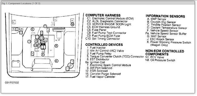

Here is a guide to help you check the fuses
and check the wiring for connection to ground using this guide.
Here are the fuse panel and engine wiring diagrams
