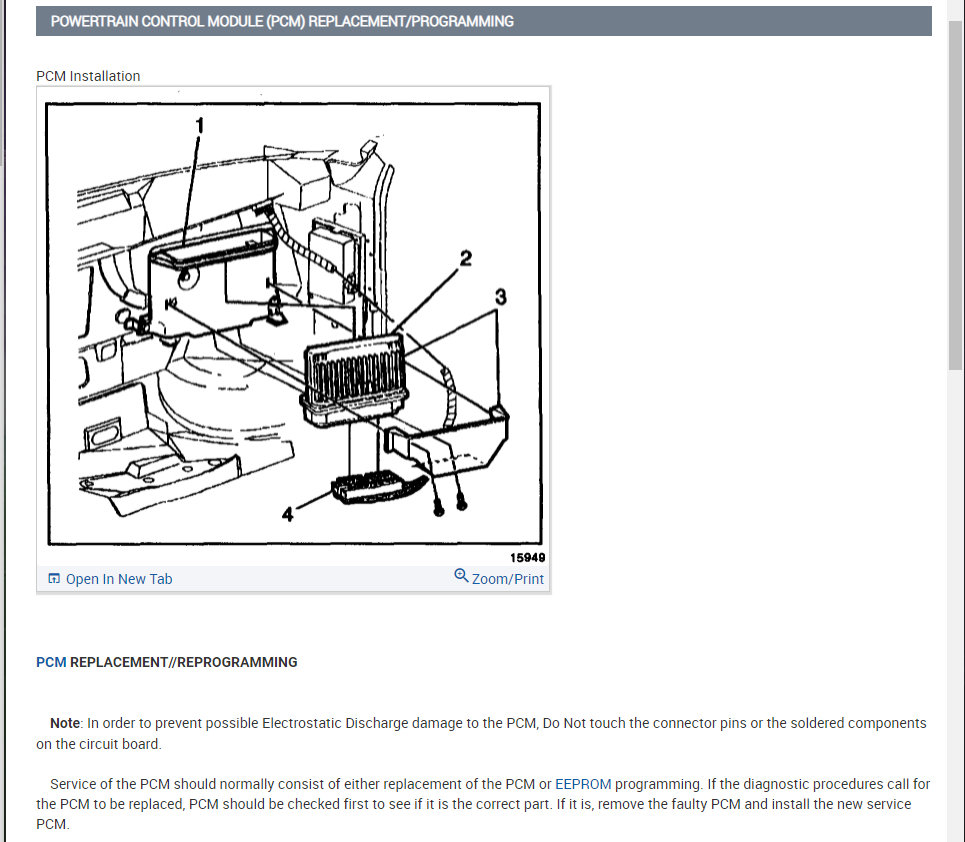

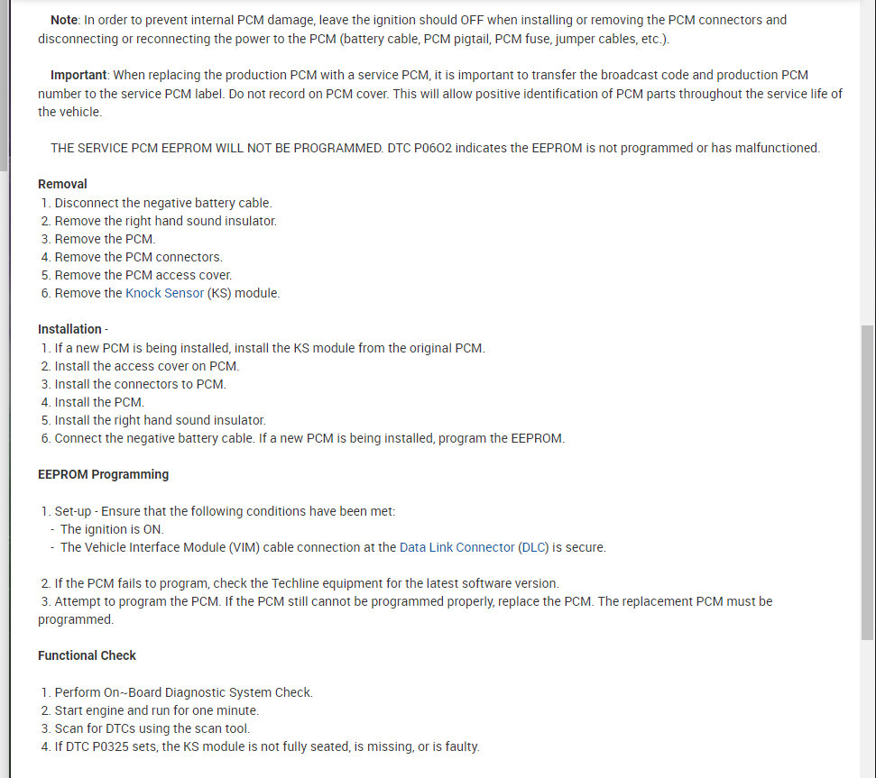

Please see the info below on how to replace the PCM. Let us know if you have other questions.
