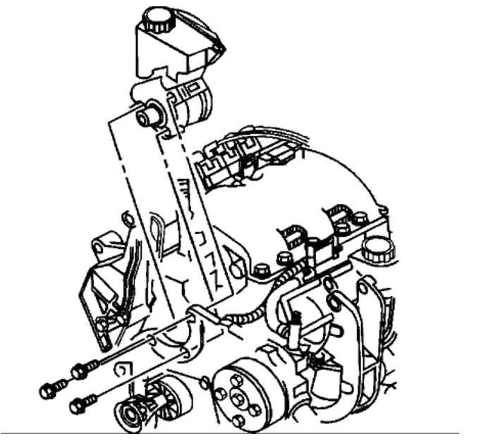

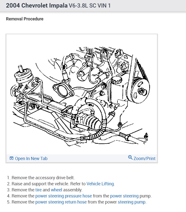

How to change a power steering pump? Where is the pump located under the hood of the car?
Jun 22, 2009 at 9:31 AM
BLUELIGHTNIN6
  • 16,542 POSTS
You must remove the serpentine belt to start and disconnect the battery. Here is a guide and a video to help you get the job done:
https://youtu.be/MtHG4y_rdMI
and
https://www.2carpros.com/articles/how-to-replace-a-power-steering-pump
Check out the diagrams (below).
Cheers

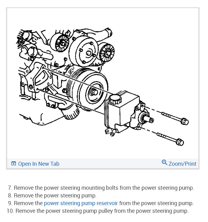

I have the power steering pump and was wondering if i need any special tools to get the pulley off or if i can do the change of a new power steering pump with general tools? I was just wondering if there was any specific tools that i needed to get before i started to tear it apart?
Apr 28, 2018 at 3:11 PM (Merged)
HMAC300
  • 48,601 POSTS
Yes, you need a pulley remover and installer. See if auto parts rent it.

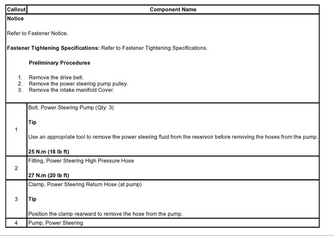

MDYKES3948
  • 4 POSTS
Six cylinder two wheel drive automatic 69,000 miles.
I have remove belt and the three bolts and lines. Pump is loose but will not come out. Do I have to take more off the motor?
FACTORYJACK
  • 4,159 POSTS
It looks like in either V6 configuration, it calls for pump pulley removal as one of the initial steps in removal. It does not say why, and the illustration is not detailed enough to show any reason. Removal of the pulley requires a special tool, a power steering pump pulley removal tool. It may be available at a rental store, or a parts store that rents tools. I would imagine it is a fairly common tool requested.
MDYKES3948
  • 4 POSTS
There is no room to put a puller.
FACTORYJACK
  • 4,159 POSTS
What type of puller are you using? a power steering pulley puller is not very large.
MDYKES3948
  • 4 POSTS
Thanks for your help last night. I got it replaced but need belt diagram. can you help?

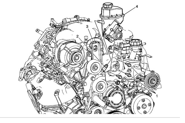

TCHAMPAGNE
I just replaced power steering pump on my 2006 Impala. It is still making the whining noise and foaming in reservoir. I jacked up the car and moved steering wheel side to side hoping to rid air out of the system. after considerable amount of time it has not changed anything and i am afraid of damaging the new pump. Any suggestions? PS. It is making the same noise it was before replacing the pump.
It sounds like you have a defective pump that is pulling in air which makes the fluid have air in it and the noise will never go away until you redo the pump. May I suggest an AC Delco pump.
Here is a guide to show you what you are in for when doing the job:
and you should flush the system.
https://www.2carpros.com/articles/power-steering-fluid-flush
Here are some diagrams that shows how it will be on your car (below).

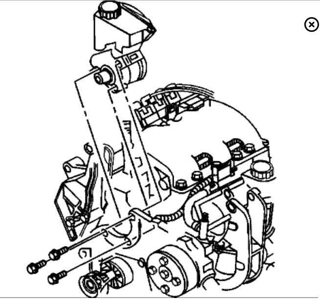

LDMANECKE
I need to replace/repair the power steering fluid reservoir after an incident involving the serpentine belt and disintegration of the idler pulley. There is a pen tip sized hole in the reservoir where fluid is leaking out. How do I, or CAN I, remove the power steering fluid reservoir?
Feb 13, 2019 at 10:57 AM (Merged)
HMAC300
  • 48,601 POSTS
Here is a guide to help walk you through the steps of changing the power steering pump with diagrams below to show you how on your car.

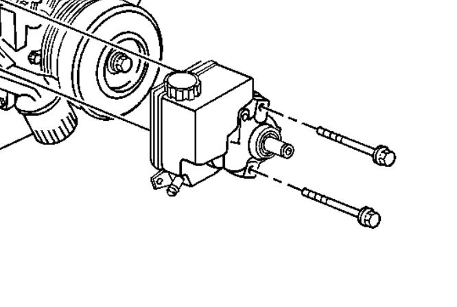

MSHERMAN
whats the easyest way to change a power steering pump
BLUELIGHTNIN6
  • 16,542 POSTS
https://www.2carpros.com/forum/automotive_pictures/261618_Noname_2734.jpg
https://www.2carpros.com/forum/automotive_pictures/261618_Noname2_889.jpg
LEGALINDA
How do you remove a power steering pump from a 2000 Impala? Mine is leaking and I can't figure out where it is leaking from. Any help would be greatly appreciated.
DENNYP
  • 1,824 POSTS
remove the belt, remove the two hoses from the pump, remove the bolts that hold the pump to the engine, remove the pump.
