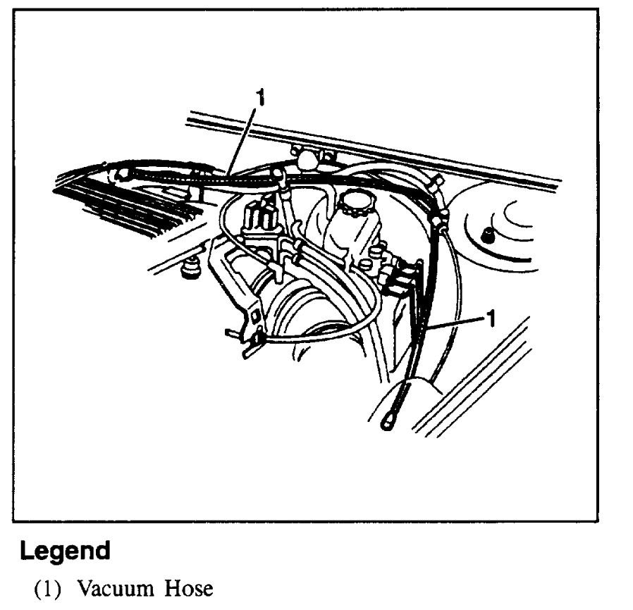

Usually defrost only is a sign of a loss of vacuum to the controller. I would start under the hood and verify the source hose is attached and doesn't have any breaks in it. They are usually plastic and can break from age
Here is a guide to read, it will help you figure out what is going on
https://www.2carpros.com/articles/air-vents-stay-in-the-defrost-position
See the diagram below for location of source hose
