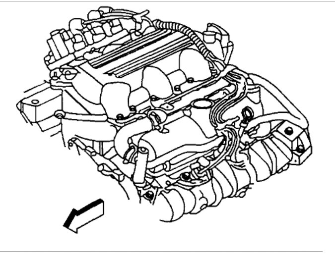

Here is a guide that will help you get the job done, though the rear plugs are a little tough but hang in there and you can get it done. Here is a guide that will help you get started.
https://www.2carpros.com/articles/how-to-change-spark-plugs
REMOVAL PROCEDURE
Turn the ignition key OFF.
Remove foreign material from around the spark plug holes.
Remove the spark plug using a spark plug socket.
INSTALLATION PROCEDURE
Adjust the spark plug gap. Use a round wire type spark plug gap gauge. While gapping the plug be sure to keep the platinum pads aligned to ensure maximum plug life.
Install new plugs and tighten properly.
Reapply dielectric lubricant to the insulator boot.
Tighten
Tighten to 19 N.m (14 lb ft) .
Diagram (below)
"I have seen my mechanic roll the engine forward by undoing the strut engine mount and moving the car forward while the transmission is in park.
