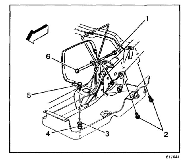

Here is what it will be like on your truck (below)
Tighten the fuel tank shield bolts (2) to 11 N.m (97 lb in) .
Tighten the fuel tank shield nut (4) to 25 N.m (18 lb ft) .
Install the fuel tank shield to crossmember bolts (1) and nuts (6).
Tighten the fuel tank shield bolts and nuts to 23 N.m (17 lb ft) .
