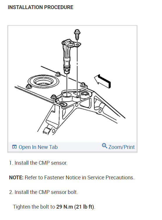

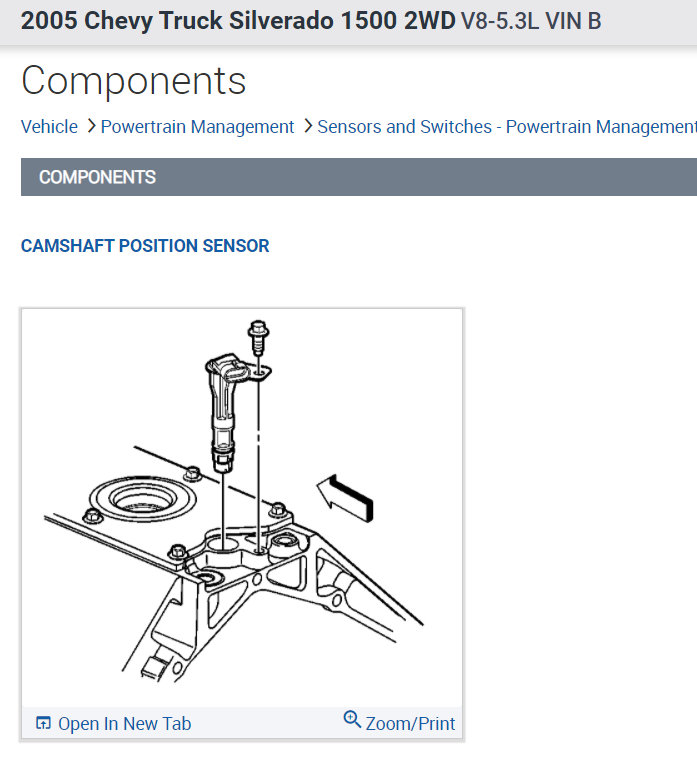

I am having trouble starting my truck. Finally logged a P0342 code calling out cam sensor. Where is it located and how do I replace it? Can I test it beofre buying the new part? Ohm test?
Jan 25, 2010 at 5:46 PM
SCOTTY DEE
  • 592 POSTS
You are going to need a scan tool to read parameter identification. Also will need to disconnect the sensor a verify 12 volt reference. If there are no short to grounds, or other wiring issues and no debris between the sensor and the reluctor ring, you could have a bad CMP sensor or in the worst case a bad PCM. The sensor is located behind the #2 knock sensor on top of the lower plenum.Here is the location of the camshaft sensor in the diagrams below. Check out the diagrams (Below). Please let us know what happens.
