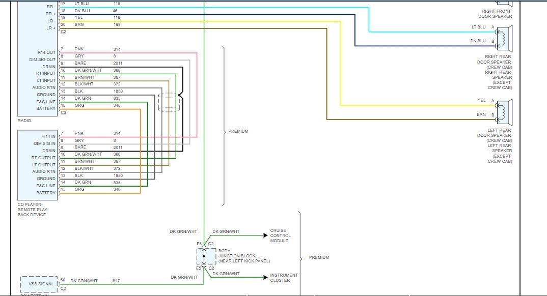

Good morning.
This sounds like the radio itself is the issue. I doubt it is the speaker at all. It is what is coming out of the radio or what is not coming out of the radio.
I would check the connector at the back of the radio to be sure the connection is tight and clean.

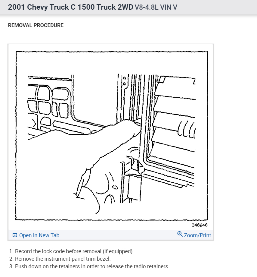

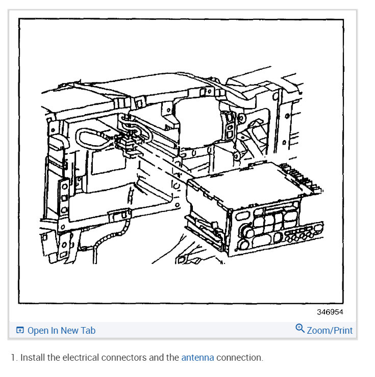

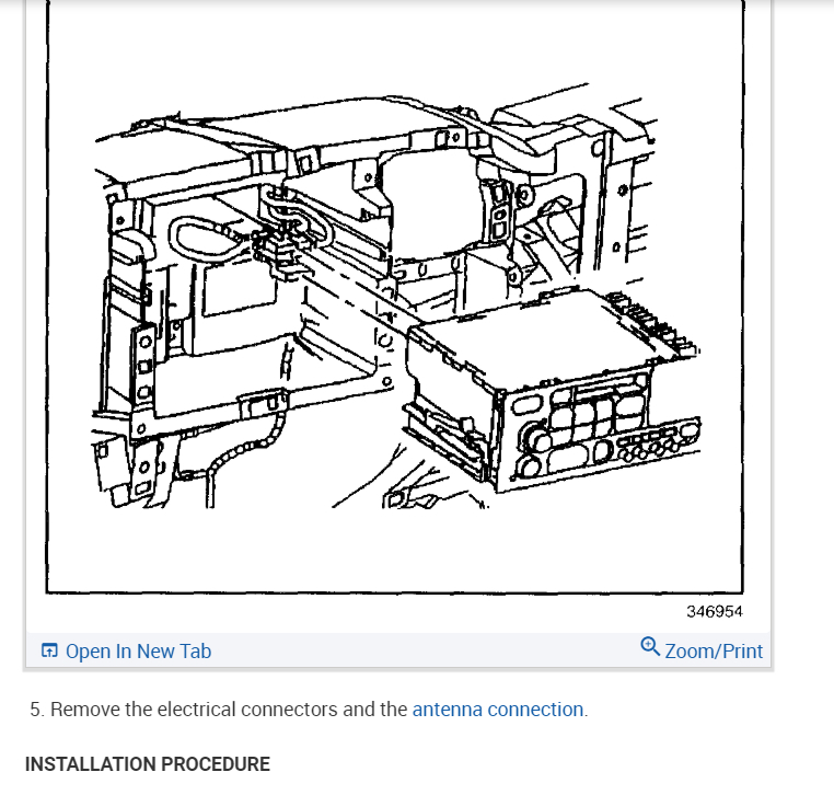

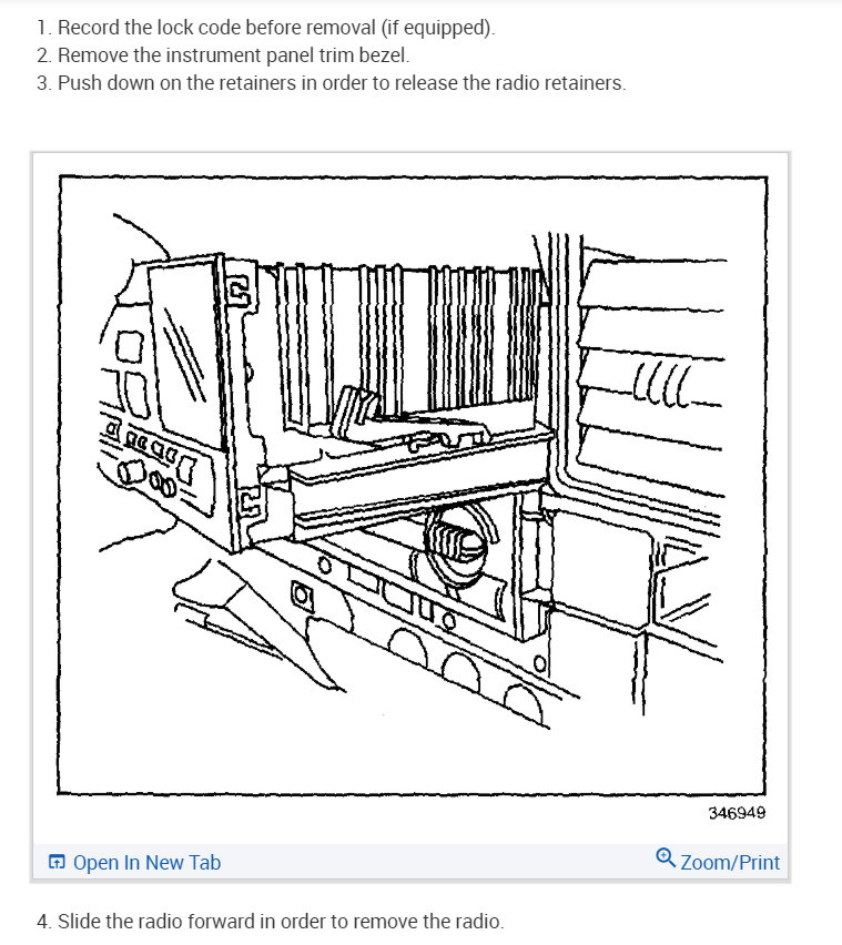

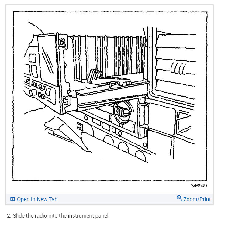

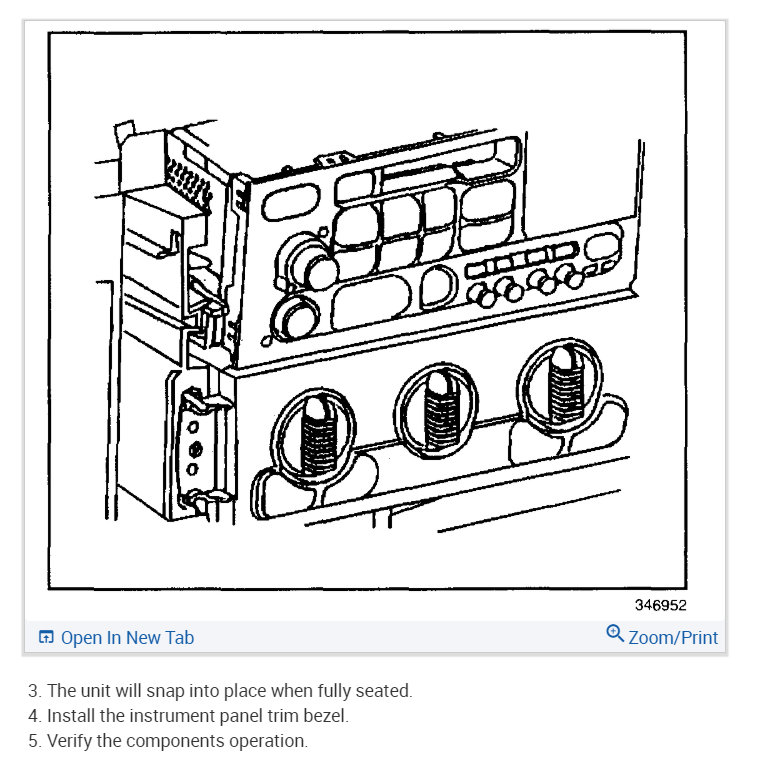

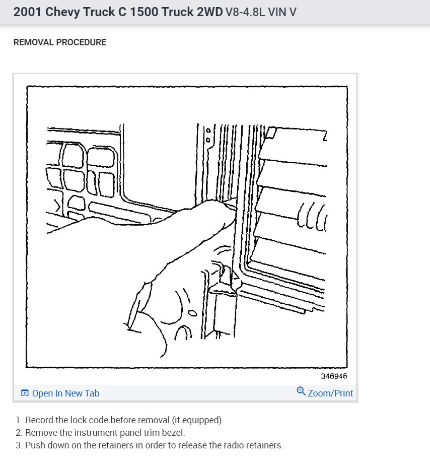

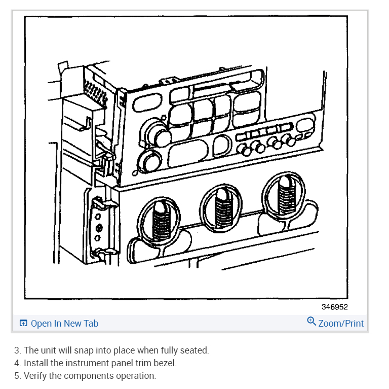

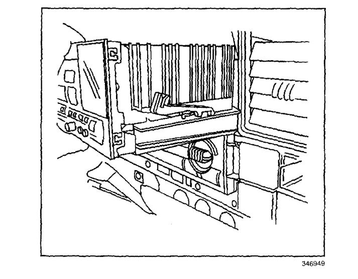

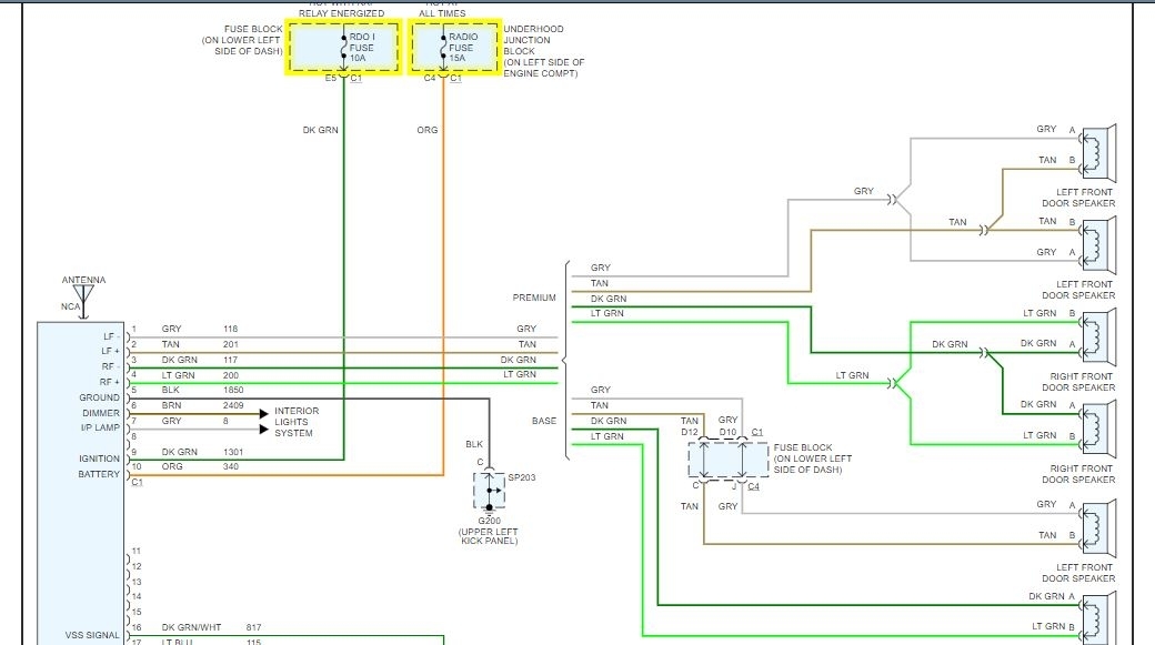

This sounds like a bad head unit which is common. You can replace it with a stock unit or install an aftermarket unit. Here is a video of the job being done on a similar car with instructions in the diagrams below to show you how on your car:
https://youtu.be/jF_sDSS0n7I

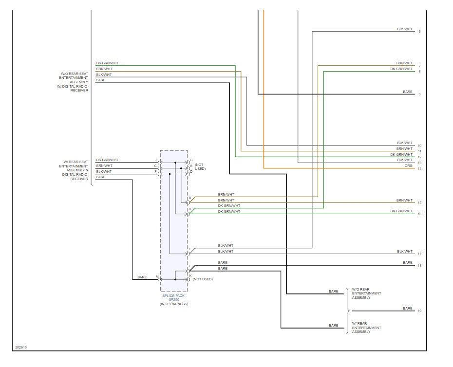

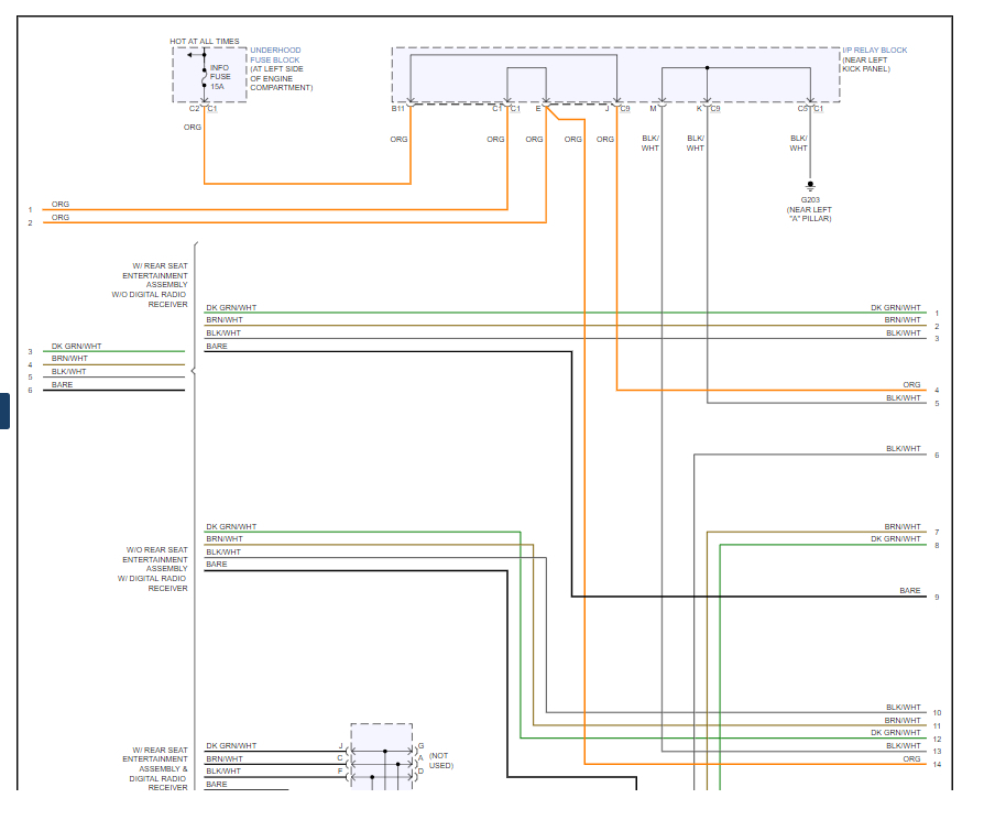

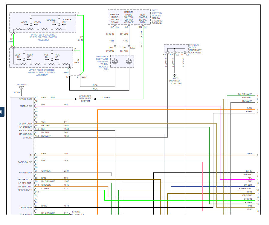

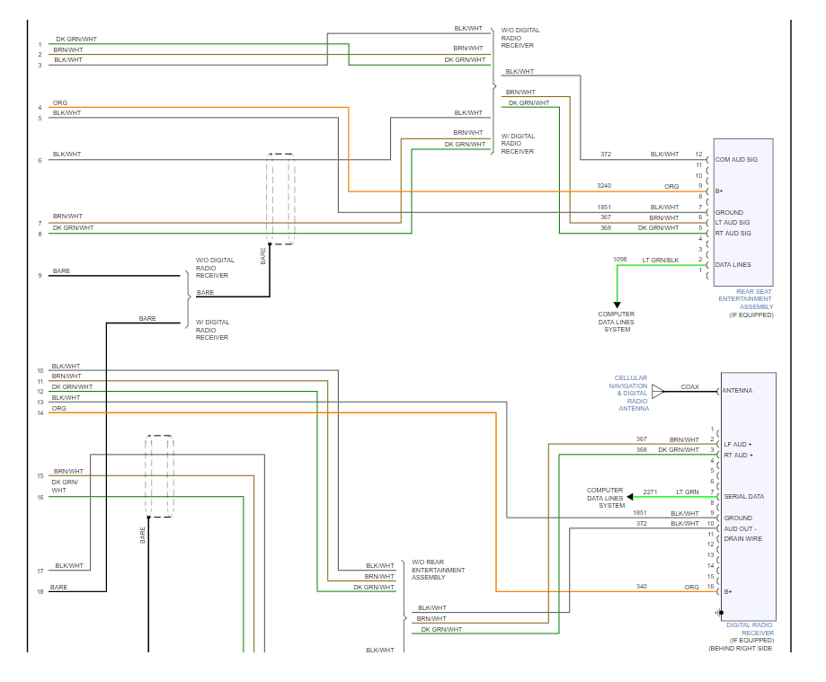

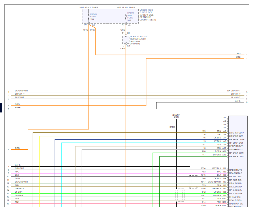

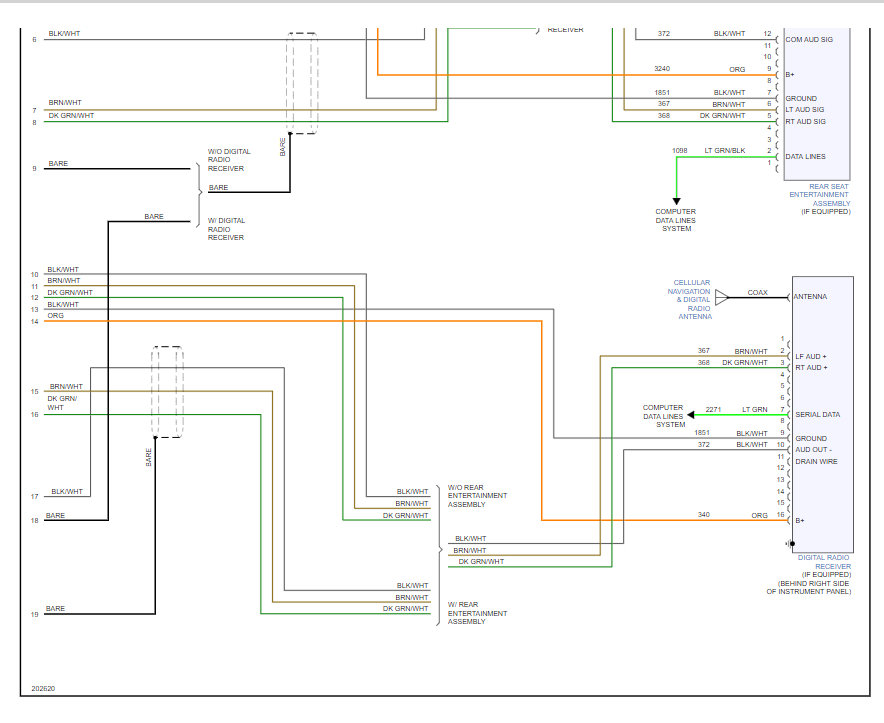

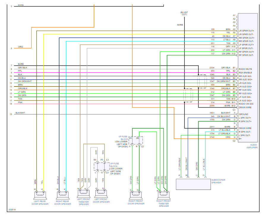

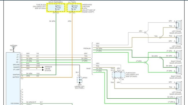

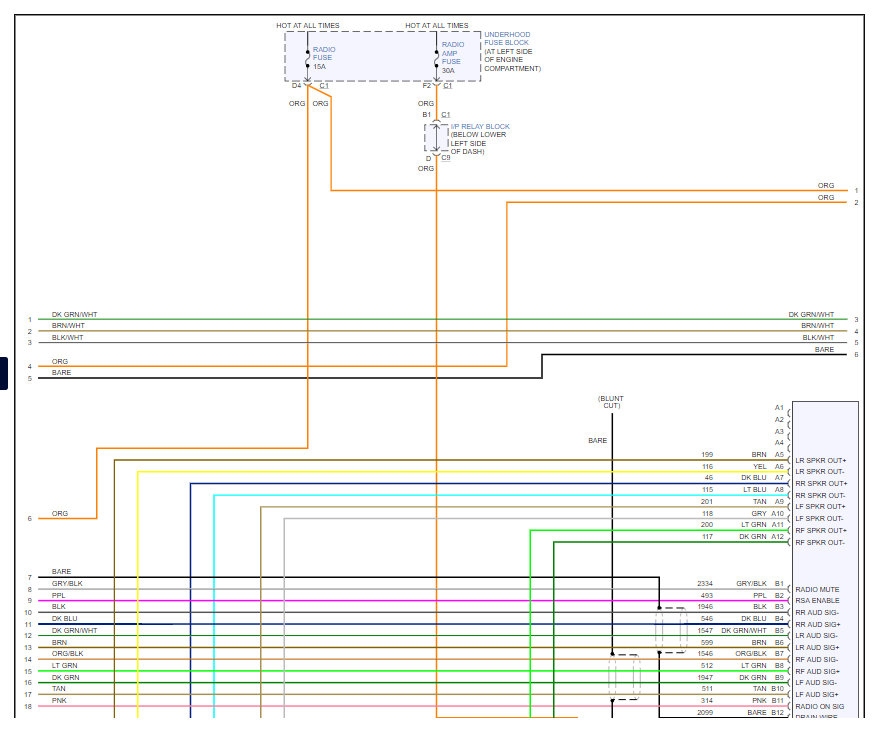

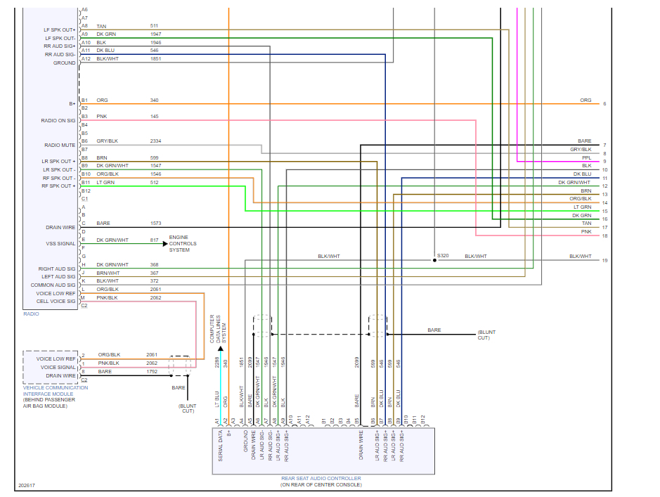

It sounds like you may have more wiring issues or a bad ground. here is guide to help you with the testing and the radio wiring diagrams below to show you which wires to test:
Apr 11, 2020 at 1:48 PM
