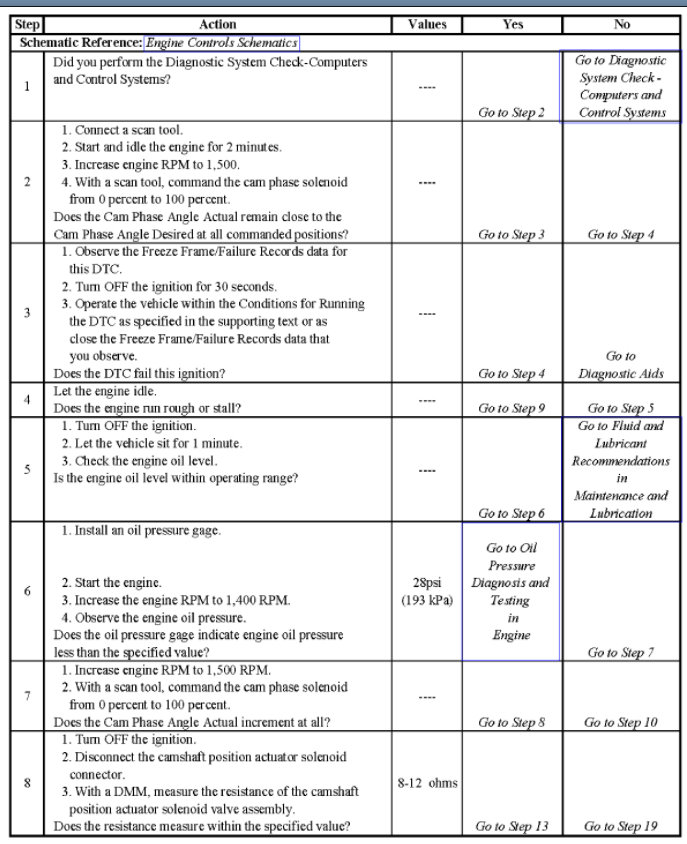

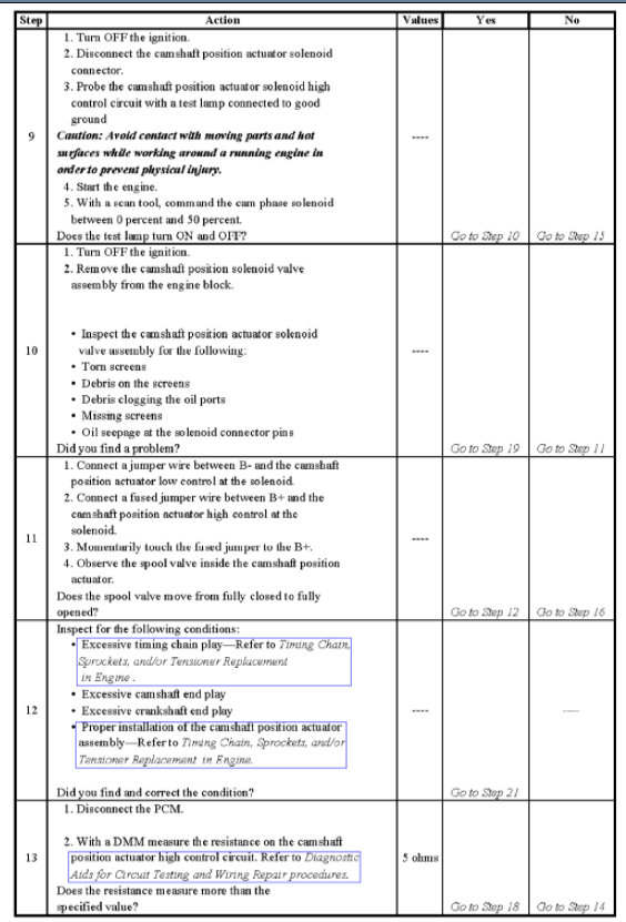

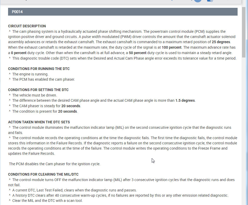

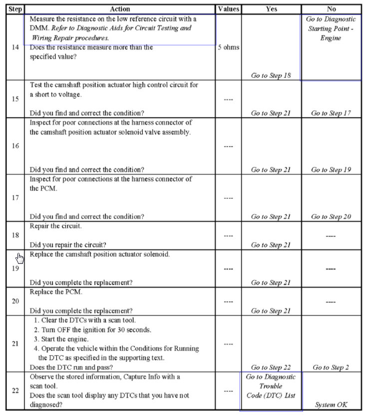

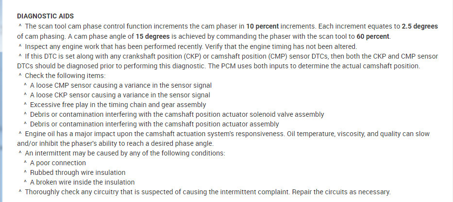

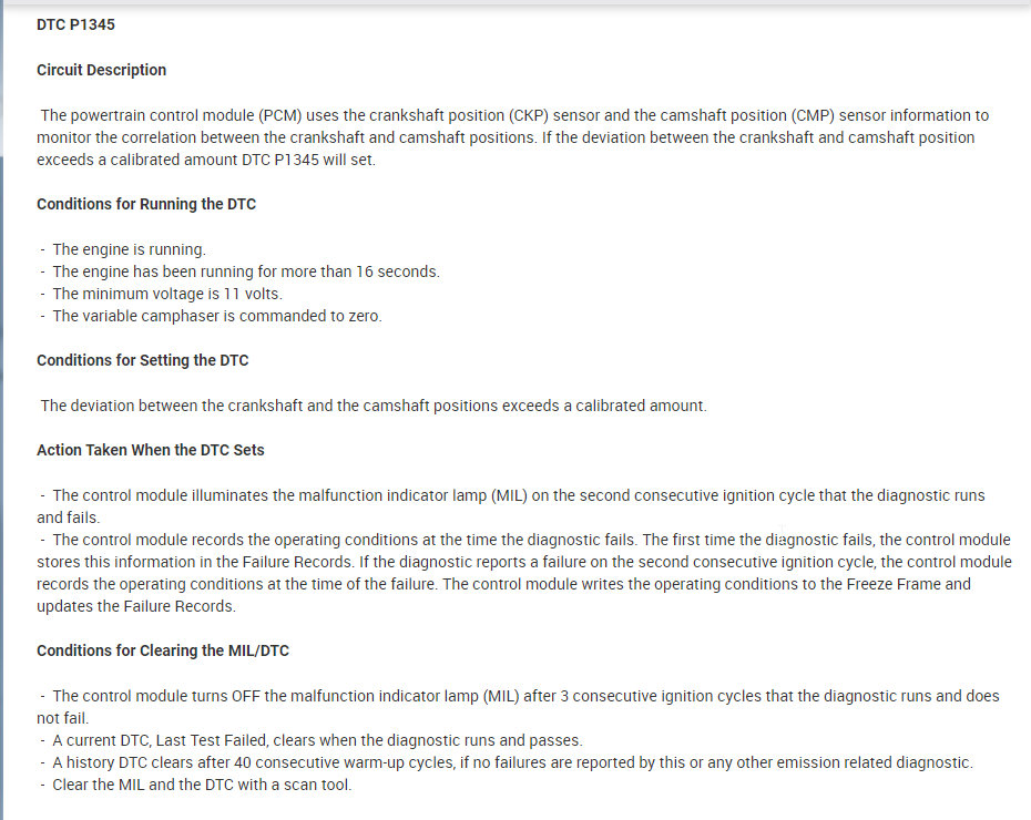

I am hoping that the low oil pressure light and these codes are not related. If they are then most likely you have metal floating around the engine oil system and it is getting caught in the phasers. However, let's run through this testing and see what we turn up.
Here are guides that cover all this material to help explain what you are testing:
https://www.2carpros.com/articles/how-camshaft-variable-valve-timing-works
https://www.2carpros.com/articles/high-or-low-engine-oil-pressure
Let us know what you find and we can go from there. Thanks
