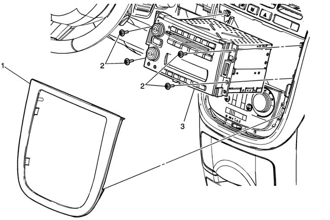

Need to remove factory installed radio from dashboard not sure where to begin. Need Help
Sep 4, 2008 at 1:46 PM

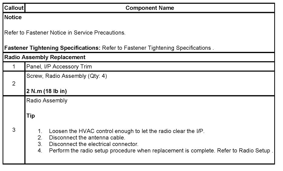

This is one of the easier ones, Just pop the bezel off and undo the mounting 4 screws and the radio will come out. Undo the wiring harness at the rear of the unit.
Here is a guide that will help you. (below)
