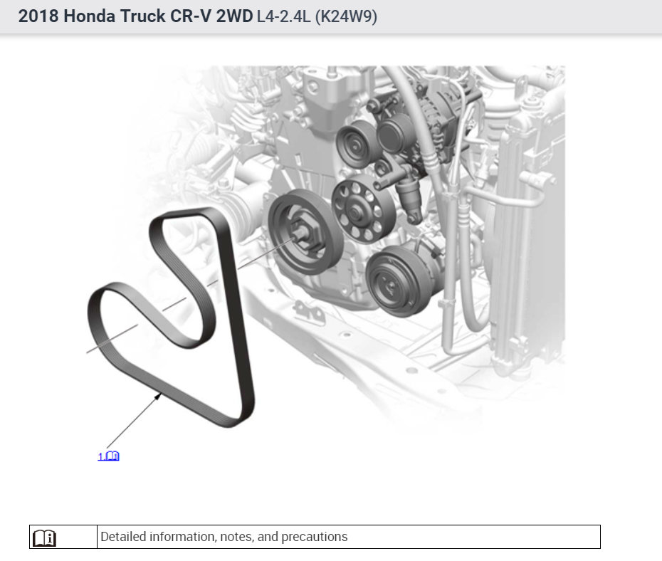

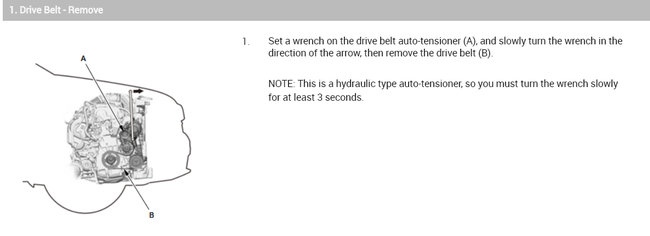

It sounds like you have a serpentine belt that is dry, but to be sure can you please shoot a quick video with your phone so we can hear the noise? that would be great. You can upload it here with your response. This guide will help walk you through changing the serpentine belt and diagrams below to show you how on your car:
