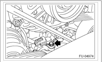

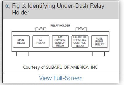

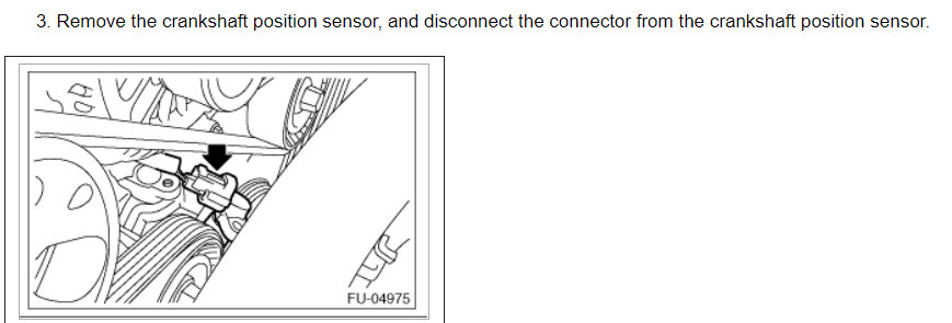

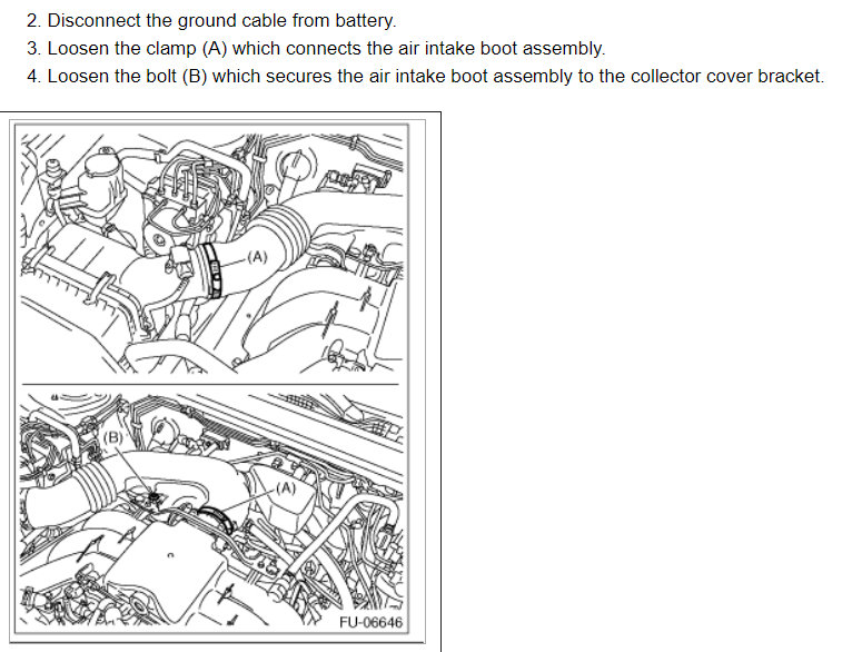

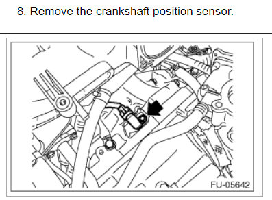

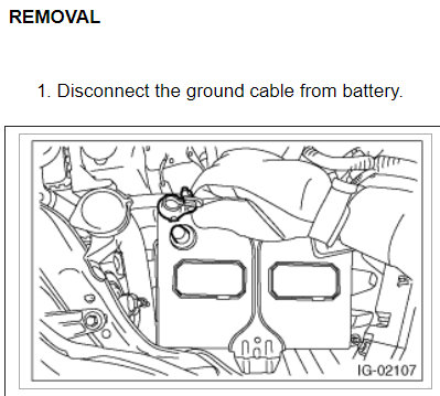

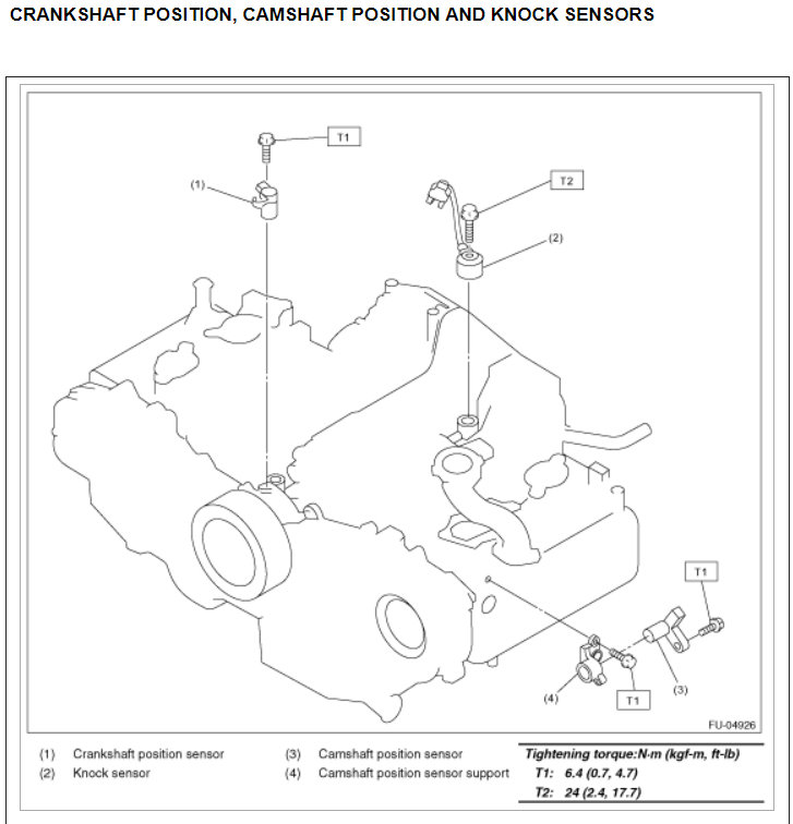

The fact that there are no codes is telling me it could be the crankshaft angle sensor or a IG relay is having a problem. If the crankshaft sensor is going out it will not set a code.

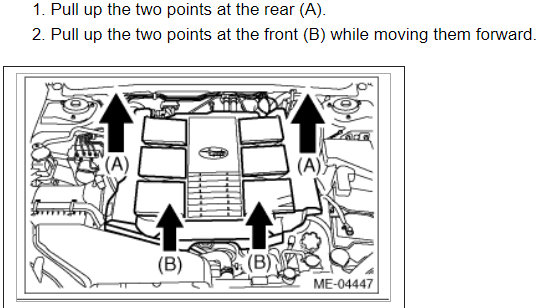

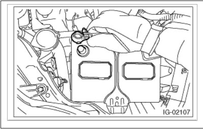

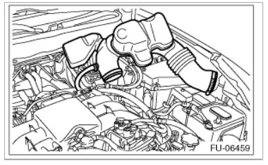

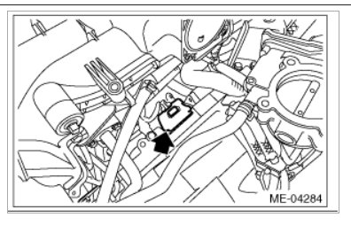

Here is a guide will show you what you are in for when doing the job:
Here is the location for your car for the crankshaft sensor (both engine just in case) and the main control relay which you can tell is going bad if it is warm or hot.
Check out the diagrams (below).
Apr 29, 2018 at 10:13 AM
Here is a guide to help you test the relay and the location:

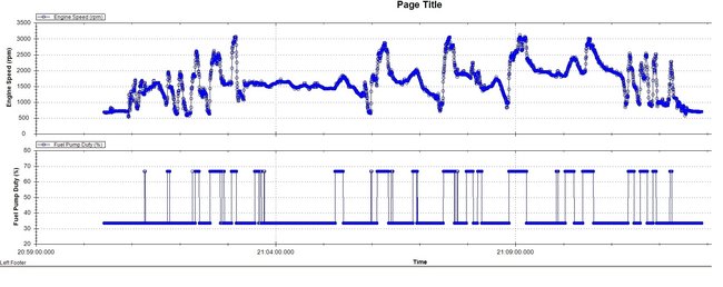

I have used RomRaider to log the running engine parameters, did that a few times, but it took me time and some online education to figure out what to do with them. Finally I have noticed that fuel pump duty never reaches 100%, no matter how hard I press the gas pedal. It looks like it is at 33% at idle, which seems normal, but as the load goes up, the fuel pump duty doesn't follow, so fuel pump does not deliver enough gas under load. It looks like this is very likely the cause of reduced torque, basically fuel starvation. I guess this explains why sometimes it hesitates on take off. Please see the graph attached to see how fuel pump behaves.
The max value I have recorded for fuel pump duty is 66.67%, that is probably not enough on higher load.The fuel pump duty and pulse modulation is controlled by ECU, my understanding is that it uses the MAF sensor(I have cleaned that, but was very clean already, and I have graphed the variation and I am pretty sure it is normal. The service manual does not specify what voltage should deliver, it only says to check that voltage varies with air delivered). There is also the MAP (Manifold Absolute Pressure) sensor that contributes to computing the input for fuel pump, but less important than MAF sensor. This one i could check by measuring the output voltage. Looked at the values received by ECU (only says pressure, not voltage) and seems normal. Show absolute pressure and differential, also records atmospheric pressure, the differential is negative and when adding them they match fine.
I think some parameter(s) cause the computer to give wrong input to fuel pump, but cannot seem to figure out which one. :-(

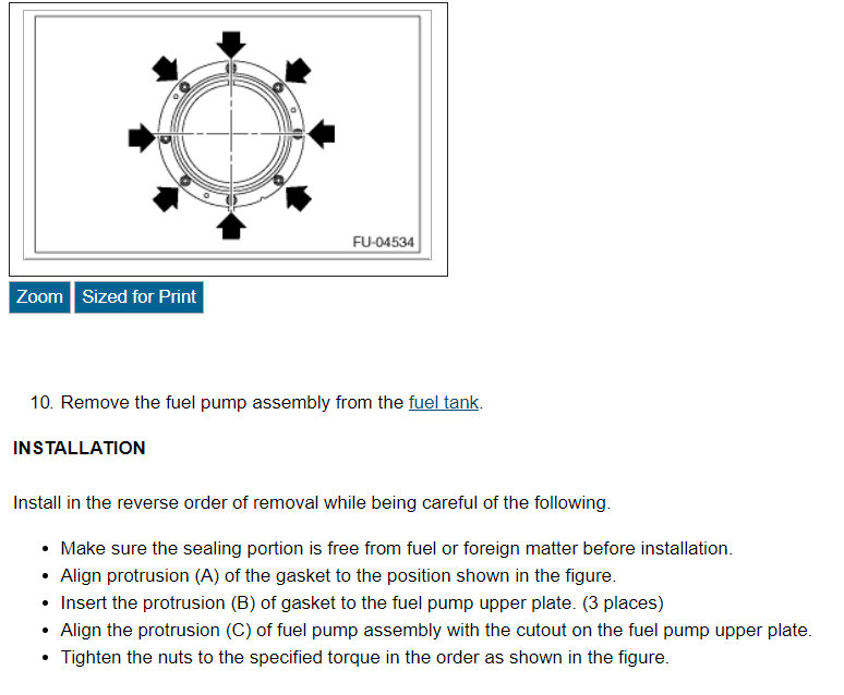

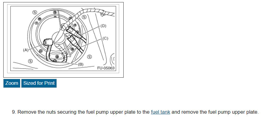

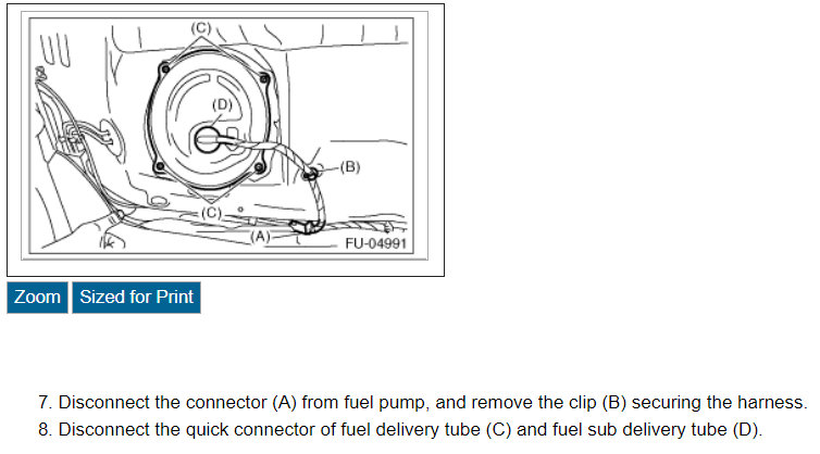

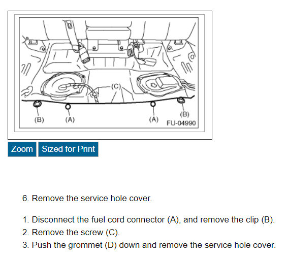

It does sounds like the fuel pump is weak causing the issue. Here is a guide and diagrams on how to change out the fuel pump:
You will not need to drop the tank because it has trap doors. Check out the diagrams (below). Please let us know what you find.
Jun 21, 2018 at 12:33 PM
