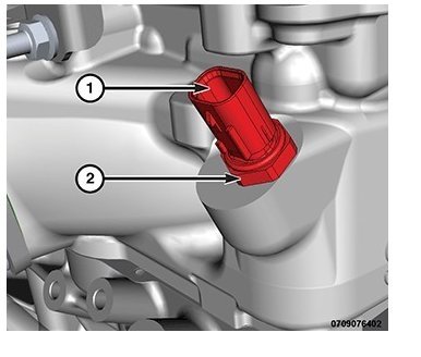

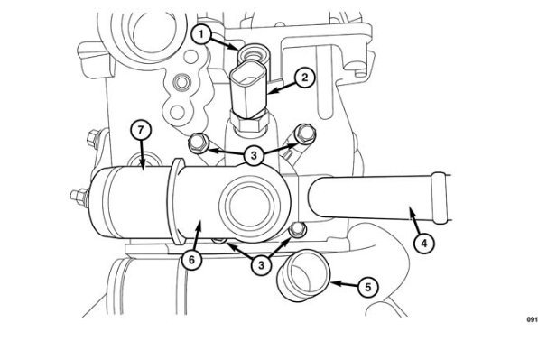

Location of the coolant/thermostat temperature sensor on a 200 model.
Jan 7, 2017 at 5:47 PM
Hi ASHLEY,
Here is a diagram for both engines 4 and 6 cylinders, also I have included a guide that will give you an idea on what you are in for when changing the sensor with diagrams below to show you on your car. The four cylinder is on the cylinder head by the intake manifold. while the v6 is on the thermostat housing.
https://www.2carpros.com/articles/coolant-temperature-sensor-cts-replacement
Here is what it will be like on your car (below) Please let me know if you need anything else to get the problem fixed.
