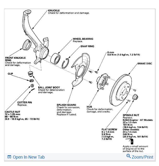

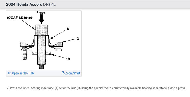

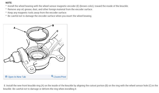

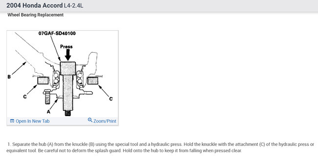

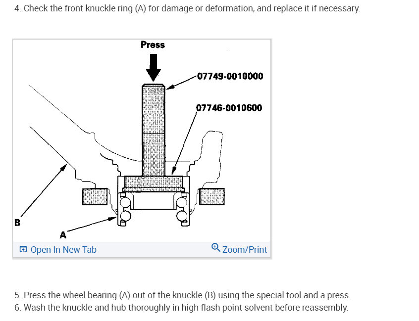

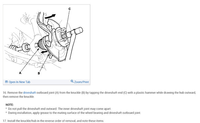

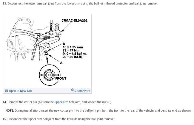

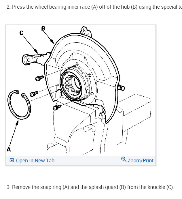

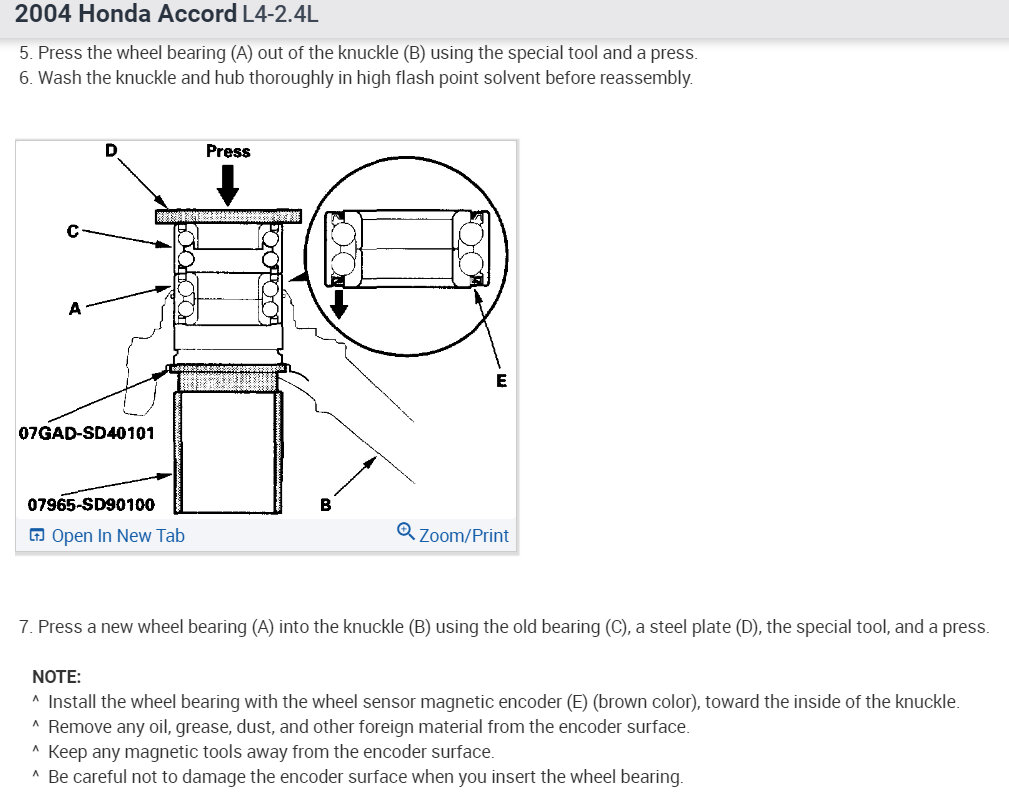

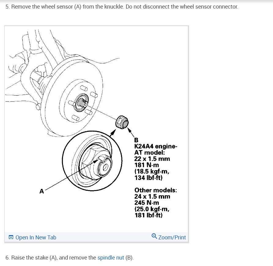

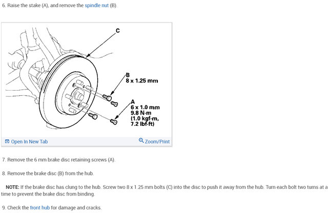

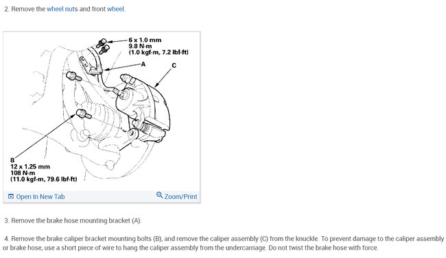

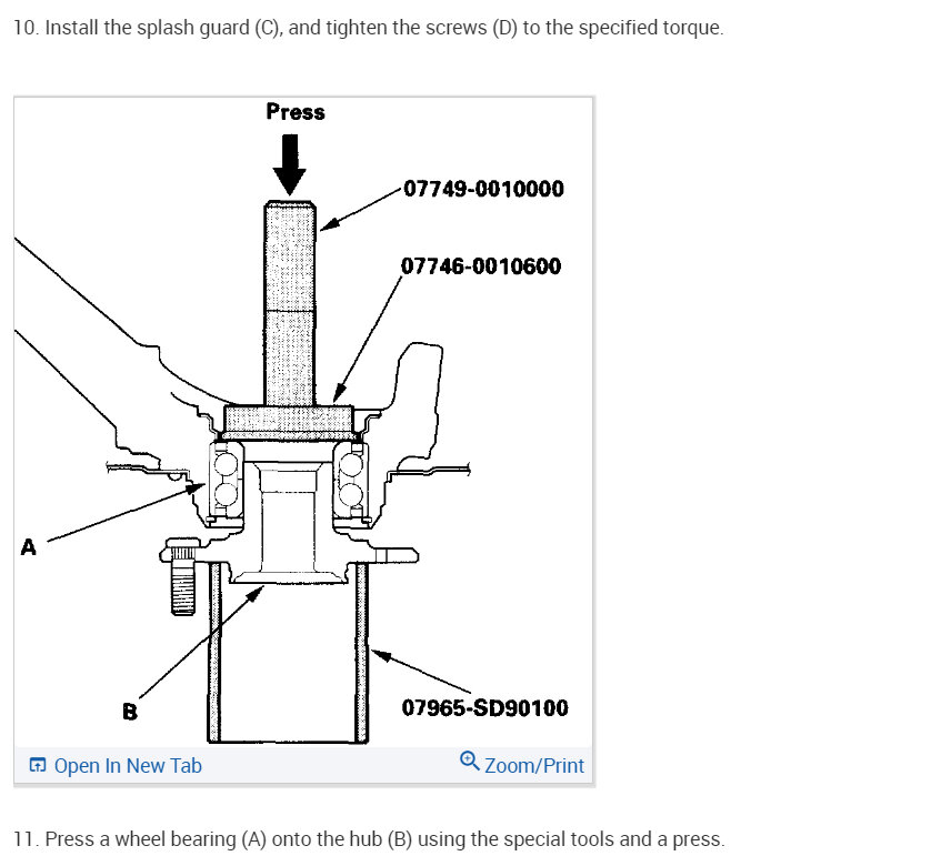

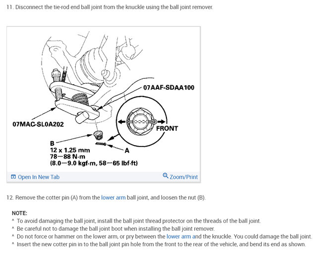

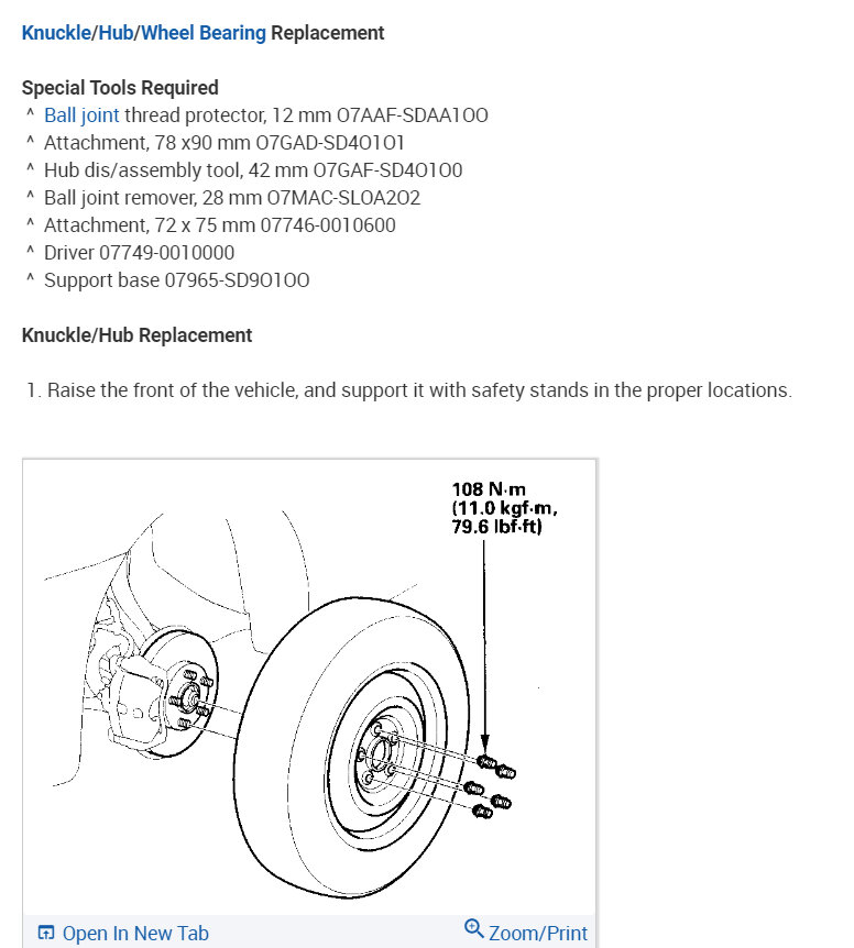

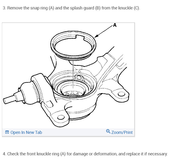

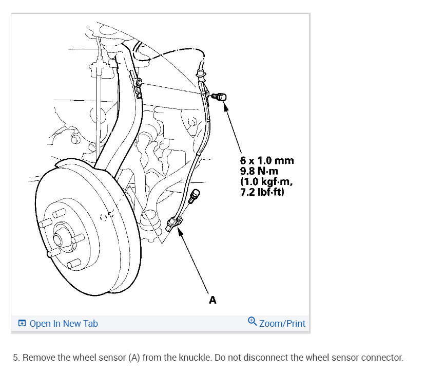

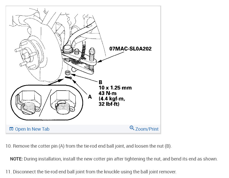

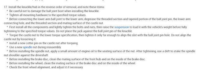

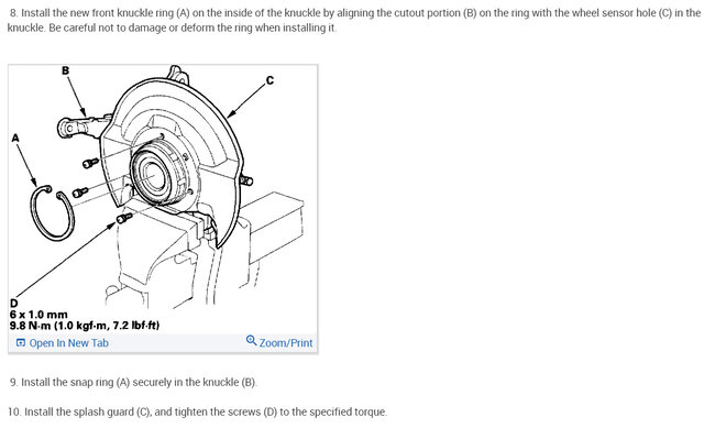

Yep, it sounds like the bearing hub needs to be replaced here are the instruction on how to do so, but to be sure can you please shoot a quick video with your phone so I can hear the noise? That way I can tell for sure what's going on. You can upload it here with your response.

Thank you so much you were right. I just fixed it the sound is gone.
