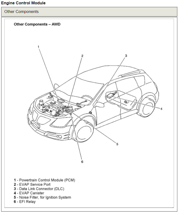

Here is the location.
Check out the diagrams (below).
