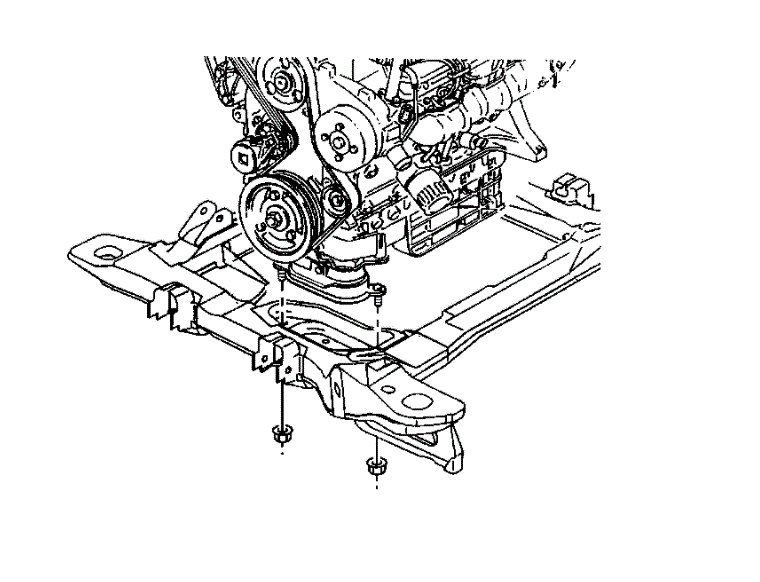

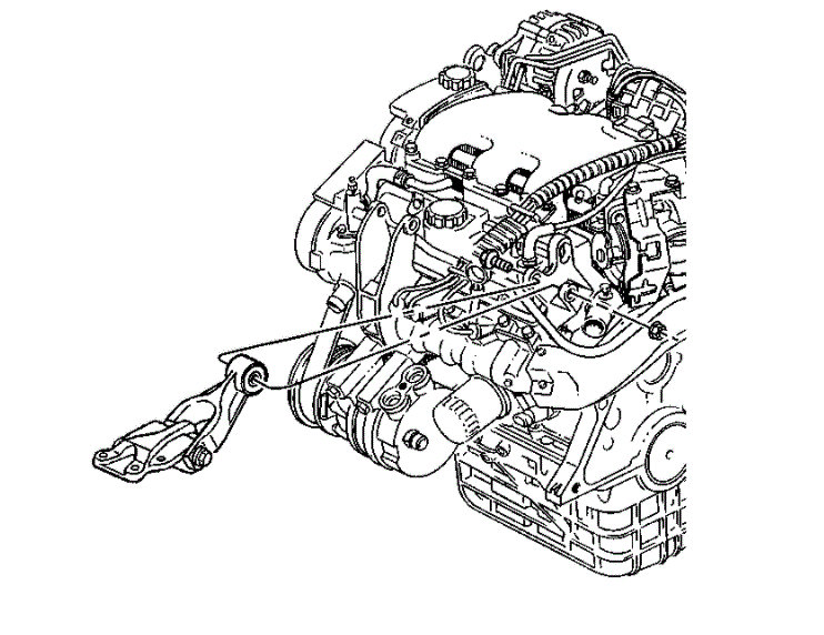

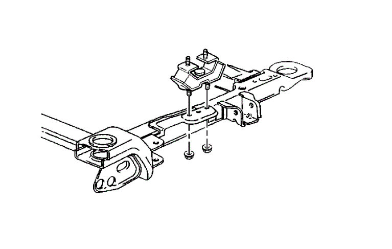

Thank you very much. How can I tell for sure if that's the real problem or not?
Oct 2, 2020 at 10:40 AM
CERTIFIED EXPERT
52,796 POSTS
You will need a second person in the car to put it in reverse with there foot on the brake and parking brake set and give it gas. The motor will likely move and you need to see which mount is allowing the movement.
