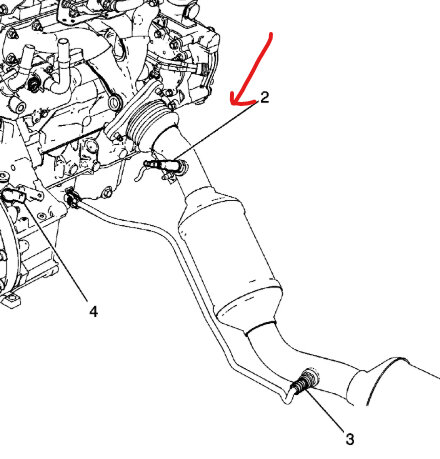

I need a picture or diagram for the upstream and downstream and or pictures for a 2010 chevy cobalt 2.2 Ls 2 door standard/manual
I think I'm missing something. Also what's good references for diagrams so I can easily find stuff on my own for stuff like this happens

The upstream oxygen sensor is located in front of the catalytic converter. Change the sensor with the engine cold, also spray WD40 on the sensor threads/base and let it sit for awhile which can help in the removal/installation. Here is a guide to help you change it and the exact location in the images below.
https://www.2carpros.com/articles/how-to-replace-an-oxygen-sensor

See. I thought it was closer to the engine under a heat shield that's what 1 machanic led me to believe. But I origally thought what this image here is showing so yeah wow

Well is there any chance it'd actually be located under a heat shield closer to the engine? I found the connecter just not the upstream thing
Jan 12, 2026 at 3:38 PM
Yes, you see the location of the sensor and if there is a heatshield it will be under it.
